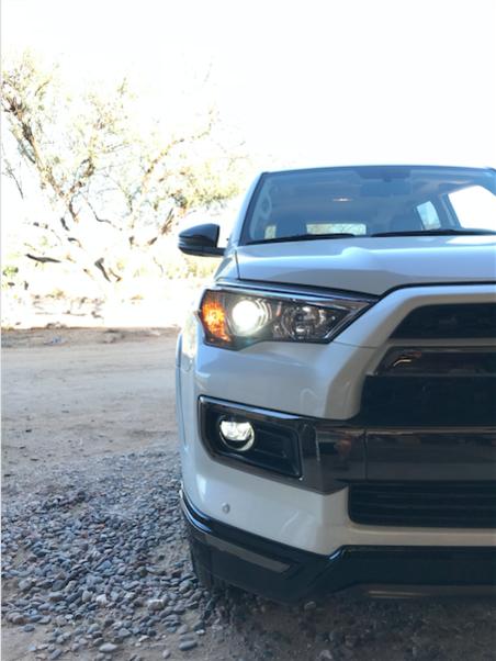

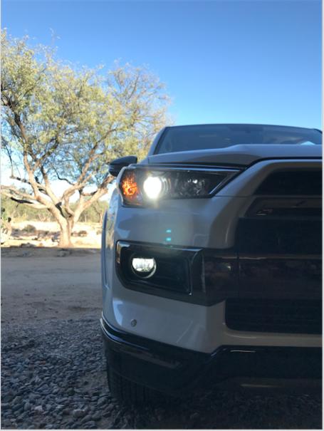

I just replaced the stock bulbs with a a pair of Phillips X-tremeVision LED bulbs. Huge difference over the stock halogen bulbs and no modding needed. They are good enough that I wouldn't change anything unless I was going to switch to Rigid or Baja Design LED assemblies.

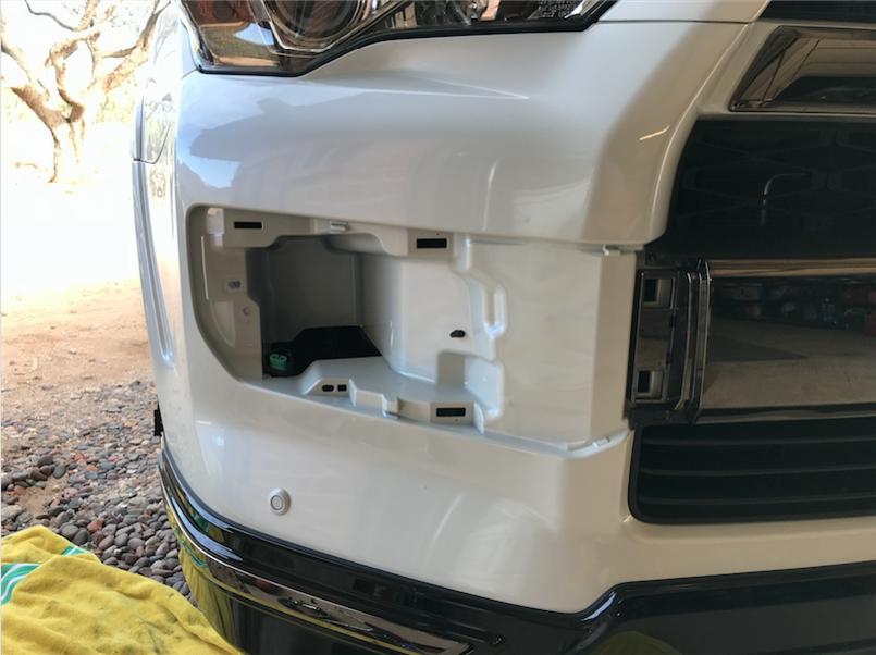

I just installed these. What a pain!! I had to go through the wheel well, loosen the fender liners, remove plastic pins, a screw and unhook the fog lights, then open the hood, remove the radiator cover, reach inside to remove the other pins that hold the fog light housing in place. Once the housing was out it took 3 minutes to install the LED fogs. The beam matched perfectly with the halogen beams so I didn't have to re-aim them. I'll see how they look at night with my Morimoto 2Stroke 2.0 low beams. The whole project took 3 hours. What an awful design. I tried to take photos of the whole process but it was such a tight area that I wasn't able to. The only one I took was of the front bumper after the fog light housing was removed.

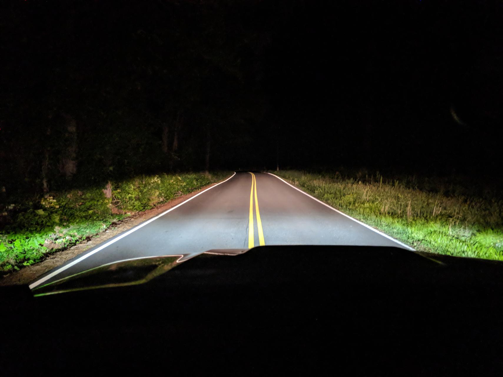

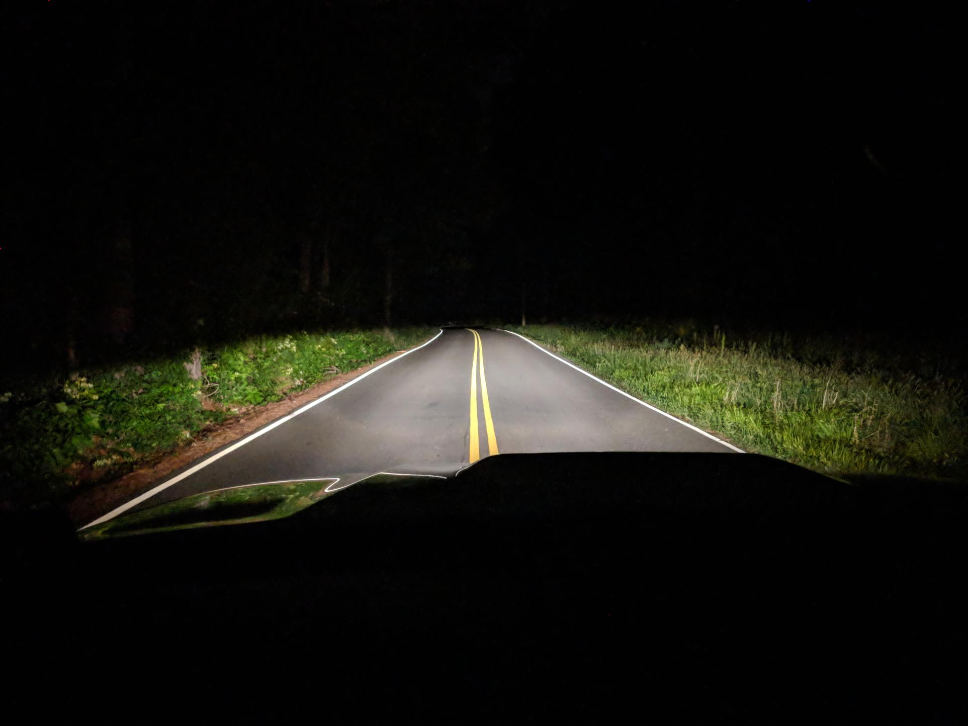

These are purely an "upgrade" just for the sake of having LEDs. 1) I am upgrading the headlights to 5500K and these pair well. 2) These are not a performance offroad light. They are a nice and easy upgrade if you're looking for white light and don't want/need the super bright and wide beam pattern of aftermarket lights. I'm not knocking the other applications. This works for how I currently use my vehicle.
What headlight bulbs are you running? In the night pictures you posted, it looks like you're running something besides stock halogens.
