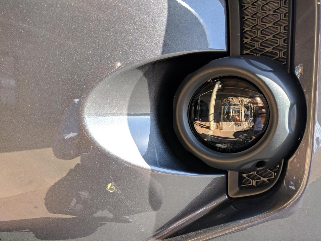

did the same black fogs part#PT41342191. bought from my parts dept... instant gratification :doh:

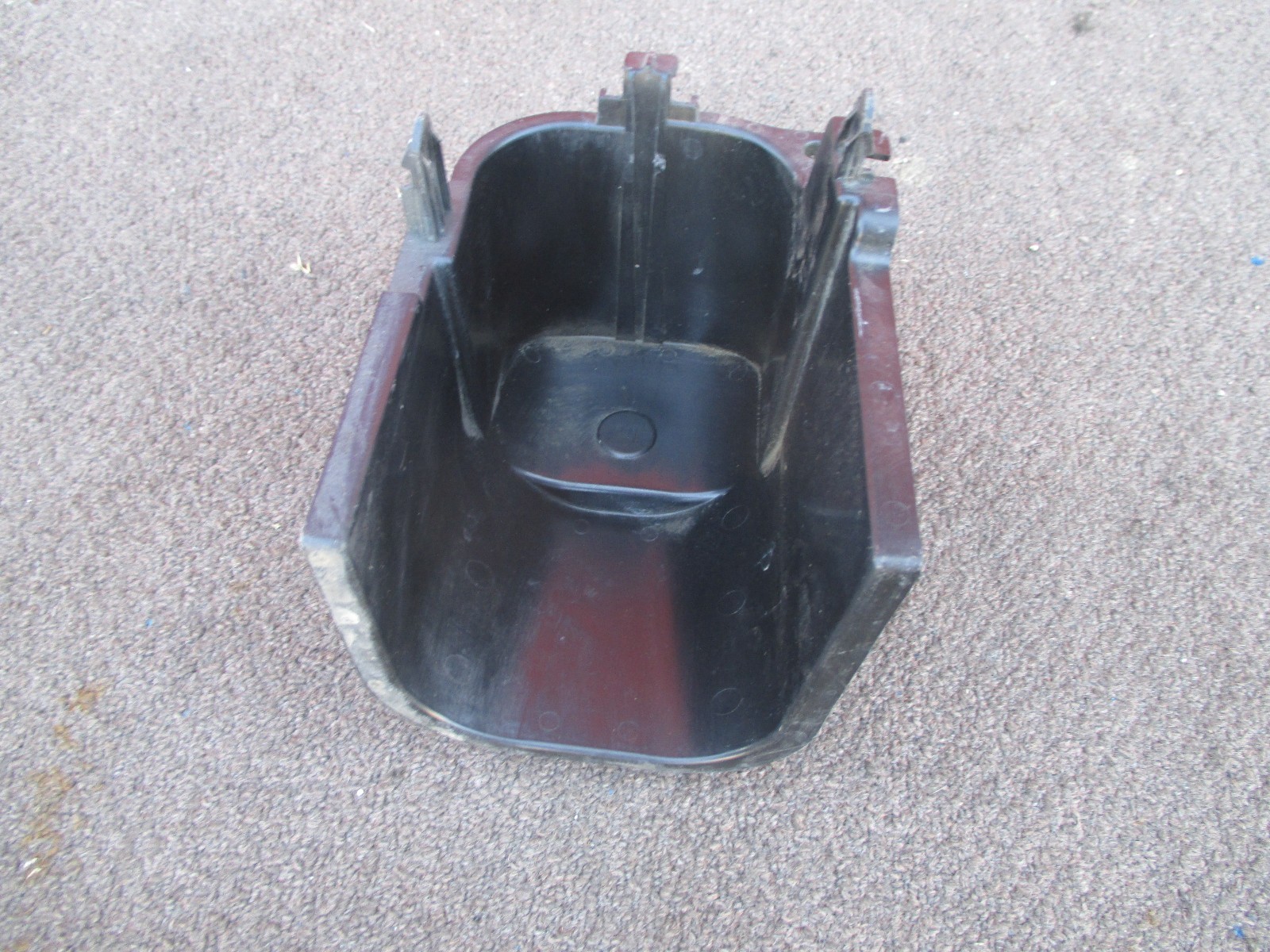

Just take your time, I was able to do mine from underneath. As for the right side (passenger), there is an extra plastic piece behind the fog light restricting access. If you are lazy like me, look at the picture and you should be able to release the tabs by feel if need be.
Bumping this thread because I finally bought a set of the PT series on EBay from the Toyota Of Miami dealers.
SClui, thanks so much for posting the picture of the shroud. It saved me a lot of fussing around and wasted time. Drivers side was easy to install and showed me how to handle the two screws. For the passenger side I only needed to remove two screws on the fender liner and remove the shroud in the picture before a quick swap of the new assembly for the old.
