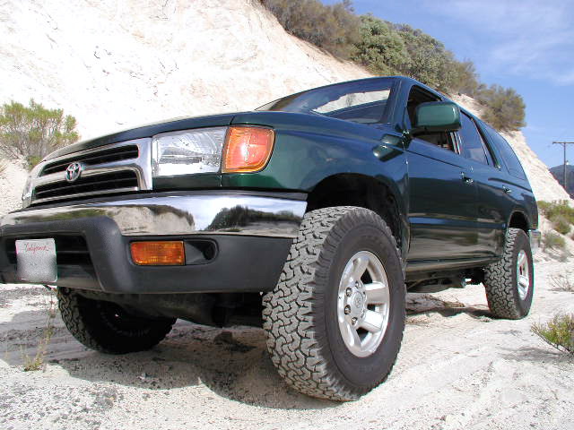

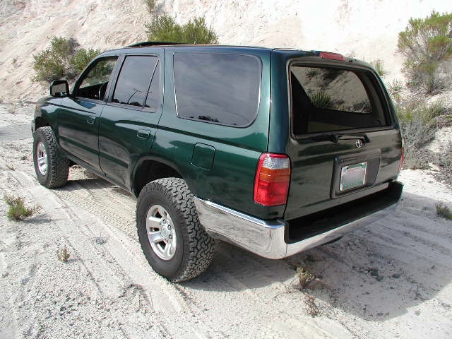

here's a pic of what it looks like....just a blown up picture of my avatar...wish I had a before picture but i don't.

Hey Ron, looks that stoner's trim shine works really well. My trim looked a lot worse than yours did though. It just looked hideous.
I just took my chances with the paint, not knowing how it was going to turn out. I had nothing to lose since I was about to by a new replacement anyways. i thought it was just going to be a temporary fix, but it turned out to be a nice permanent solution.
