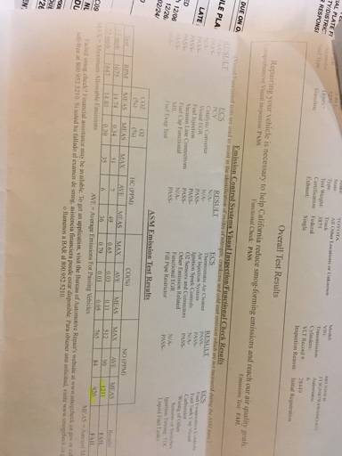

Hey so I have a 1998 3.4l 4runner I just tried to smog and it failed for HC and NOx being high.
The tech said I have a weak cat, I’ve read I could do seafoam and it probably would fix the issue, but not sure. What does anyone here think? Injector cleaner and seafoam? For sure a cat? O2 sensor?
No engine codes at all

I used to get cat problems right around smog time with my 2000. I used a bottle of Cataclean and that seemed to do the trick. YMMV.
https://www.amazon.com/Cataclean-12..._1_3?keywords=cataclean&qid=1573618468&sr=8-3
Cats are expensive. And almost every smog tech will tell you to replace it if you fail. It COULD be bad. But unlikely. I would spend money on some easy stuff like front 02 sensor and cleaning MAF sensor. If those sensors skew, you're gonna have falsified rich/lean conditions which affects all that. I don't have much experience in smog diag, but I do know 4Runner (or really Toyota) cars failing are rare. Normally something takes them out vs just dying. But 21 years is a long time.
I know a place in garden grove that will pass you for $175. May be a cheaper solution until you can get the problem fixed.
My 97 was 1 level away from failing. (I failed because of tape on a vacuum hose) I took it back the second time and I ran some of the lucus oil cleaner thats suppose to lower emissions and it didnt do a damn thing.
I’ve cleaned the MAF before smogging. I haven’t changed any o2 sensors...I looked at real-time on them in my scanner, and both function.
History of the vehicle:
Got it from Houston with a supercharger on it, took that off for my other 97 that is my keeper, swaped Intake and supercharger, Once I smog this and register in California, I’ll be selling it.
It was grossly neglected as well, which I’ve brought the maintenance current. The cat looks to be replaced already at one point in its history. Could major carbon buildup in the cylinders cause these problems? Maybe there was additional buildup from the blower before?
Carbon build up will contribute to higher nox. How are your fuel trims? A lean mixture will also have higher nox. I’ve heard of people mixing in a bottle of rubbing alcohol in their fuel tank to pass smog. The only way the vehicle has to reduce nox is the cat converter. Your vehicle doesn’t have egr does it.
Ill pull the fuel trims, not sure what they are right now. No, 3.4l 4runners do not have EGR.
Adding rubbing alcohol to the fuel will reduce Nox?
