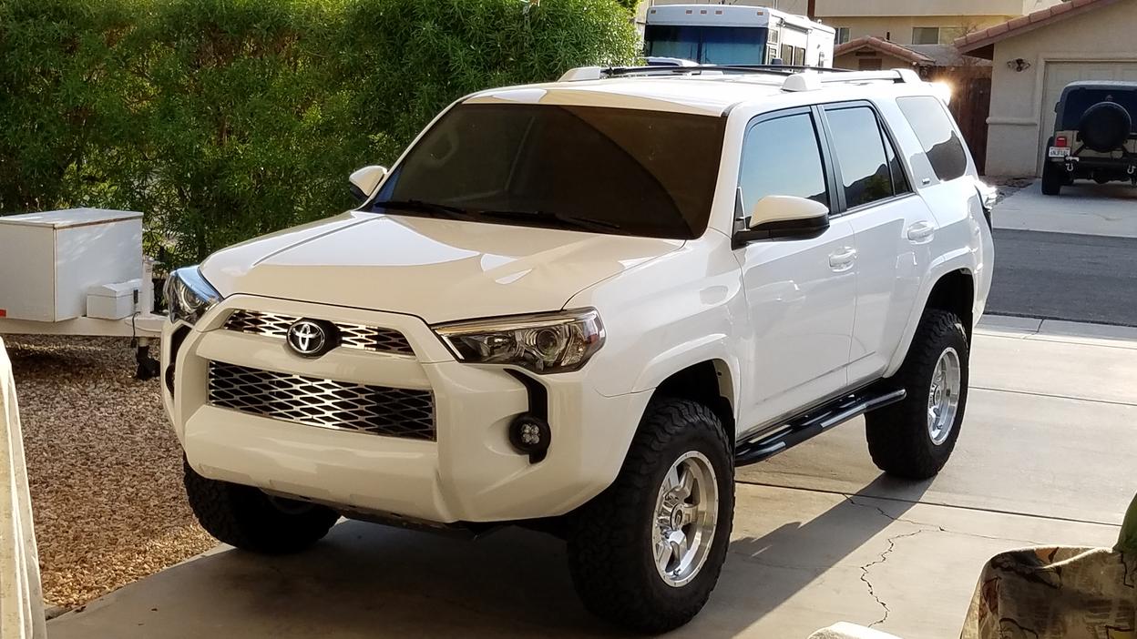

I got the best offset available for the rims I had to have and still had the ''Ford Exploder'' look going on....where the rear track is silly-narrow looking. Spacers fixed it and the track width adds stability! http://www.toyota-4runner.org/attachment.php?attachmentid=311404&stc=1&d=1536702653 Nobody will touch the truck but Me and I'm very methodical and picky so I don't sweat the spacers if installed properly.
