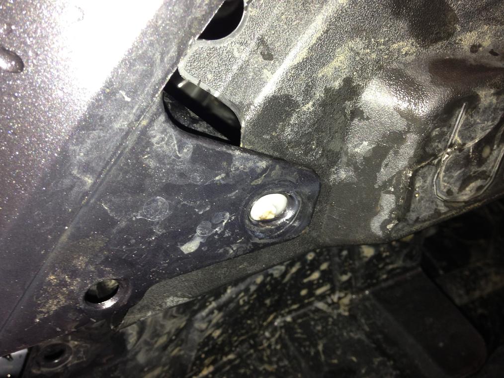

I'm under my truck right now trying to figure out the picture but for the life of me can't figure out the orientation. I have a '13 SR5.
Is the far left the actual wheel well and the far right where it turns into bumper?

If the wheel well is indeed to the left in the picture, the underside in this orientation on my '13 SR5 looks very different. Anyone else with a '13 able to chime in?
So I'm under my truck right now and still can't figure out this little fender liner mod ('13 SR5). There's a bulbous part directly behind where the fastener mounts the fender lining to the bumper, which prevents me from drilling a new hole and moving the fender forward to give me more tire clearance. Thoughts?
I'll try to post a pic here in a sec.
Here's the pic. In the pic view the bulbous part is to the right of the fastener. Other fender mod pics don't seem to have this part swell out like mine.
