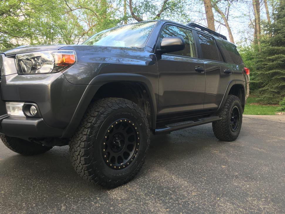

Even with a 3 inch lift my 285 T/A KO2s rubbed a tiny bit in reverse when a attempting a full turn. This remedied the problem. Thanks [MENTION=8206]harper7[/MENTION]
