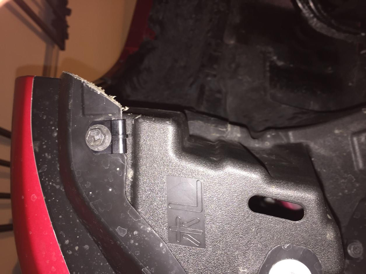

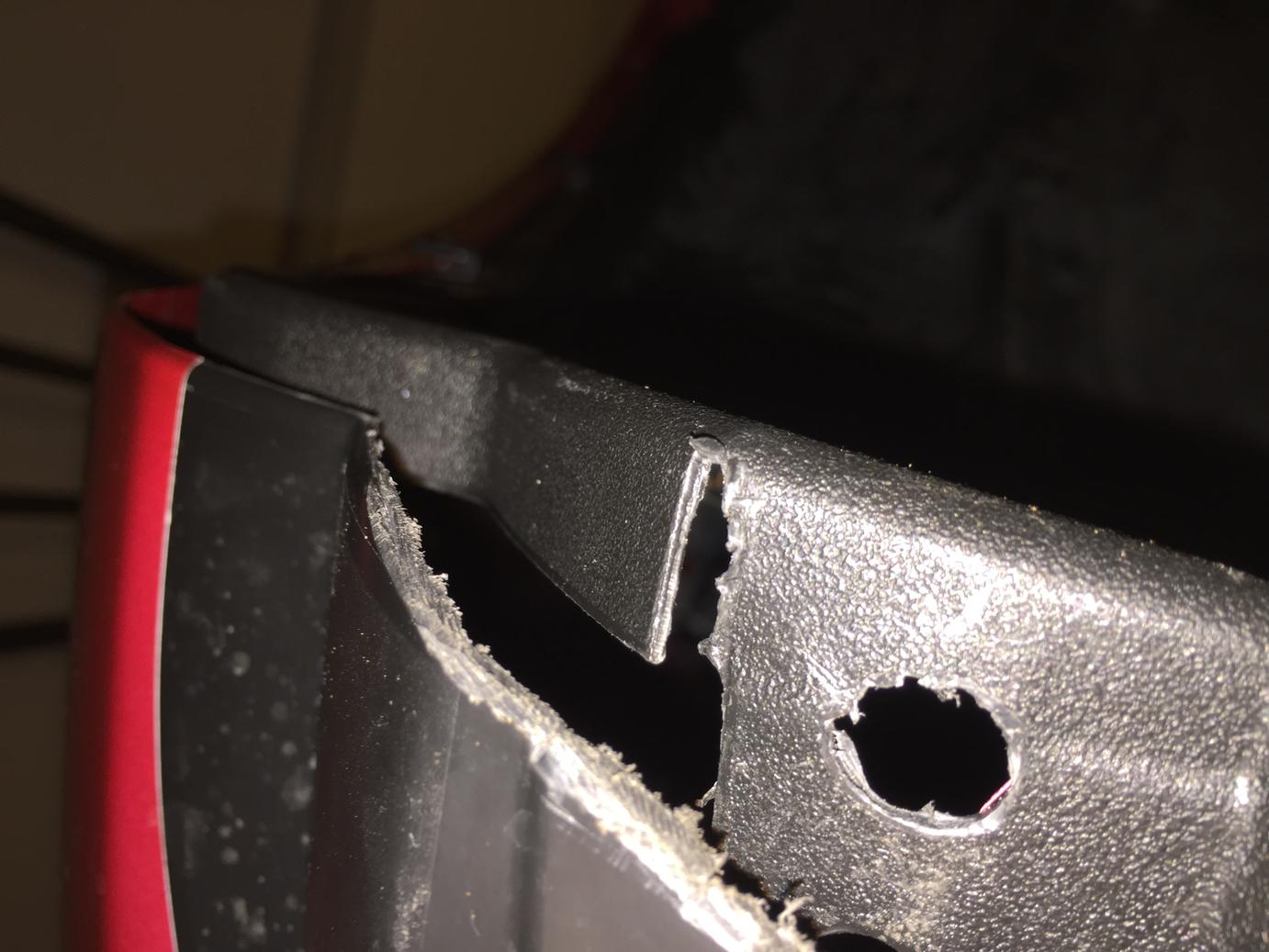

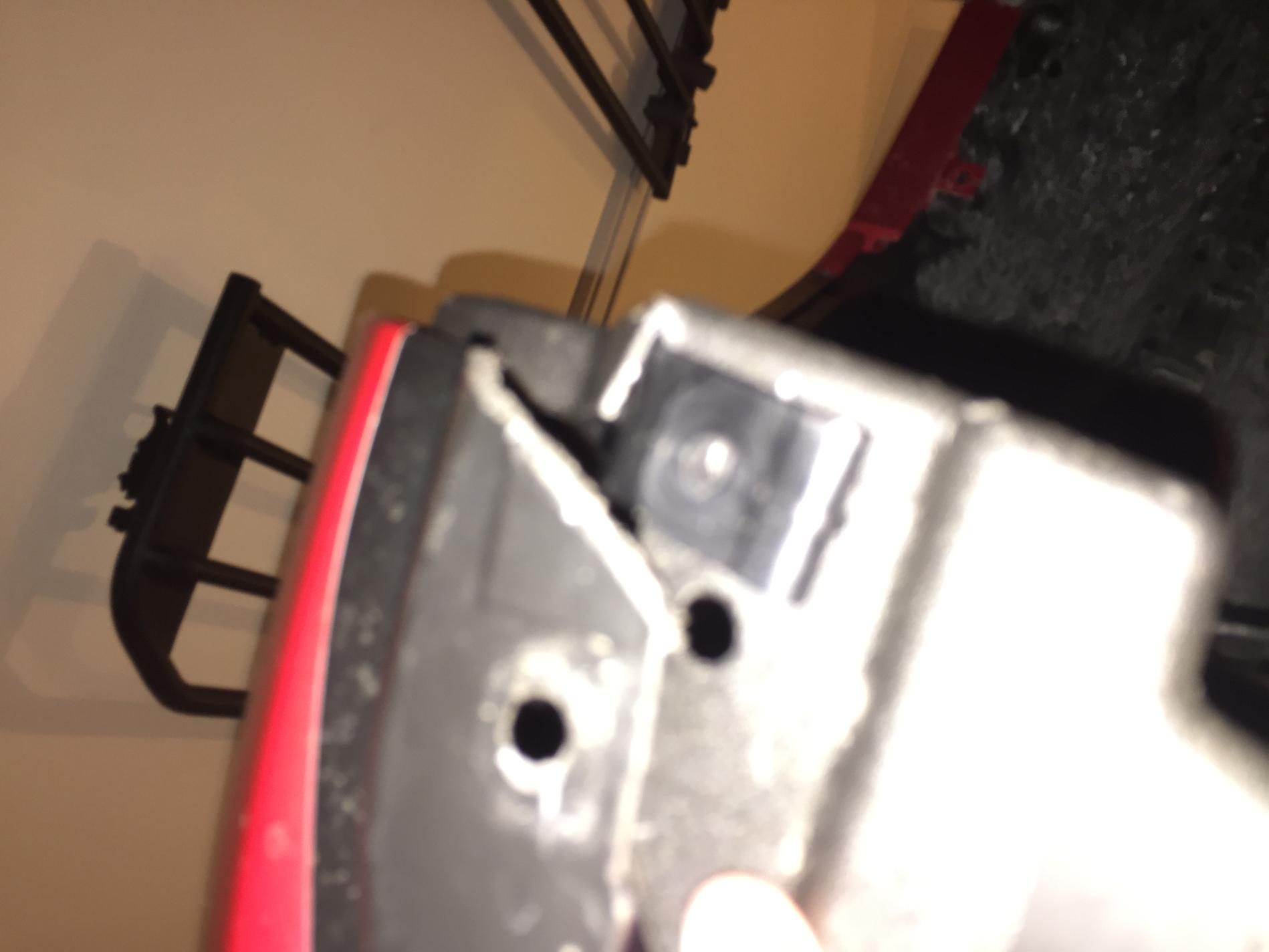

I was working under my 2016 Limited to allieve some rubbing issues and noticed the liners are a bit different than the tried and true methods. So i took a slight different approach with the outer clip. This still have me a solid inch of movement. These pics were after i trimmed the outer corner a bit.
I cut a slit closer to the tire are to allow the plastic clip to slide into. Otherwise there's only about 1/2 inch to gain. This means you have to reposition how the clip attaches to the other liner. You can also see my crudely drilled hole.
The second pic shows the clip in its new position (@%1; style). The new hole isnt quite lined up in this shot because... i suck at taking pictures upside down.
Third pic shows it all buttoned up.

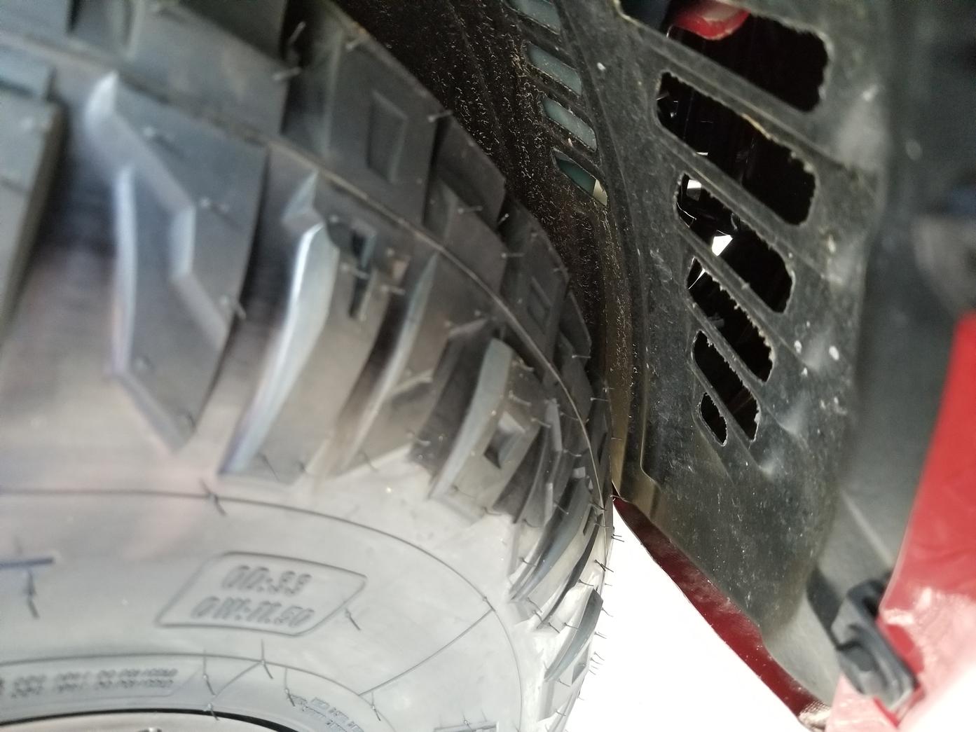

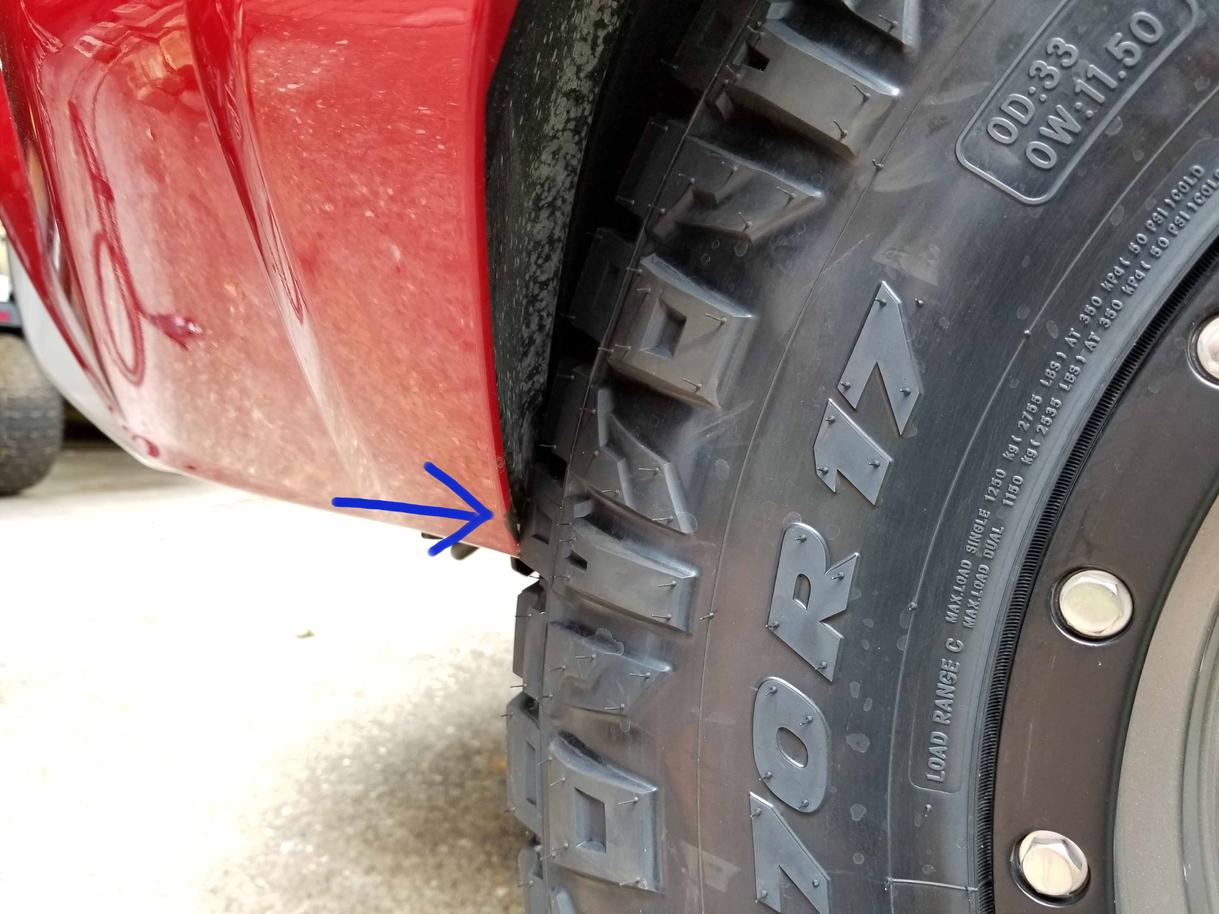

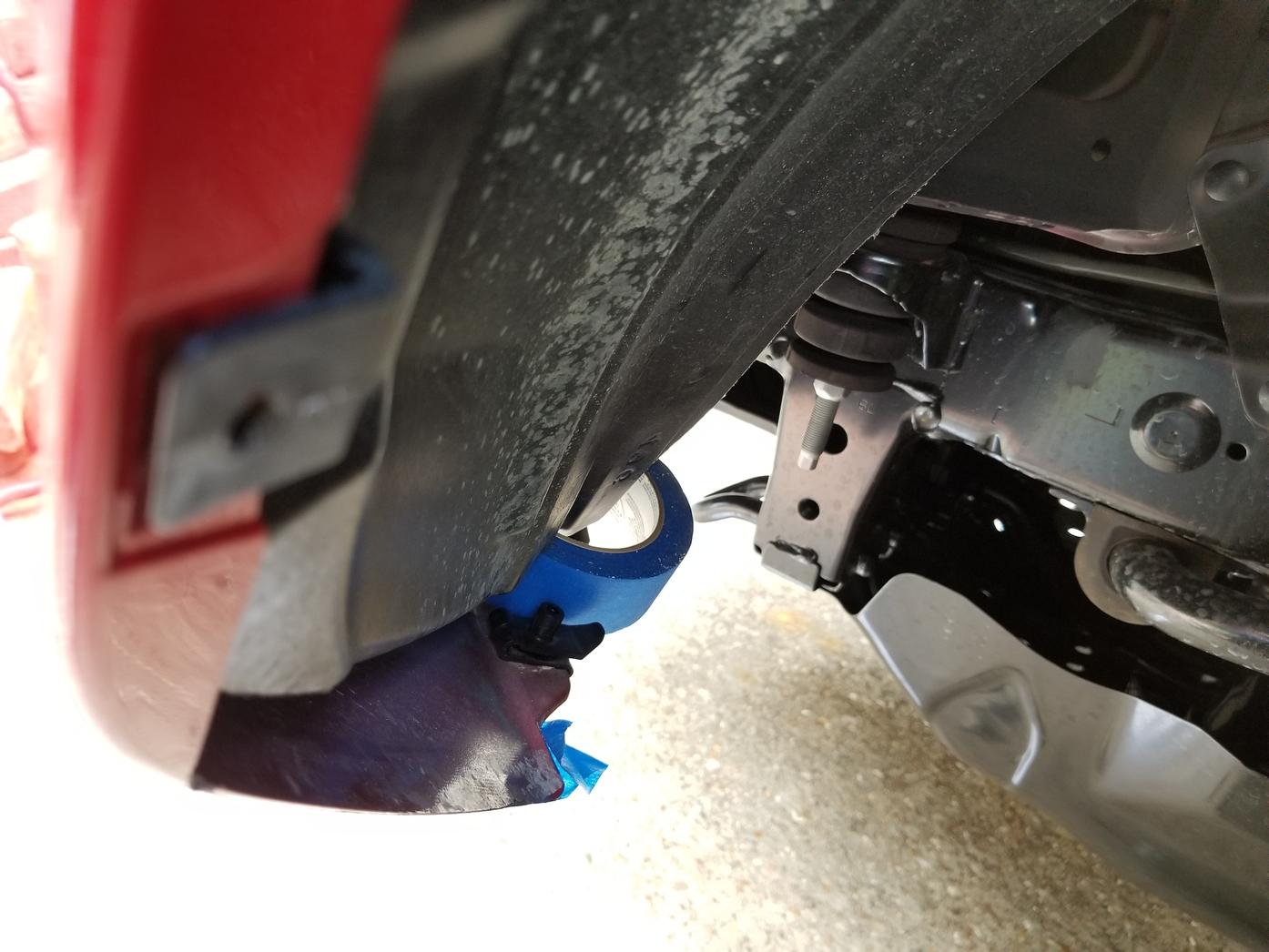

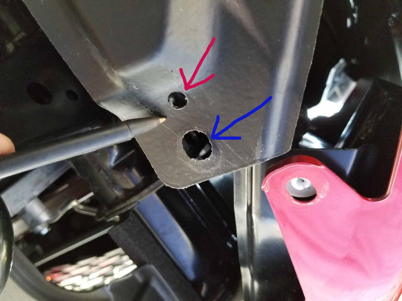

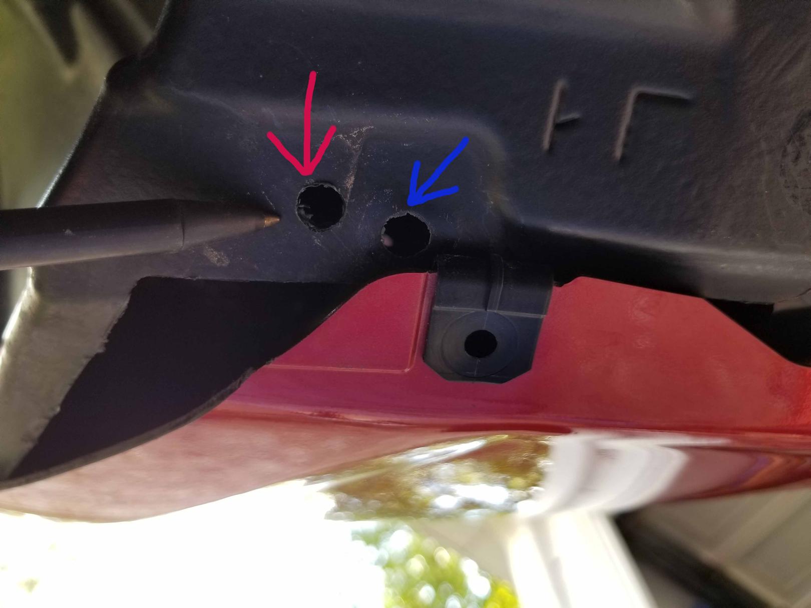

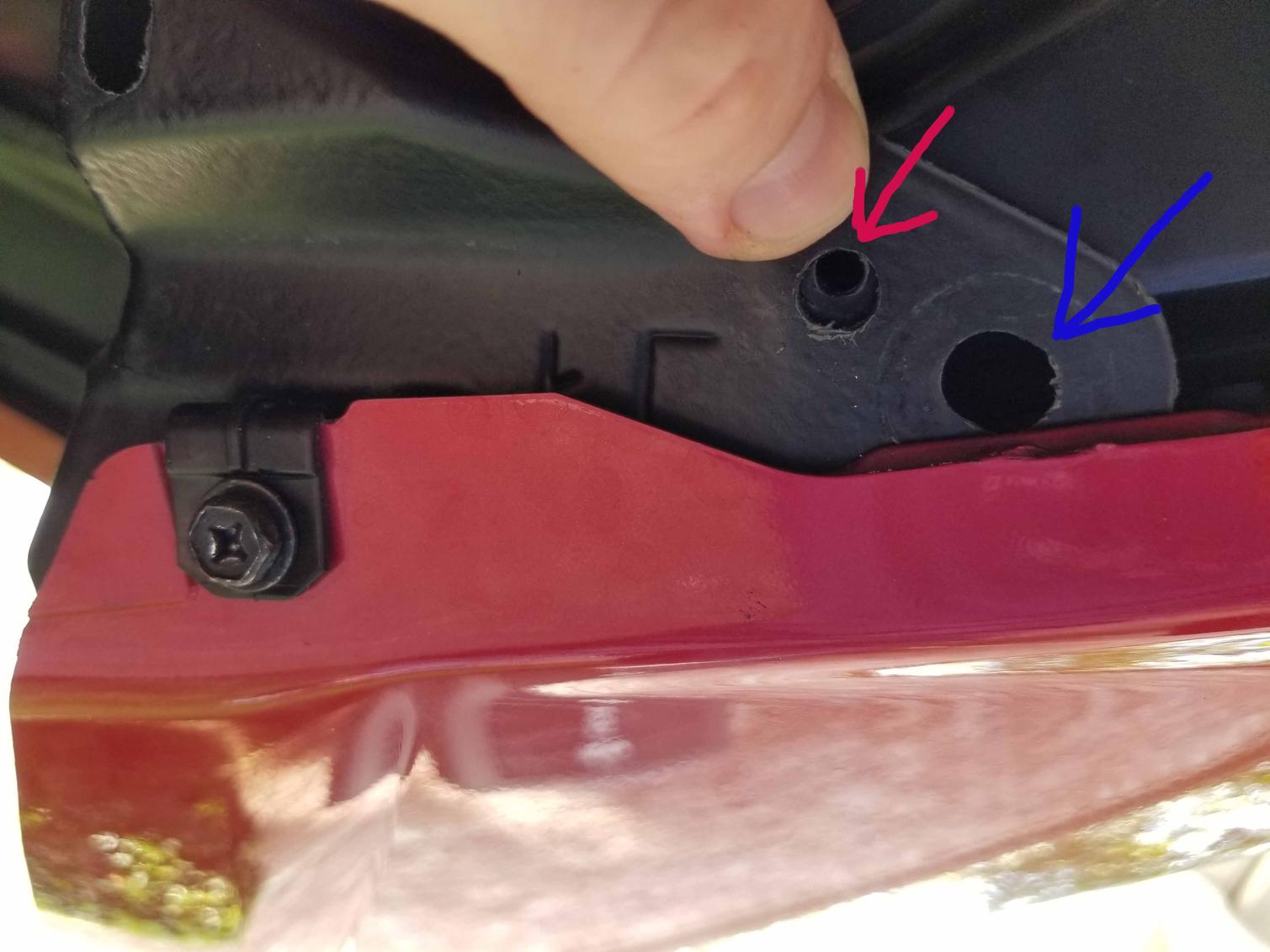

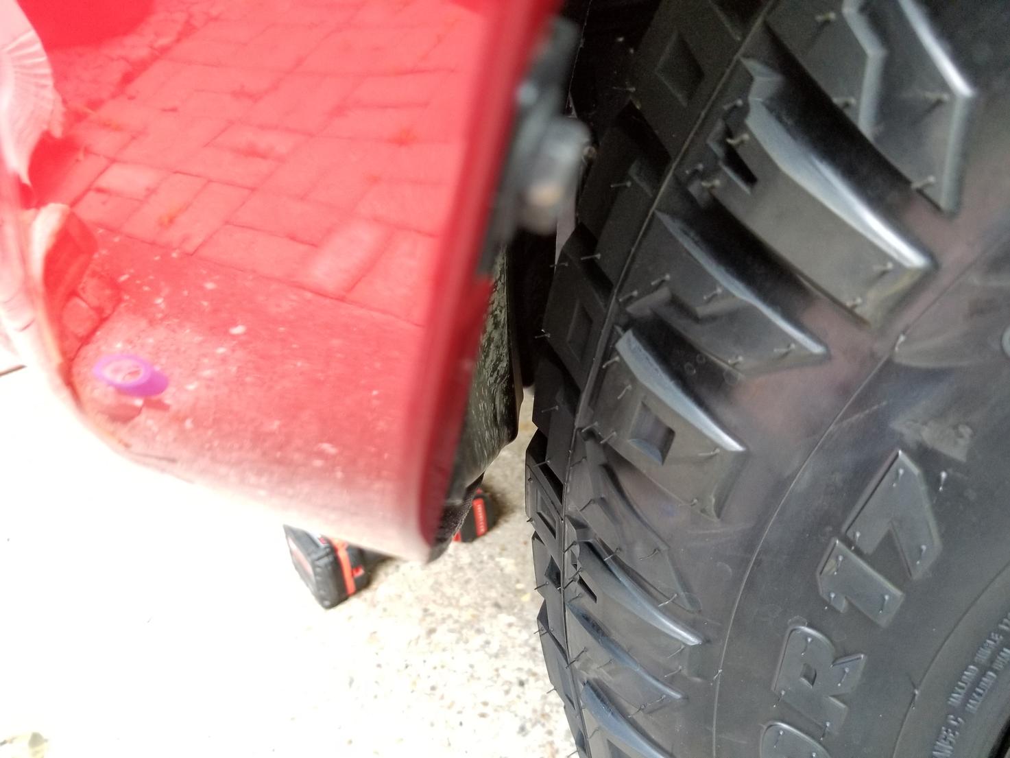

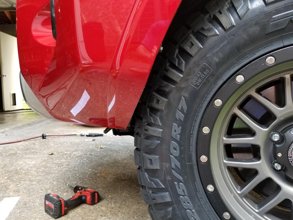

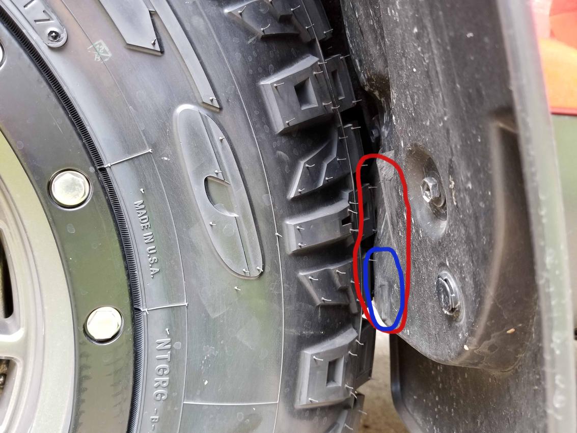

Here's how I trimmed my fenders. The red circle is the tire rub and the blue circle is where the body mount is. I saw no need in trimming the mud flap since it would probably just get ripped off anyways, i just removed it. The first blue arrow is the drivers side bumper rub. Then the line i cut on the tape. The roll of tape was used to hold the inner fender back while i cut the bumper corner. The next arrows are to show where to drill to pull the inner fender forward away from the tire. the blue arrows are the OE holes and the red arrows show where i drilled my holes. the last two pics show the new clearance from the tires.
The tires in the pics are Nitto Ridge Grapplers mounted on after market wheels.

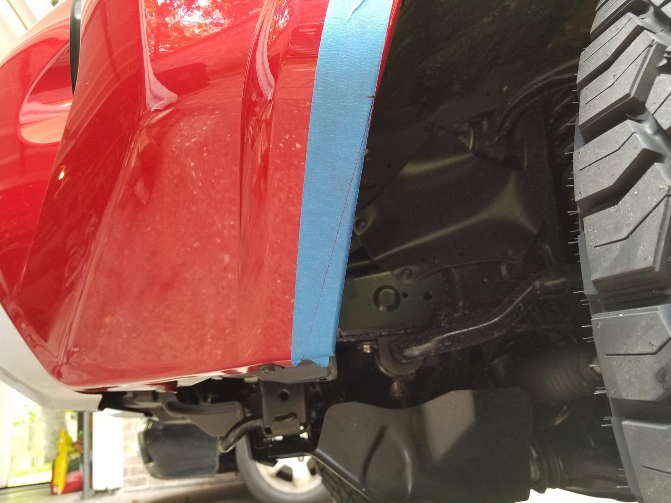

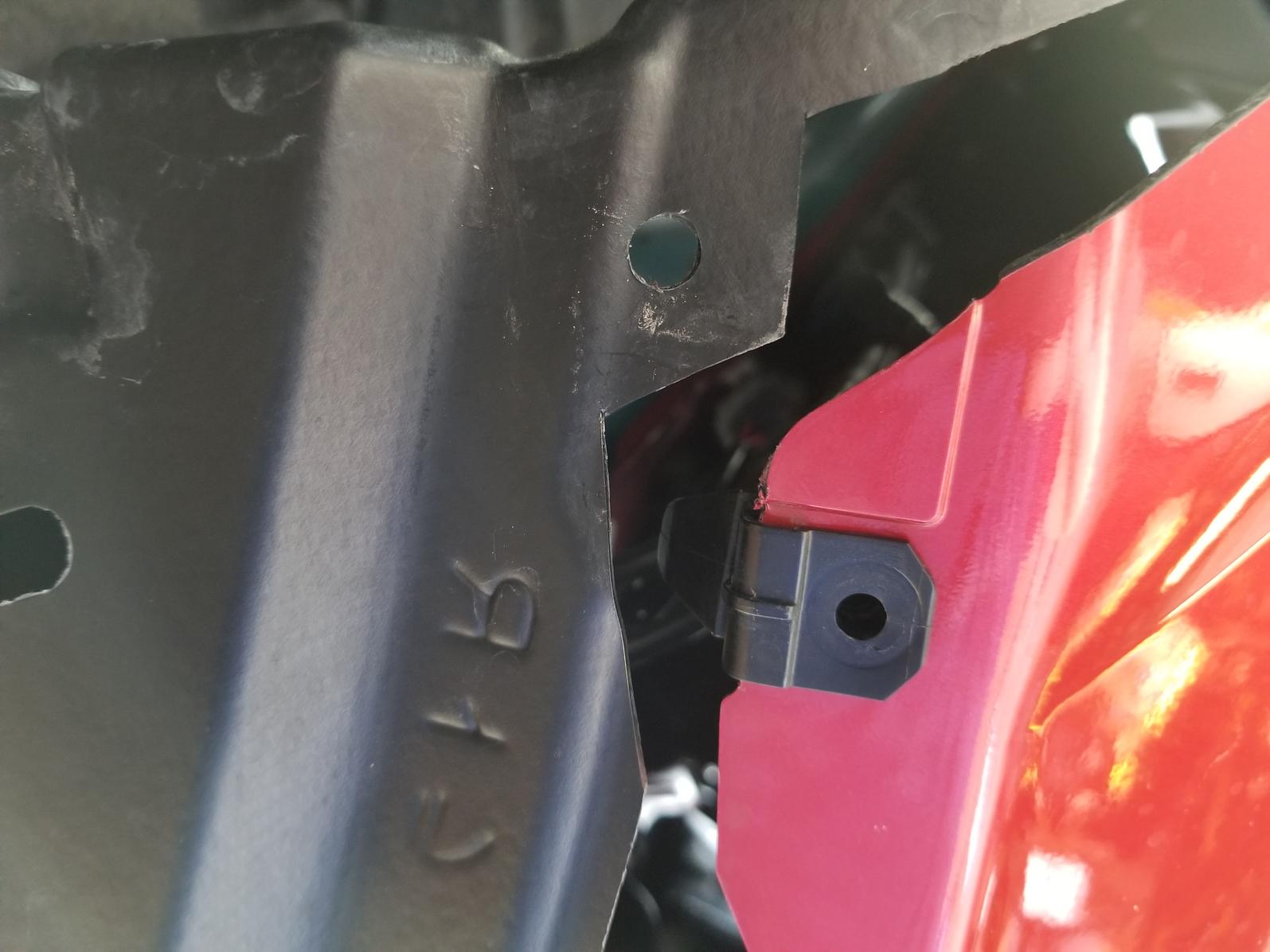

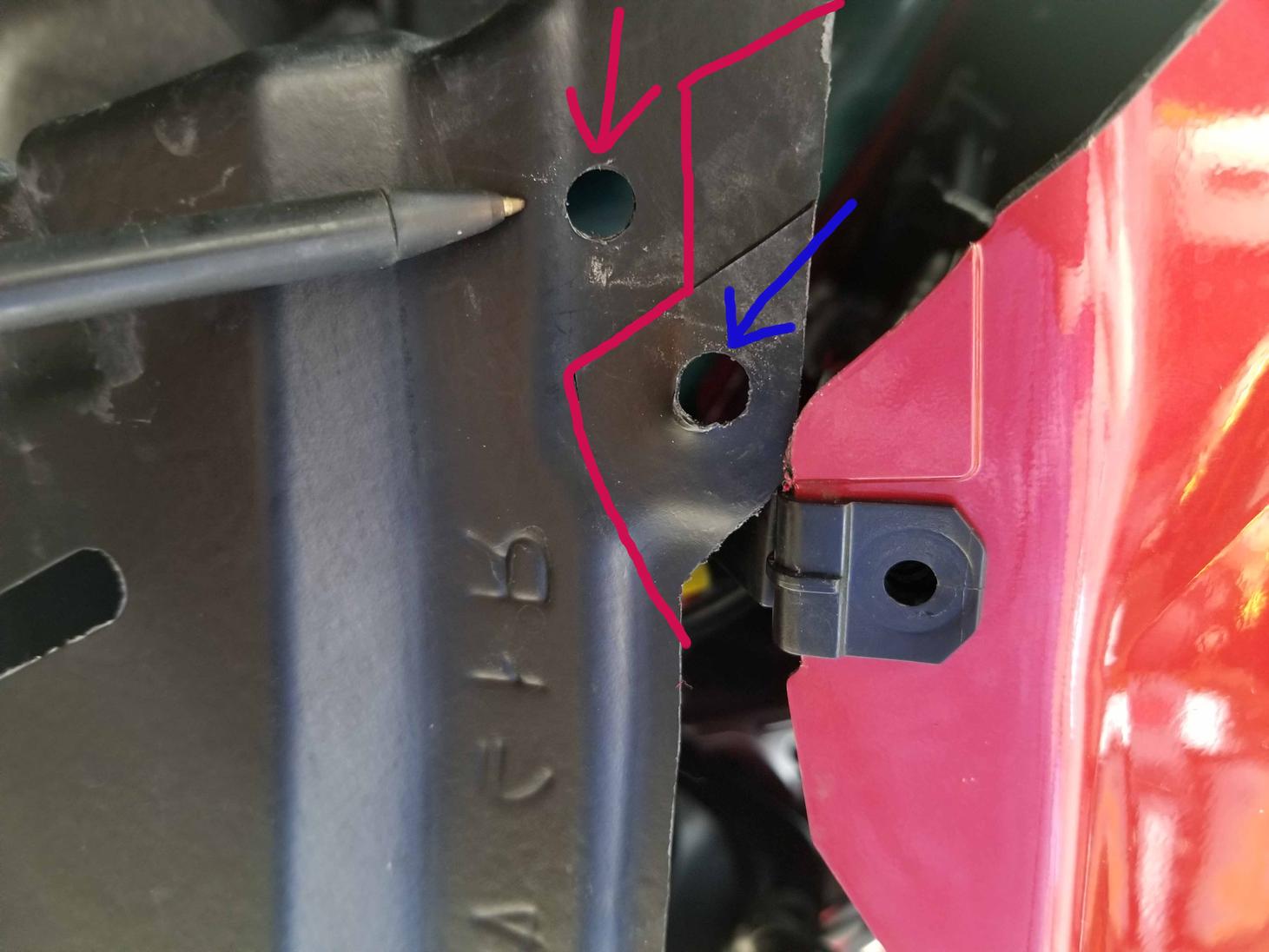

Here is the Passenger inner fender. The passenger side bumper will trim the same as the driver side. The blue arrows are the factory OE holes and the red arrows are the holes I drilled. The red line is where it needs to be cut. Pic after cutting on the red line and the clearance after its done.
These mods are on a TRD OR, not sure if all other fenders are the same.

Thanks [MENTION=170469]Gascat[/MENTION] for the great pics, this will work well for the 285 Ridge Grapplers on our new ‘18 TRDOR.
[MENTION=194488]canucktrd[/MENTION] My driverside front tire rubs on the body mount when turning and in reverse, let me know if yours does the same. I have also installed my lift since the pics, is yours lifted.
Hey [MENTION=170469]Gascat[/MENTION]. Yes, it’s been lifted 3 in the front so hoping that helps. We’re in a deep,freeze up here so the winters will be on for a bit but as soon as the spring arrives I will get the new rims and summer Ridge Grapplers on and do the body/wheel well work as well as remove the mud flaps. Thanks again for the pics, makes me think it shouldn’t be too much work.
