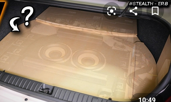

If this has already been covered, I apologize-- I've searched but most mods are centered around the JBL side mount.
I'm considering removing the cargo deck completely and making a sub enclosure for the floor along with a false floor like in the photo. CarAudioFabrication has an amazing car audio channel on YouTube for anyone considering upgrading.
Any posts out there on replacing the deck (officially joining the i hate it club) with a custom enclosure for the floor with a false floor on top?
Sure a few guys will direct me to the side panel mods--I've seen them and they did great jobs, but not what I'm looking to do. Did see the drawer slides with stealth boxes, but I'd like something with a lower profile.

Typically, those false floor enclosures are where a spare would normally be. I’m not sure you would have the depth for a standard sub there. But you could raise the false floor I suppose to get the height you want/need. It’s possible that some of the shallower subs like the JL line would fit, but those won’t have the performance typically of a ‘normal’ sub.
I figured I'd get about 3 inches removing the deck--3 inches doesn't sound like a lot, but I think most of us wouldn't mind 3 more [emoji38][emoji38][emoji38]
Idea was to cheat it to the seats and additional backing on the seats like a lot of guys have done on here when they're putting in a bed platform.
Might be better just to say screw it and look at the side install.
Sent from my SM-G975U using Tapatalk
Yeah, without the spare that would be tough to get enough airspace in a non-third row setup. The third row has a much higher overall height and could definitely be replaced with an enclosure. However I'm very happy with my side enclosure
