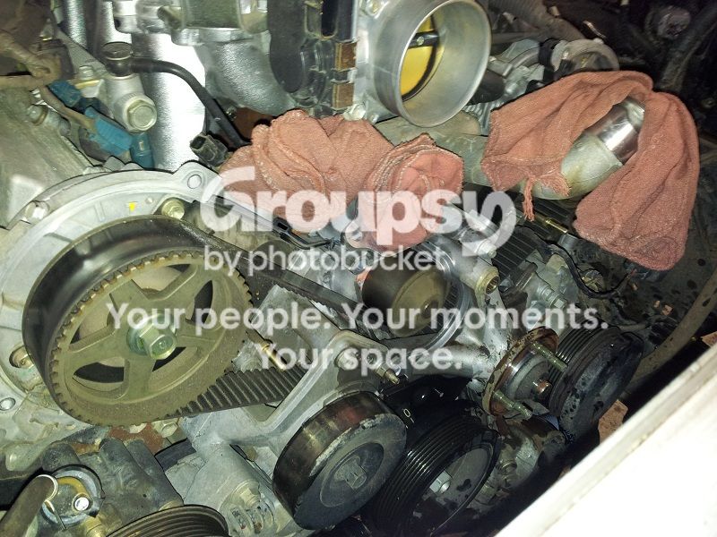

Is this on the V8 4Runner? Because the pulley for the water pump is under the timing cover and NOT connected to the fan clutch.
CamCoversRemoved_zps797059e0.jpg~original
On the 4.7L (2UZ-FE) V8 the fan clutch attaches to a pulley that is on a bracket (the pulley with the 4 studs on it in the picture). That's driven by the serpentine belt and nothing else, it's just a bearing and a pulley on an aluminum bracket.
The water pump pulley is the smooth cone-ended pulley to the 10 o'clock position of the fan clutch pulley in the picture being driven by the timing belt.
