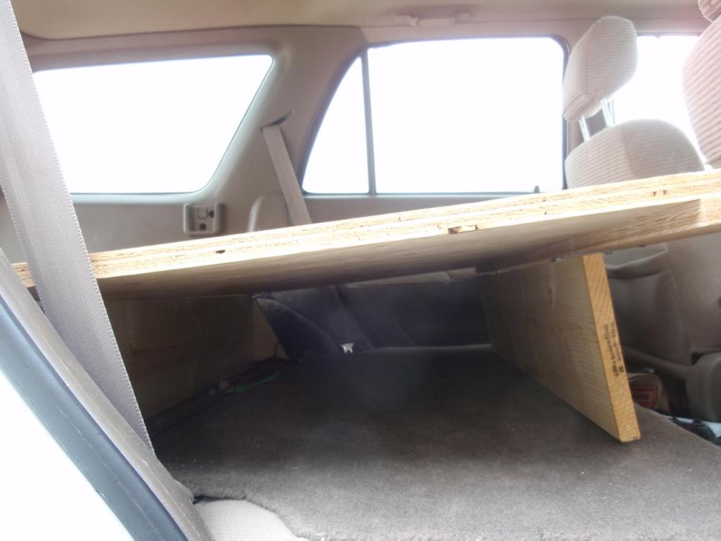

So I got ALL my LEDs installed - map lights and dome lights... Now for some pictures of my sleeping platform... There are two sections, the section in front is held to the rear section by draw latches, so it is quite sturdy actually. It works well, I like it.
Props to Rickashay (http://www.toyota-4runner.org/3rd-gen-t4rs/97683-rickashays-sleeping-platform.html) for inspiration and answering some questions! I chose not to go with drawers for now, to keep it simple - I may decide to add some in the future, I built it flexible enough to allow for that....
The two boards stacked on top go on the outside, on top of the wheel wells. I'm torn on whether or not to use them, as I kinda like having the wheel well space exposed (seems more useful). I also have to trim the boards a tad more and add some bike inner tube rubber to the edges to prevent them from rubbing up the entire side of my truck...
Photos!
Is that support angled because of the seat backs, and relaxes to a flat position with weight?
What height is that support?
Appreciate the interest! This is not a solution I ended up keeping, as it works, but requires a prop to keep it in place, as it is unstable with weight on top.
My solution for now (the platform needs a rebuild from all the lessons I've learned), is to take the seat bottoms out, and set them in the space between the 'laid down seat backs' and the wood. It is a pretty close fit in terms of height, but works well.
Hope that helps!
