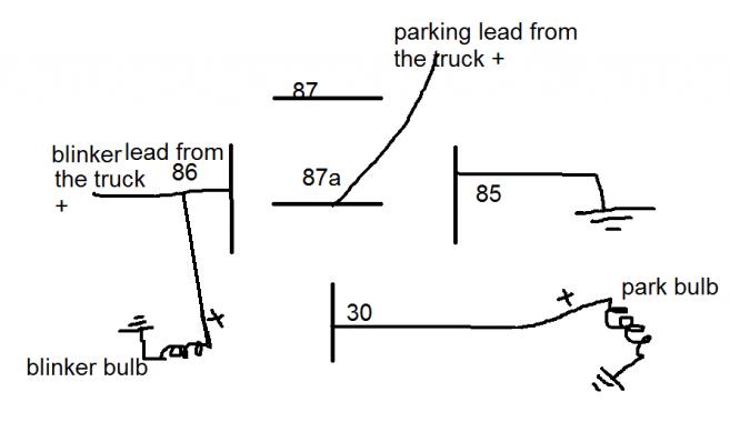

We need a wiring diagram to pick apart, from the description given something tells me it has to do with how it was grounded.

[MENTION=5345]habanero[/MENTION] I have it all hooked up to a relay, not just wires all connected together. same bulbs and same sockets on either side. both sides have their own relay. i connected the ground of the relay to the frame. you mentioned you also did something similar, is it blinking fast under normal conditions as well?

It looks like "blinker lead from truck" lacks an electrical load. Do your signals (when moving the stalk left or right,not hazards) flash at all with the parking lights off?
Nope. The way my wiring is set up, its only on with the parking lights :l I think you're addressing the problem correctly, only i dont know how to fix it lol.
EDIT: do you think if i connect a wire from the blinker lead from the truck to the blinker bulb while it is already connected to the relay it would be okay? I think i'll try that tonight after class. Thanks man! Ill update this then!
Ive concluded its the same problems thats associated with led bulbs, not enough load on the signal wire coming from the truck. It just took me a while to wrap my head around thinking of the relay as a led bulb. It draws similar amounts of energy giving "led" feedback to the relay and results in fast blinking. I need two load resistors :P

Here's the reason why the signals don't flash with the parking lights off,when wired as per your diagram:
Parking lights on - power flows from 87a to 30 to bulbs,bulbs light up.
Parking lights off - 87a loses connection to 30,instead 87 connects to 30. Since you have no power to 87,bulbs don't light up.
Parking lights on,turn signal stalk on - 87a and 87 alternate connections to 30,so bulbs blink.
If you kept the signals wired like factory and just tapped into the positive wire,your parking lights would flash and at the normal speed because the flasher relay has enough resistance. But only with the parking lights on though. I modified your original diagram to show the difference.

I do know that the way i wired it up, there is no power for the signals to work when the parking lights arent on.
