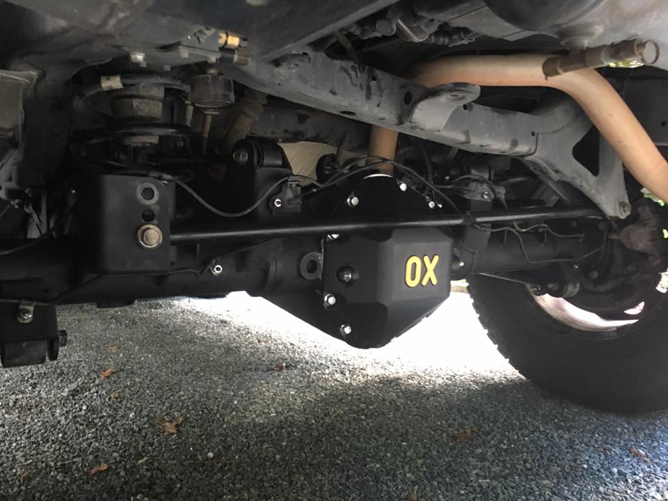

I have been wanting to do a rear locker for awhile now myself. prefer going with air, but, reading all the leak problems, I try to avoid the though.
As I haven't seen/experience any lockers w/air setup, knowing exactly how the component engages in there with the line. For instance, when engaging, does the line move with the system? And if so, this would contribute to the line creating leaks at the fitting, or lightly touching moving parts.
And if it does move with the system, to help with pipe staying out of the way, and less movement in the mounting area, wouldn't be wise to have a mounting bracket stabilizing the copper line?
Your picture is bringing these questions out, and Austins reply also.
It is possible for the line to shudder slightly when engaging, but it doesn't physically move. Honestly, if it ever rubs the gears, it wasn't setup right to begin with. After initiall install it should be maintenance free for many years. The nice thing is that air lockers are instantaneous. Electric lockers have a motor that has to turn and engage.

OX Rear Air Locker

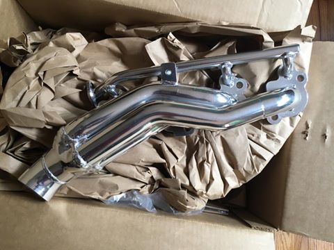

Doug Thorley Headers (To be installed... passenger manifold cracked)

When the headers get installed, I'll probably redo the entire exhaust. As soon as the new gears are fully broken in, I'll get out and start testing all the new toys and post pictures.
