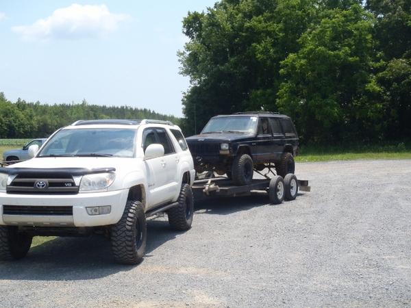

Man, I'm having such a difficult time deciding on what to do about the sway bar. The problem is, I travel 4-5 hours each way to mountain bike races pulling a small travel trailer about 5-10 times a year. I'm just so scared to pull a trailer with no front sway bar.
pulled it 30 something miles, jumped on the trail with him then towed him back home.. no sway bar, plenty of control
It will feel slightly different no doubt but you adjust to it. you still have the rear sway bar which you may or may not have extended the links of so if the links are still factory your rear sway bar has enough tension on it you won't feel much change. If you extend the rear sway links you'll gain about an inch or so of travel out of the rear axle as well but still have plenty of on road control. The factory front sway bar is in place to counter the soft riding spring setup from factory. Once you upgrade to man springs like ours lol (there stiff as all get out i need a front bumper lol) the sway bar really doesn't do much because the preload of the springs stop the body roll before much pressure is even applied to the sway bar.
also its only 6 bolts to remove maybe take it off and hook up to your trailer for a joy ride an see how you like it. It's certainly a preference thing hope this helps I also have a 1.25 body lift and stay fully loaded with recovery gear an spare tire. One change i really liked about removing the sway bar is the ride soften'd up just a hair from how stiff it was after installing the OME springs, just enough to make it comfortable again. I still need to get the proper preload on my springs i'm setup to carry front and rear steel bumpers and front winch an dual batteries lol haven't added any of that extra weight yet so it will be interesting to see how well the handling is without the swaybar once I add that extra weight
