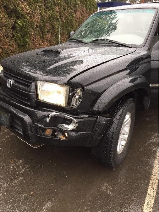

First off, everyone is unharmed. Anyways, wife was driving my 4Runner, turning at an intersection and hit a patch of black ice while making the turn. She slid into the oncoming lane and into the side of a car stopped at the intersection. Here's the aftermath of my baby:
I only have liability insurance, so the repair will be on my dime :ybrick:
The only thing I wonder, is would it be worth replacing the bumper from a parts yard myself, and having an auto body shop do the rest? I just wonder if it's worth doing anything besides simply turning it over for the repair, and writing a big check.
For the record, we have an emergency fund for just such occasions. But I don't want to get destroyed by a body shop.

Glad everyone is ok. Hood, fender, little trim panel under headlight & bumper maybe headlight, all easily replaceable yourself. I've always had full coverage, fire, theft & collision. Only $78 a month with State Farm.
You'd be surprised how much you can pound out of your own panels with a rubber mallet, a 6'er of natty ice, and a "nothing to lose" mentality.
But seriously, try DIY. Hit up car-part.com and dig around locally for a bit there to see what you come up with. Any body shop is going to start at a minimum of $600 for that bumper + paint + misc garbage underneath that probably also broke.
totally doable
Yes I would certainly fix that Look at my album and see how bad my wife tore mine up. I only spent about 900.00 to fix mine so yours should not be that bad. Mine was totaled, but I love these 4R's so much I brought her back from the dead.
you can do it brother, go for it!
I'd say hit up a junkyard. Your black paint makes it easy too: you can get the new psrts professionally painted for several hundred, or you can personslly roll on Black Rustoleum Enamel, $50 Paint Job style. Sand and buff it good and no one will ever know.

I would definitely watch Craigslist for part outs. Getting OEM parts is MUCH superior to aftermarket, but brand new are very expensive. Might have a tough time finding a '99-02 bumper that isn't chrome, but you might get "lucky". Fender should be relatively easy.
Once you have the new-to-you bumper and fender, I would install the parts, and take it to a body shop to fix the hood, and do the paint work.

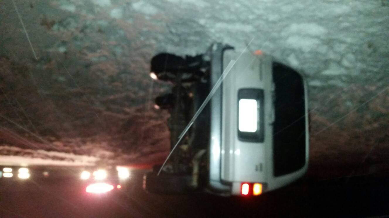

Dude thats nothing! Heres my rig
one year ago, just after i fixed the trans. Bad tires, black ice, and a semi passing at crazy speeds.
and now, heres the worst of it. Paint is a bit off....

I recommend you to buy body parts in the junk yard.
Your paint code is located on the driver side located by VIN number.
Bumper is not complicated to replaced and you need also to replace the Front reinforcement to save frame damage in the future oem important
