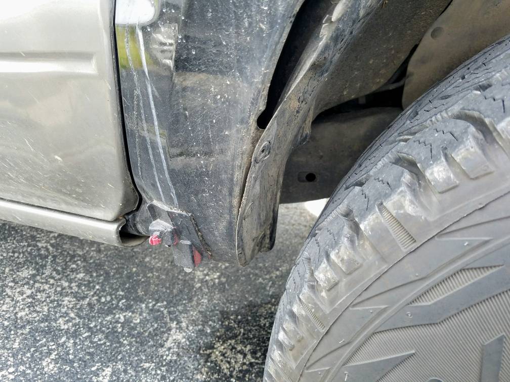

Hopefully you can see where it rubs here.

With that sized tire the only foreseen rubbing on the pinch weld would be caused from using a wheel spacer or low offset aftermarket wheels. If neither of those, alignment as mentioned already is really the only other possibility unless something in the front end suspension has been bent from an accident.
No spacers and stock wheels.

Given what you guys are telling me I'm hoping it's just the alignment. Once I get the steering parts on I can get the shop to see what's going on and see if the castor is out of whack.
It is possible something is bent from the collision, I haven't noticed anything under there looking damaged but it would be easy for me to miss as I haven't been looking for it specifically. I assumed it was more of a body panel out of place issue.
