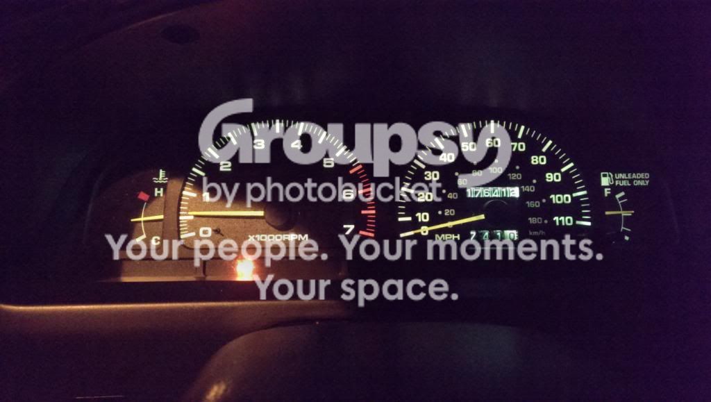

I'm curious if my engine temp is normal, it was 32 degrees out. It usually stays right below the half mark. Also my car idlles between 1000-1500 rpms at a nice steady idle. At cold start it idles higher. Is that normal ?

Temp Looks normal to me.

I haven't been in cold weather really with my T4R, but are you sure it was fully warmed up? It should stay about half way. And your idle is to high if its at 1000, in your pic its about 600, that's normal idle. Yes, get some degreaser and clean it all off. You can't find a leak very easily on a filthy engine.
Wow I'm stupid. I misread the rpm odometer. It idles at 600 when warm but when u start it in morning when it's cold its at like 1000-1500. I'm sure it was fully warmed up because I was driving on highway for 30,min. Isnt it true that to cold of engine temp is bad ? What bolts should I retourqe ? Any way of checking if rear engine seal is bad ?
