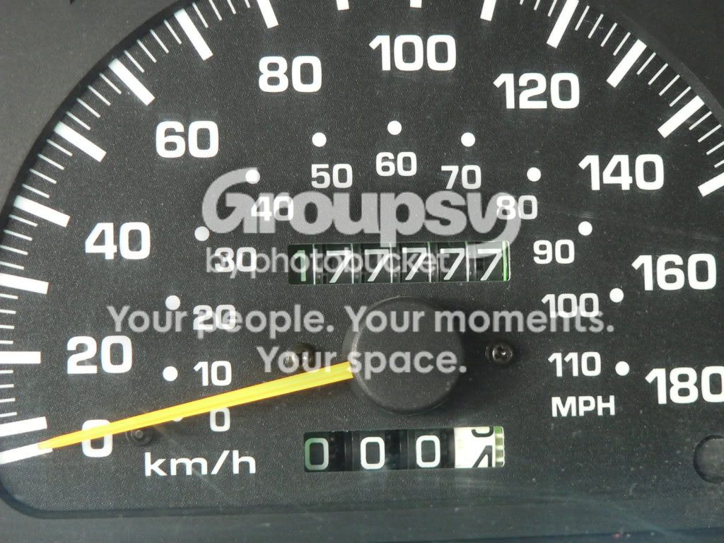

Another little bump.....just hit a new mileage marker with the Runner!

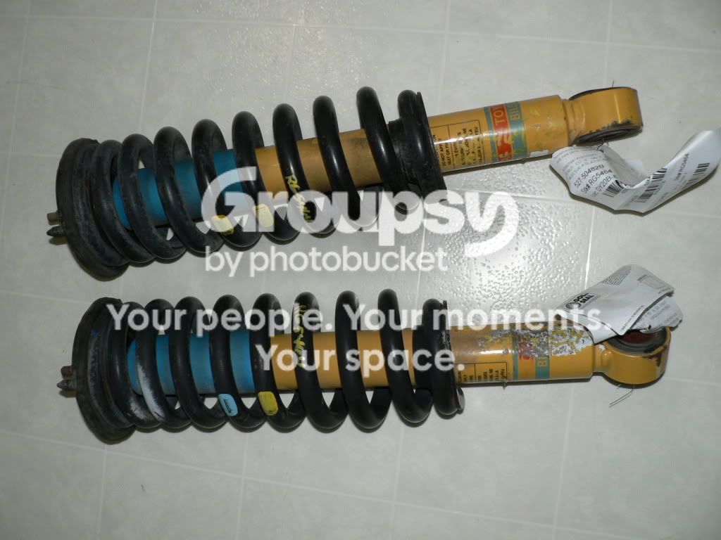

P1110179.jpg~original
These are the Units I bought from Nordstrom Automotive off E-bay. They come off a 2000 Tundra TRD Access Cab. I paid $160.00 for the pair, plus $140.00 for shipping, and another $25.00 or so for the Customs fees. (Shipping from the US to Canada = MURDER! So total after all was said and done: $325.00.

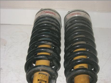

How do you like the ride with those y/b billys? The Tundra lift thread of all threads over at Yotatech says "i do not want those!" haha. Im getting the same struts with 30k on them shipped to me as we speak.
I don't know what that ride is like, as I haven't mounted them on the truck yet. I'm waiting to get my rear setup upgraded before I mount the Tundra stuff up, as I don't want to be driving with a Reverse Rake....
Your's looks like it's got a spacer installed inside the coil pack too??? That may be too much....not sure. I'm going to be running the small top plate spacer on top, not inside the coil pack......I'm told this is more desireable.
Yeah I will definitely be taking that spacer out. I probably wont use a spacer at all as I like the idea of just a coil lift. Looking forward to seeing yours installed!

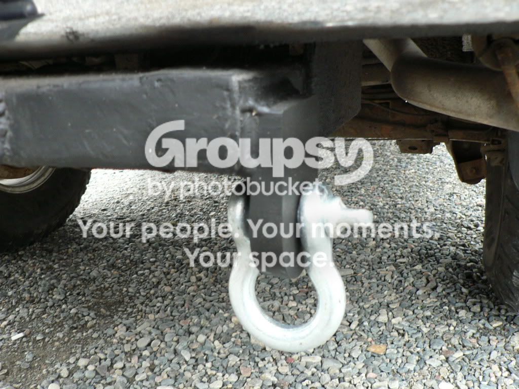

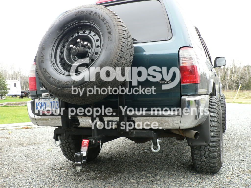

Revised my towing package and Tire Carrier......

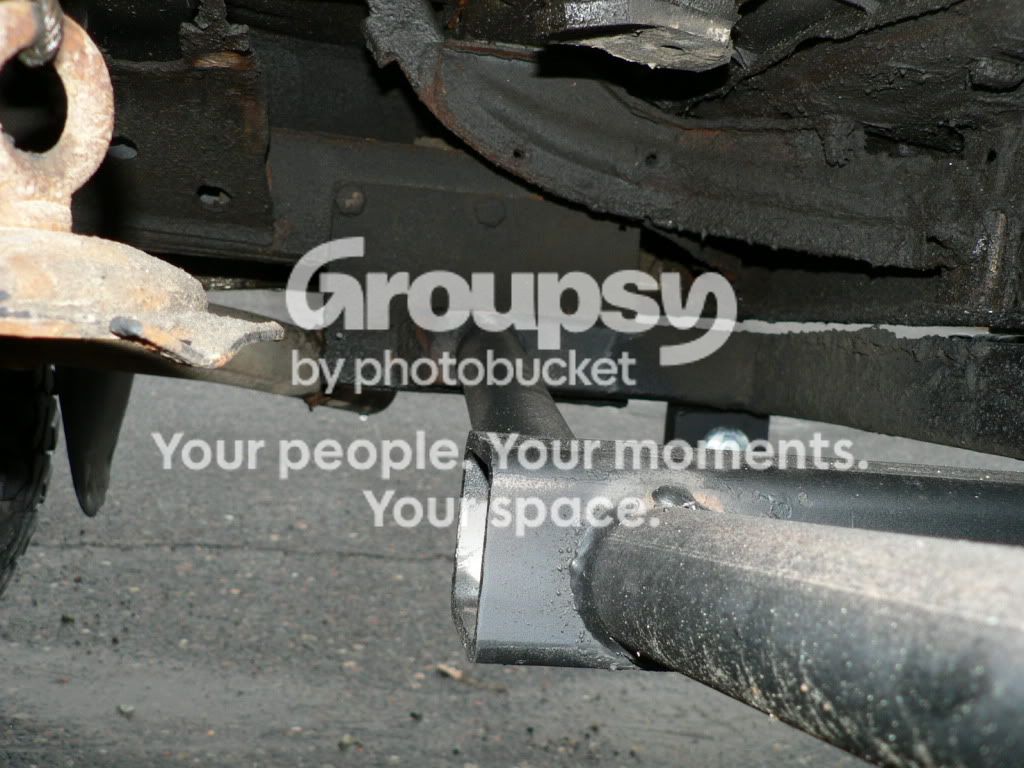

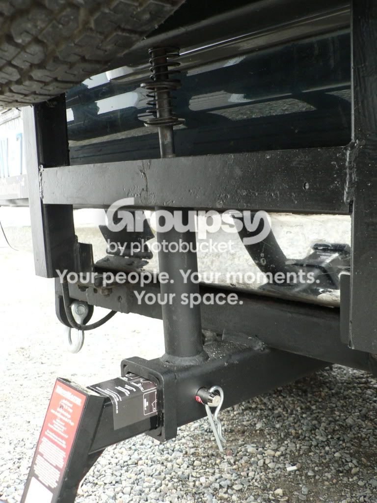

Decided to replace my center receiver on my tire carrier as the old one was seized inside. While we were in the shop we decided to add some D-Ring mounts, and some extra bracing under the truck for the trailer hitch. In the process of adding the new center receiver, we were not able to save the square locking tube, so we decided to make a new one with round tubing.

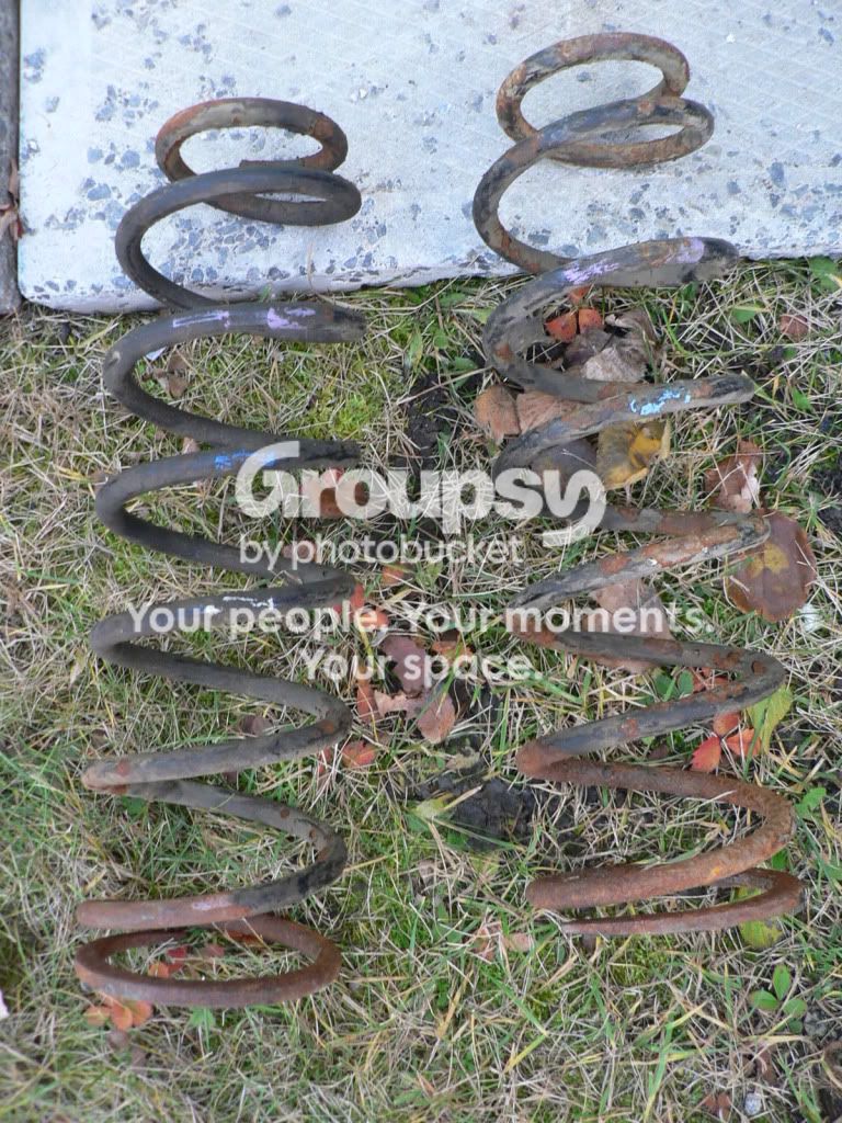

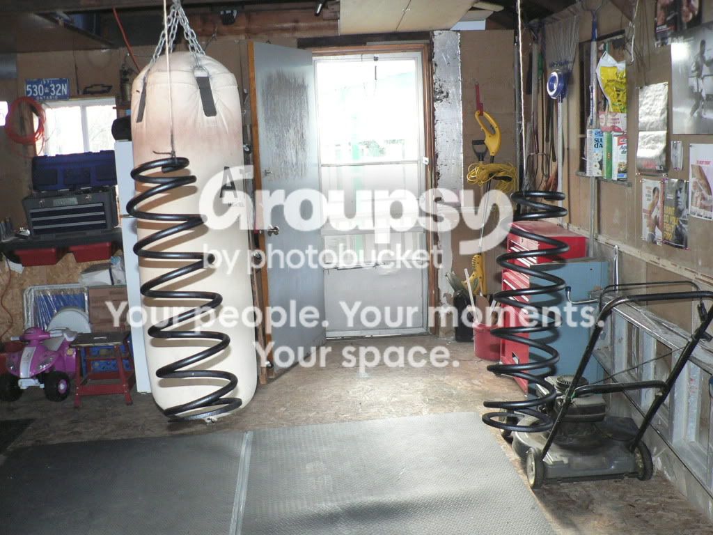

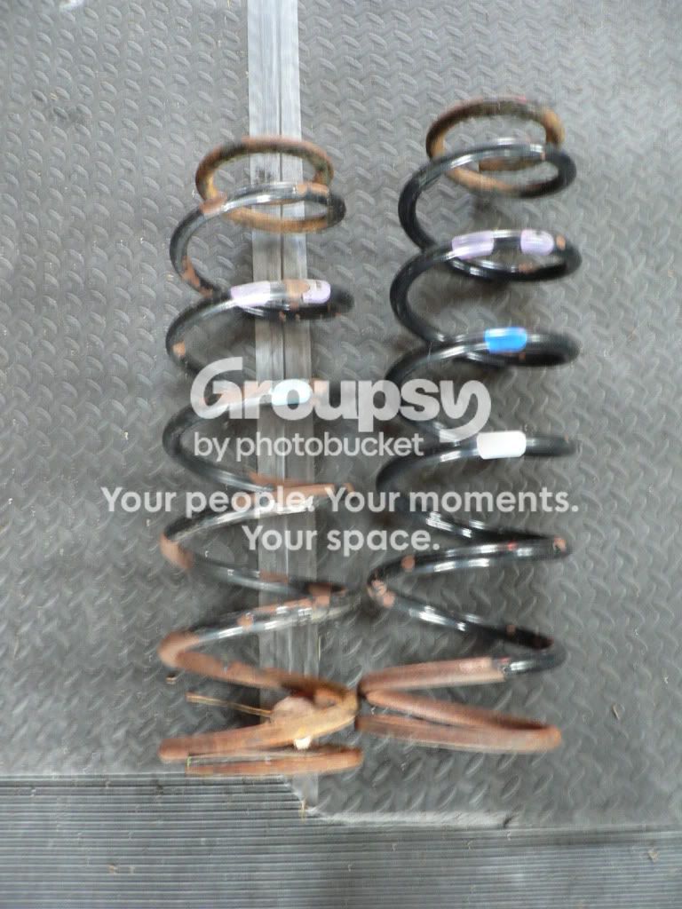

Ok, so I got myself some LC coils for FREE! They came off a 93 FZJ80, and were a little dirty and rusty.
Here's a shot of them before I cleaned them up.
P1110248.jpg~original
Here they are degreased
P1110250.jpg~original
Here they after I took a wire wheel to them and Painted them up
P1110265.jpg~original

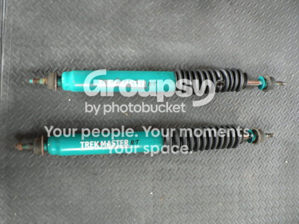

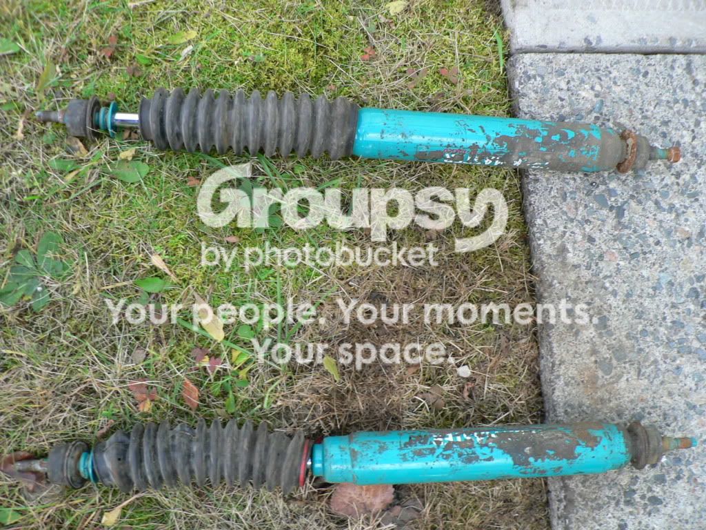

Oh yeah, I also got some Trekmasters too, but I don't think they will work with the rear of my 4Runner, as one end of my current shocks have an eye at the bottom, and these have studs at both ends......

I might be wrong but I think I read one time that either toytec or SS. sells an adapter to use these trek masters on the 3rd gen might be worth asking around.

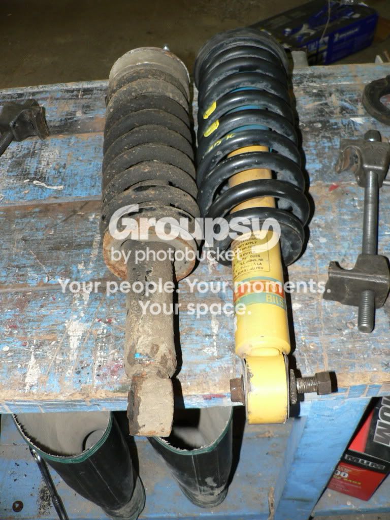

So I finally got around to installing my Tundra TRD Struts and LC coils. It took us the better part of the day, but well worth it!

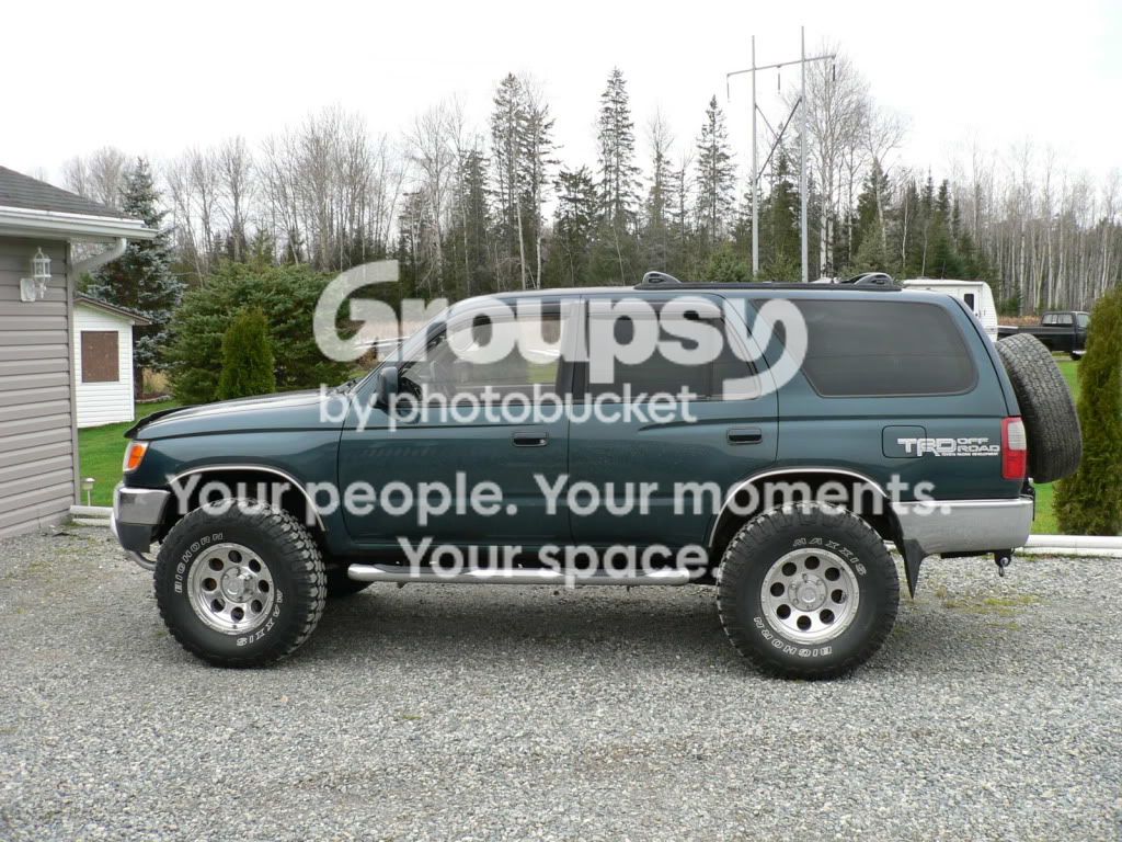

After w/ Tundra TRD Struts (Toytec 1/2 top plate spacer and LC Coils:
P1110313.jpg~original

Left is the Toytec spacer on my 4Runner strut assembly, right is the Tundra stuff:

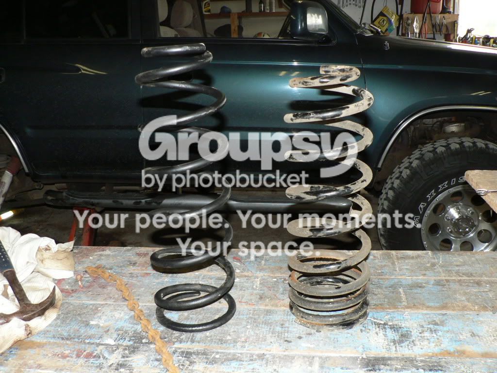

Left is the LC 8 Wraps and Right is the OME 890 Coils:
P1110311.jpg~original
I have to say, that this swap was worth every penny! Great ride, and I love the stance! The ride is so much better! The 890's with the front spacer gave such a harsh an bouncy ride, compared to Tundra and LC stuff. Not to mention it gave me at least an extra 2" of lift in the rear and about another 1" in the front! I wish I would have taken some before measurements, but was so excited to get started, I forgot!

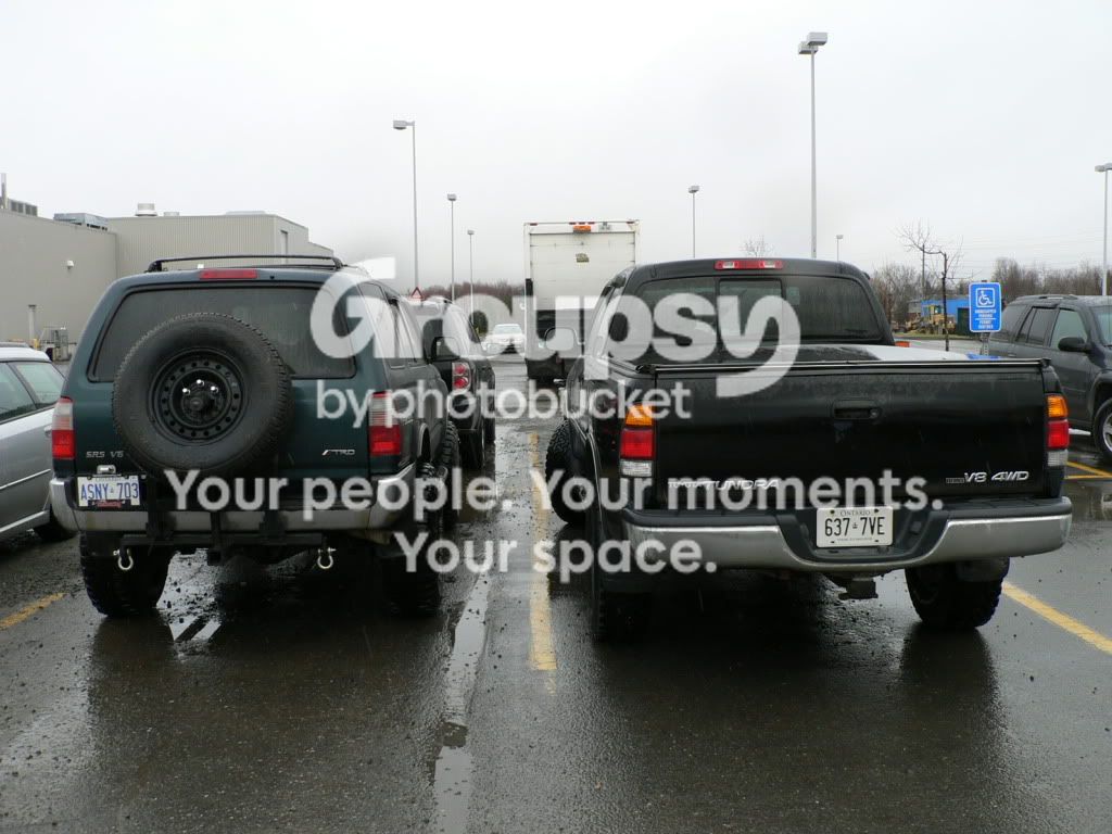

I ended up stopping at the Local Autoparts store, to return the Spring Compresors I borrowed, and saw this Tundra parked there. I thought it would be fun to take a pic of the 4Runner next to a Full Size Tundra from the same Era and see the difference!
P1110315.jpg~original
The 4Runner doesn't look so tiny anymore.....:party:
