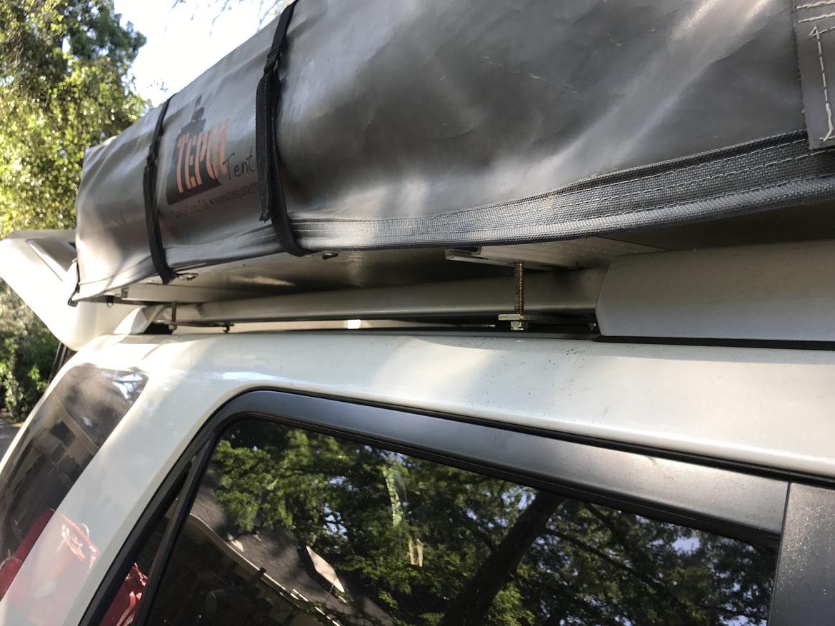

I'd bypass the crossbars altogether, attach directly to the side rails if possible.. I know some rtt's require horizontal bars though.

It's fine. I've had a Tepui kukenam mounted directly to the factory rails (NOT cross bars) and now have a CVT Rainier mounted on Thule bars. Anyone who says you need a roof rack is just not thinking it through. All aftermarket roof racks use the same 8 mounting points as the stock rails and there's nothing magical about them that lets them hold more weight.

NICE!!! this is what I was looking for.
does this setup damage the rails? being hallow aluminum rails?
thanks for the pic!!

Thanks for the info!!! and your personal experience!! this is very helpful.
Looks like there isnt much friction except from pressure of the bracket tightened? Does that slide a bit at all front to back or side to side?

Which direction does your tent open with the tent mounted like that? Driver side? Passenger Side? or does it open front to rear?
I've got it setup for a passenger side open. Tepui tents allow you to mount the aluminum tracks to the bottom of the tent in two orientations, length or width-wise. This enables you to set the tent up for either side or rear opening regardless of the type of rack you have. I'm not sure of other brands but given their similarity it's probably the same deal.
I went width-wise cause I originally had it mounted on a gobi and wanted to maximize weight distribution. When I carried the tent over to this truck the factory rails worked fine so I've got no complaints.
