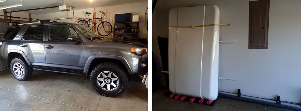

I use the 45058 system with my Autohome (actually have two sets). One stays mounted to the RTT while the other gets used for canoes/kayaks. The white PVC slides over the bar ends making it easier to lift when mounting or removing. They slide off of the bars once mounted.

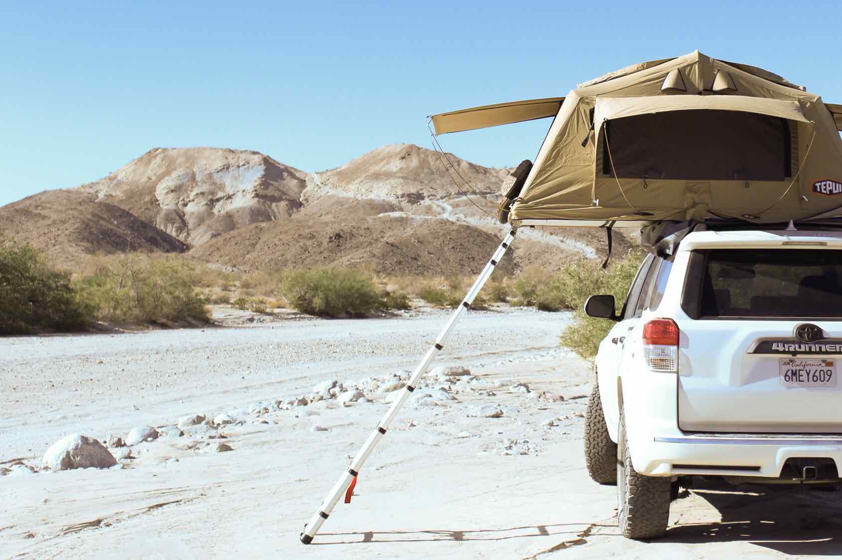

I'll play too. It works, it's safe, and it's cheaper! I've had mine bolted to the factory cross-bars all last summer and into this year. You'll see a bit of a dip in MPG (you just put a bit box on top of your vehicle, duh), but not more than 2-3 hwy from my experience.
And pics, because why not?

I'm using all factory parts that came on it. My tent is bolted to the factory black cross-members that go sideways.
I did use shorter bolts from Ace Hardware as the SmittyBilt bolts would have put holes in my roof, but other than that, what came on the 4Runner when you bought it should be more than enough.
