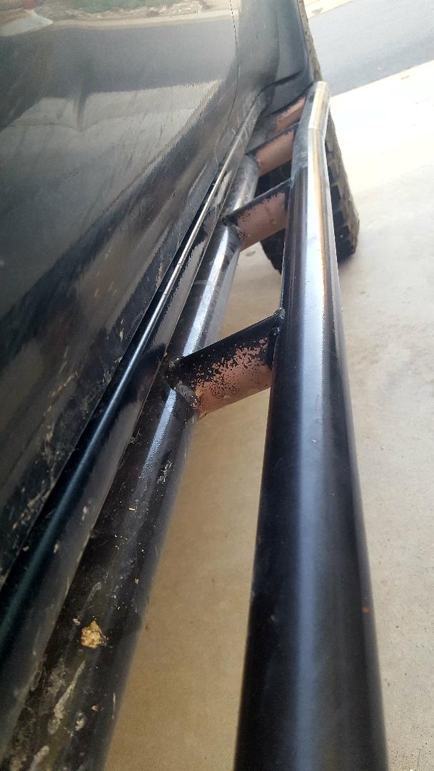

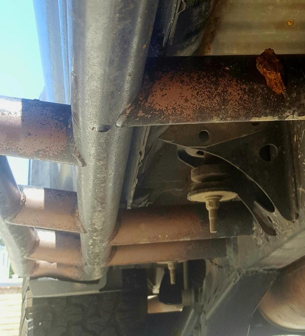

1st trip with my new sliders and the front SR5 flair cap and my sliders were sand blasted so I'm going to have to come up with either a mud flap or running board under the slider to prevent rock strikes. I'm surprised it didn't get the body but I think the angle between the slider tubes was too steep. I spent a lot of time priming and painting the sliders for nothing....LOL
I figured I would scratch them on some rocks but not like that.

Hey Wedgy, I have the full-length OEM mudflaps and my sliders still look like that after sandy trips. I've had to partially repaint them twice. When the trips are muddy then my sliders are entirely coated with mud.
I'm actually working on a design for a removable secondary mudflap made with a rubber sheet. Will let you know what I come up with.

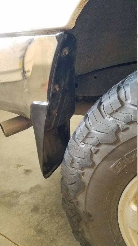

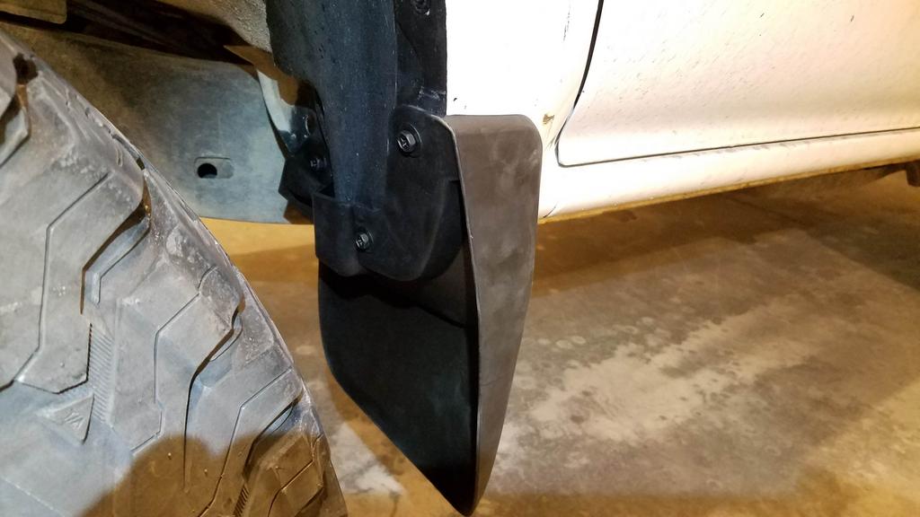

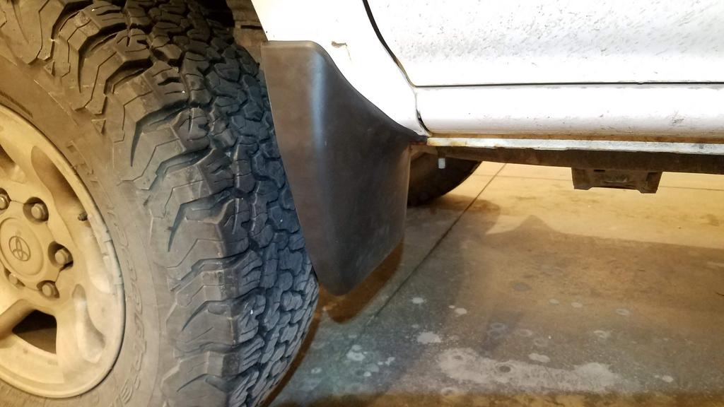

This has been a work in progress for many months now and I’m still not completely done, but I wanted to share it with you guys.
Like many of you, I have a SR5 with the running boards removed. This means there’s a gap in the fender flare that is totally unnoticeable to a normal human, but drives some owners absolutely mad (myself included). Toyota dealers are sold out of the SR5 mudflaps that fill this gap (well, the right mudflap is still available, but the left side has been sold out for years) and I didn’t feel like chopping up a one-size-fits-all mudflap from Autozone.
UPDATE: pics of 3D printed parts installed
(click on pics to enlarge)
Inspired by forum member "Dfarms", who mysteriously disappeared and stopped selling mudflaps, I set off to make my own mudflap. I bought the still-available right mudflap for $40 and tried to scan it with the 3D scanner at work.
...however, my plan didn't work out so well. The 3D scanner at my office sucks so I found a local company to scan it which set me back $150 :yuck:
Then I mirrored the file to create the left mudflap and uploaded the file on a bunch of sites that do SLS (the same way my outlet covers are 3D printed) and the quotes ranged from $350-$2000 per mudflap :yuck: :yuck: :yuck: :yuck:
So at this point I was $190 in the hole and all I had was a 3D scan of a mudflap and a right mudflap lol
I decided to fix the broken Makerbot Replicator 2X we had at work that has been collecting dust for 3 years, after 4 people gave up on fixing it. Turns out, it wasn’t all that hard, but this led me to my next issue -- the mudflap is too big to print on this 3D printer.
So I spent a few hours in the CAD world chopping up the file so it would fit, but still have the right look. I’m pretty happy with the result:
Printing (the scraggy looking stuff is support material):
Printed out of black ABS plastic, but still not finished, sanded, and painted:
Installed (but still not finished, sanded, and painted):
Comparison of my reduced mudflap vs SR5 mudflap -- there's a lot less "flap", which can be a good thing if you're worried about breaking it on things while offroad:
