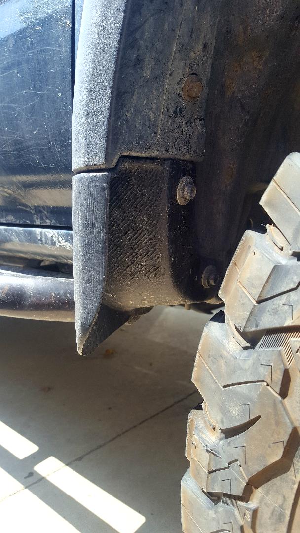

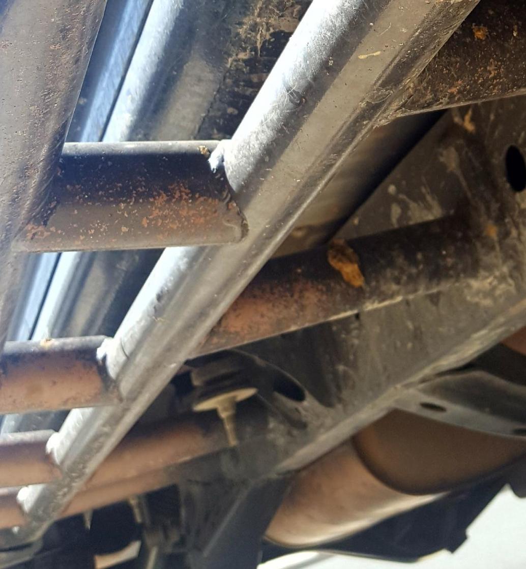

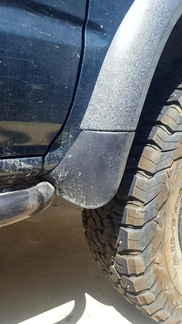

These are the ones plastics guy designed but BH3D(Brad Hicks) printed. I think Brad said he modified it slightly in some way. I don't care I needed them and would take anything after what I went thru LOL
I was a bit disappointed that my new sliders got sandblasted on their 1st trip out, I put a lot of time in on the paint & prep. Stubbs Welding is going to get back to me on a possible fix.
What are you using for paint? I painted my Stubb HD-SKO's with rustoleum in a bedroom converted to a paint booth and I've not yet had an issue with them getting sandblasted. Not that I'm constantly driving down dirt roads at high speed, but I've probably done 200-300 miles worth of that in the 3 years I've had them on. Last I talked to Stubb's he was lamenting about possible having to shut down shop:sad:
I degreased, scuffed, cleaned, dried, etc. then red oxide primer two coats, plenty of warm drying time then several coats of hammered finish and lots of warm drying time. No runs, drips, etc. I've done a bit of body work and painted a few panels and motorcycles but never a whole car. We did ~150 miles of aired down wash board dirt roads @30 mph and ~35 miles of 4x4 @ 5 mph I think it needs a bit more mud flap to catch stuff thrown off the front tire. BTW if you've never been to Saline Valley Hot Springs it's well worth going but about 50 miles of bumpy washboard each way.
