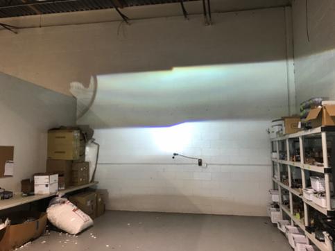

I got this pic from Lightwerkz while I was deciding my retrofit. Caesar (LW owner) said it was a good quality piece of kit, but these are my reasons for choosing HID.
Width: The MLED is highly center-focused (hotspot) with noticeably less width overall. One of my reasons for doing an HID retrofit is greatly improved light spread. My score: HID 1, MLED 0
Color: This HID is 4200K and I'd guess the LED is ~6000K. It's a bright white, which does not appeal to my eyes. My score HID 2 MLED 0
Foreground: You can see the LED has much more foreground light. Technically, this is considered less desirable as it focuses your eyes too close to the car. My score HID 3 MLED 0
Lumens: I have Lumen readings somewhere. From memory, the HID is about 70% more than OEM halogen, and the MLED is 100% more than OEM halogen. Bear in mind, readings taken at hotspot. Some will prefer, some will not, I prefer the better spread. My score HID 4 MLED 0.
Dependability: The LED will outlast an HID bulb, but there's cooling requirements, untested by time. OTOH, there's more componentry required with HID, thus more to fail. My score HID 4 LED 1.
Cost: Not enough difference for me to care. As I've said before, I don't discuss this anymore because armchair critics.
Again, MY opinions. Posting simply as FYI.

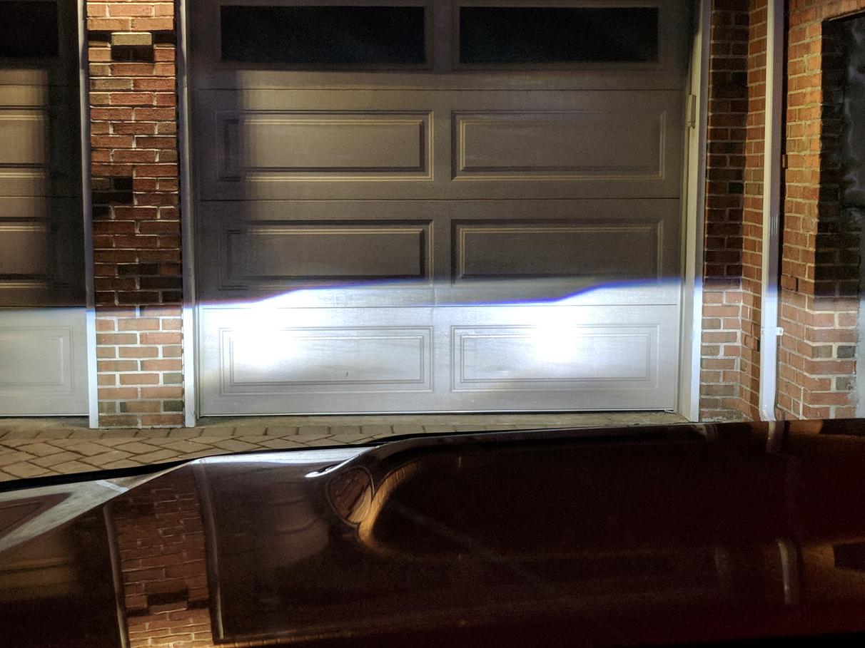

I previously did hid in oem projector. That gave good light.. but beam pattern sucked, and had obviously glare. i get highbeamed a lot.
This seems to have too low a HOTSPOT below the beam cutoff, causing me to get too much foreground light, and not enough light where i need my low beam to be.
Thats what I mean. It looks like the projectors are actually producing a square hotspot from the shape of the LED die. Which looks bad enough, but that kind of light "spread" is useless.
thats what i told retrofitsource. they say my beam.. is normal
Everything seems completely normal from what we see there.
Holy Christ. Do my eyes deceive me, or can you actually see the square die shape in the hotspot?
That looks terrible IMO
its a super low hot spot in contrast to the cutoff.
Sheesh. I sure wasted my time posting my analysis of the LEDs vs HIDs, including output pics.
