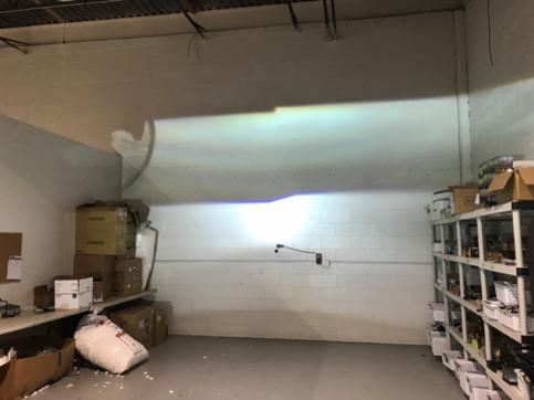

MLED compared to Lexus HID (pic)
I got this pic from Lightwerkz while I was deciding my retrofit. Caesar (LW owner) said it was a good quality piece of kit, but these are my reasons for choosing HID.
Width: The MLED is highly center-focused (hotspot) with noticeably less width overall. One of my reasons for doing an HID retrofit is greatly improved light spread. My score: HID 1, MLED 0
Color: This HID is 4200K and I'd guess the LED is ~6000K. It's a bright white, which does not appeal to my eyes. My score HID 2 MLED 0
Foreground: You can see the LED has much more foreground light. Technically, this is considered less desirable as it focuses your eyes too close to the car. My score HID 3 MLED 0
Lumens: I have Lumen readings somewhere. From memory, the HID is about 70% more than OEM halogen, and the MLED is 100% more than OEM halogen. Bear in mind, readings taken at hotspot. Some will prefer, some will not, I prefer the better spread. My score HID 4 MLED 0.
Dependability: The LED will outlast an HID bulb, but there's cooling requirements, untested by time. OTOH, there's more componentry required with HID, thus more to fail. My score HID 4 LED 1.
Cost: Not enough difference for me to care. As I've said before, I don't discuss this anymore because armchair critics.
Again, MY opinions. Posting simply as FYI.
