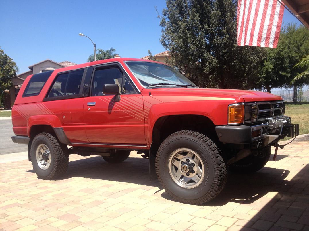

Finally got a 1st gen t4r!!
It's beautiful! I'm sure you're going to enjoy owning this thing. Your interior is super clean, I wish mine looked as good. If you're ever around the OC area, give me a holler!

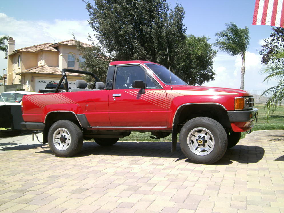

I kept the stock springs and added extended shackles. Up front 1.5 inch ball joint spacers. So far so good the ride is just as good and I get a little lift.

Amazing machine, amazing interior!! Take care of it!
thanks!! i plan to take good care of her! I'm planning to take the original decals off and replace them new and have ding doctor take some small dings out and do a full paint correction polish on her! then painting the removable hardtop satin black.
