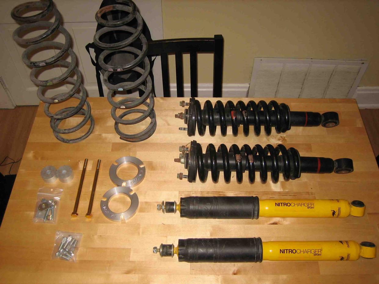

I finally got all my parts together and now I’m ready to do the lift. I had been searching high and low for the cheapest alternative to a decent suspension lift and for all the parts needed.
Here’s the run down on the parts costs:
Front LC coils for the rear: $37 bucks shipped

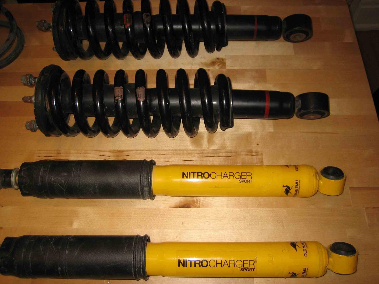

Tundra 4WD coilovers NOT TRD: $90 bucks shipped
Rear OME 60027 rear shocks: $120 bucks shipped (Thanks RunningRick)

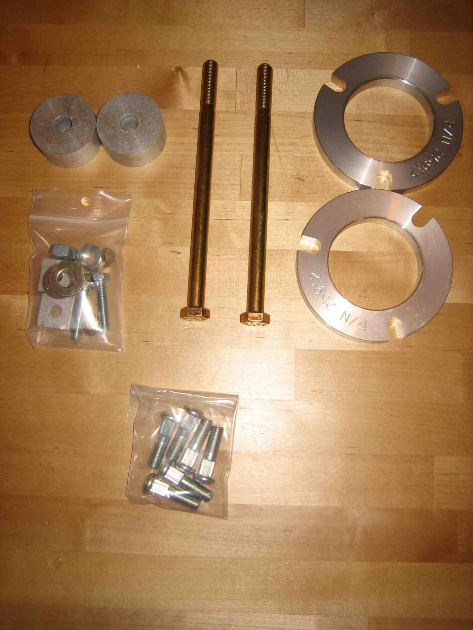

ToyTec diff drop & top plate spacers: $104.33 shipped
Total: $351.33
I also wanted to thank all the awesome folks on the forums for all your continued help and advise. Especially Sam AKA Rockdawg84, Duhockey, cj80cruiser, 99yota4 and Mauzer, for all your expert advise and help finding the right parts needed.

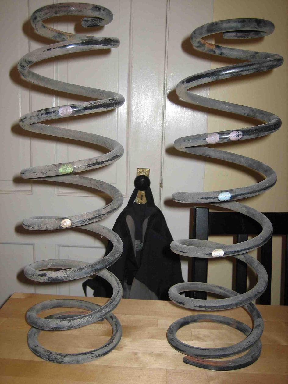

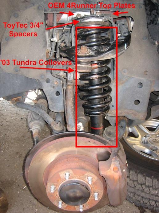

I don't know that much about Tundra TRD 4wd coilovers but I was thinking that they would have the blue/yellow dots or blue/blue dots. I gave up my search for these last week. Is that right jrebolloso? I honestly am not sure on this.
Congrats.
First off here are a few things I noticed, the Tundra coils you have are not the trd 4x4 coils so I'm not sure if that will lift it as much as mine. They also look like they are linear springs instead of the progressive trd (yellow/yellow and yellow/blue). The Black shocks also look like they are the stock tokico's if i'm not mistaken. Second, you might have to do some trimming on your front skid plates for the diff drop will stick out lower than it was. Third, The long coil (purple/green/white) will go on the driver side. This is to compensate for the weight of the gas which is located on the driver side. I'm not sure how the OME springs will do with the flex that the LC coils potentially have. I heard that they are a shorter, stiffer shock to accommodate expedition gear. It should still work nice. In terms of the lift you can expect...I'd estimate about 2" up front with the top-outs and about 4" rear. I'd say do it yourself if you can get some friends to help. Remember for the rears, remove the shocks from passenger side then driver side (the coils should just drop out, if not push down on the drum and it will. And don't forget to disconnect your sway bars) Then installing, you want to start from driver to passenger because the driver coil is longer. Good luck!
To tell you the truth cj80cruiser, I didn't and still don't know much about 'em. I went on some Tundra forums and read up a little but I mostly went by what the seller told me and those are Tokico shocks on the coilovers, which I plan to change out for bielstein at some point but they only have less than 1K miles, so that wait's gonna be a while. I still doubt they were TRD though, but $90 bucks shipped for some pretty new Tundra coilovers will work for now. They are purple/purple and purple/red. I think?
Congrats.
Thanks 99yota4! Think I should or could exchange that top out spacer for something larger from Toytec? I think you might be right about the front coilovers. That's a lot of info, but the more the better since this is my first time and don't wanna f* anything up and it turns pricey on me.If I have to trim the skid, should I maybe just not put in the diff drop? Thanks again!
You should trim the skid and put in the diff drop
x2 what cj80 said. I still haven't trimmed mine but i have the diff drop in because I don't want the CV boots to wear out so quickly.
in regards to the top-out spacer, i wouldn't because there is nothing bigger for a top-out spacer. You could potentially get the preloading spacer but those suck... Those give you a 3" lift over stock stuff but it stiffens up the ride alot and your coils and shocks will wear out faster. Just install the lift and see how it sits. Give it some time for the rear to settle. Mine settled a bit just from the looks of it after hauling alot of tools around recently. It looks nice! I'd get the alignment ASAP after the lift because your tires will hate you

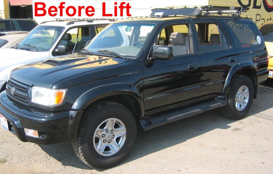

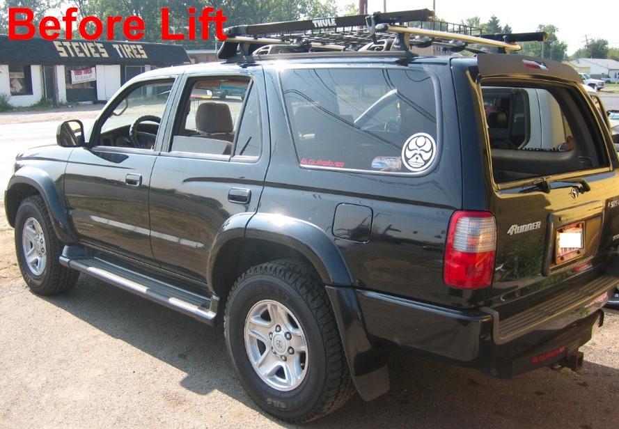

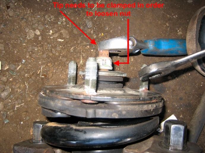

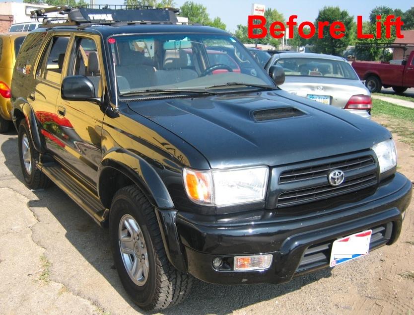

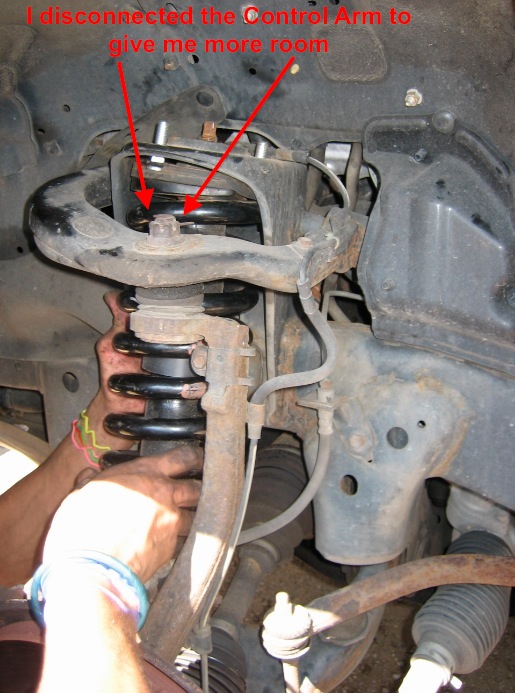

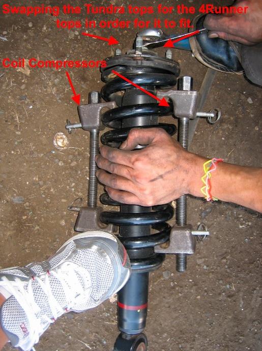

It was a grueling 2 days and then back to work so I hadn't had time to update you guys. Here's the before pics and pics of the front being changed out:

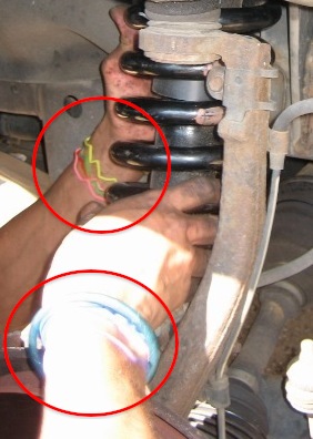

BTW, that's not me with the silly band rubber band thingys around the wrists. That's my buddy that helped me out. So Gay
And I won't bust his balls about it since he busted his ass helping me out.

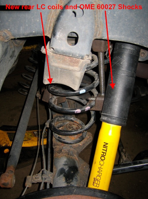

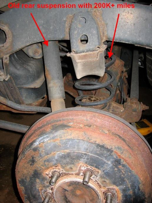

Now for the rear...

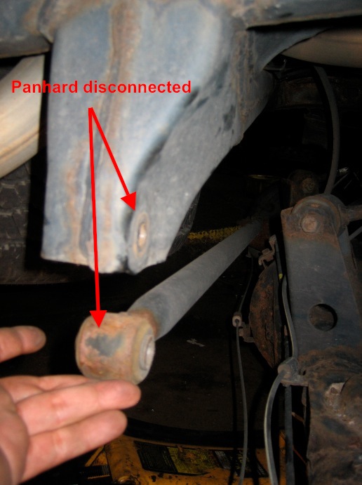

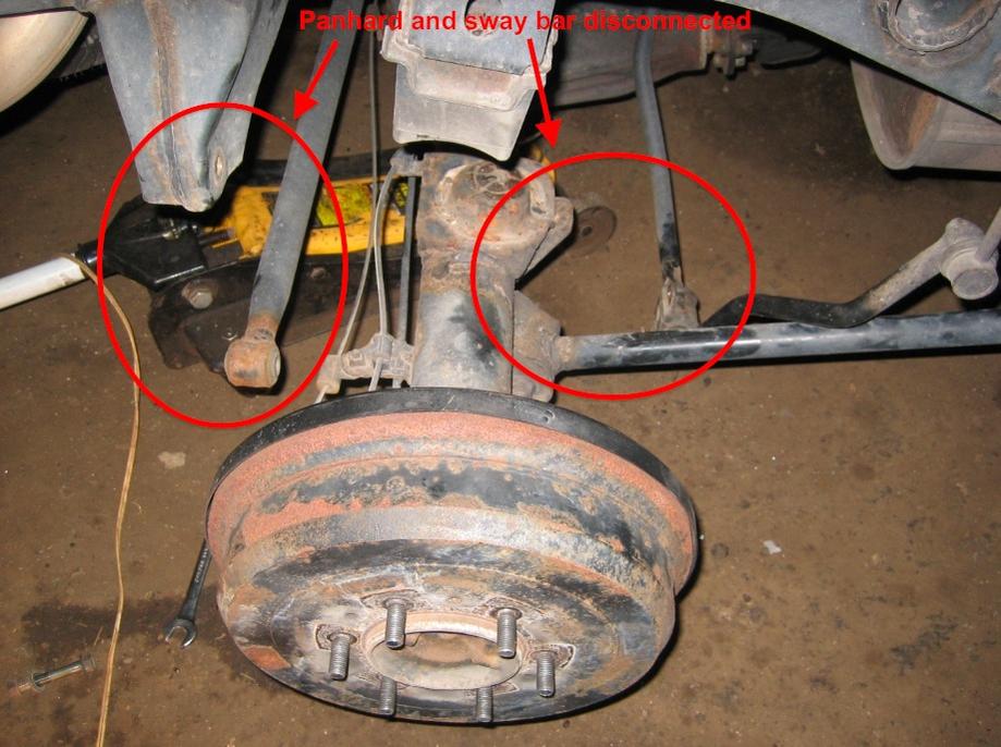

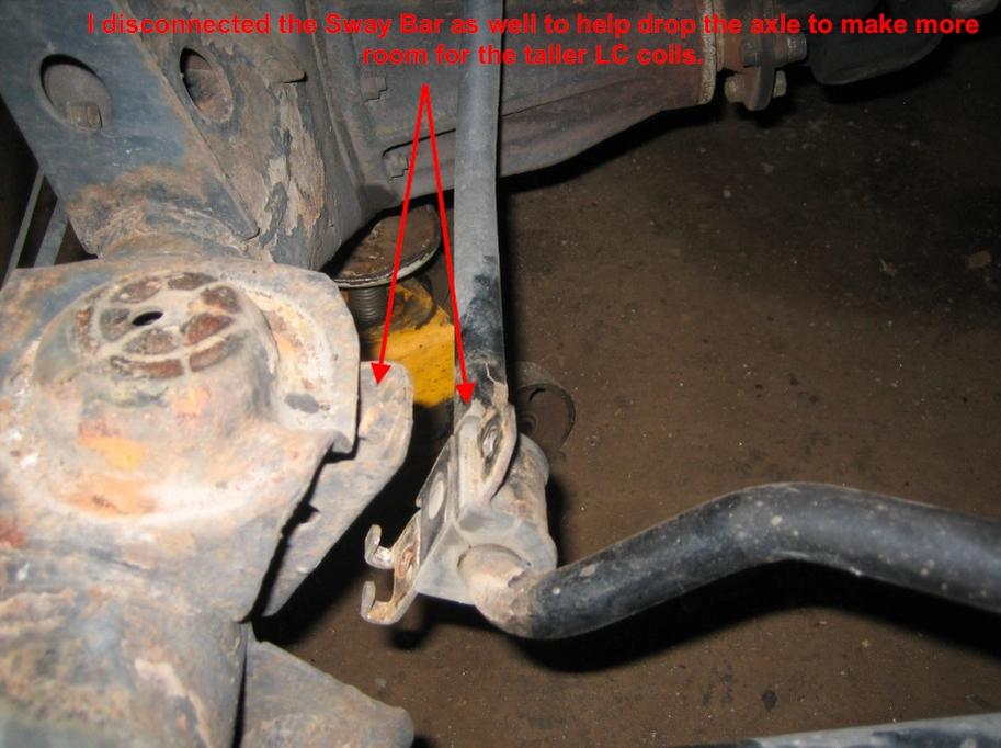

Here's the rear suspension swap using rear LC coils and Rear OME 60027 shocks.
Correction, the front Coilovers are Tundra 4WD NOT TRD.

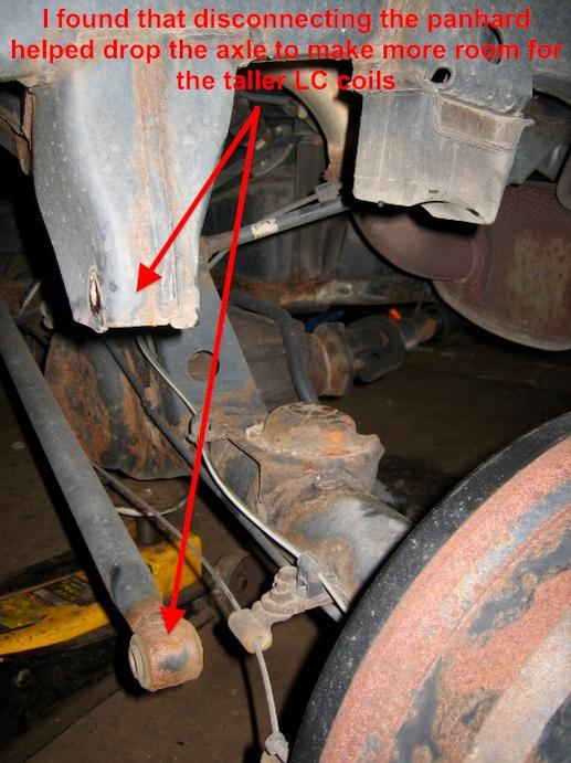

Correction, Thanks to cj80cruiser for pointing out that what I though was the stabilizer was in fact the panhard.
Thanks to cj80cruiser and 99yota4 for pointing out that the front Coilovers ARE NOT TRD but in fact just stock Tundra 4WD coilovers, which I def plan to swap out for some Tundra TRD 4WD Beilsteins in the very near future. Some " BEFORE AND AFTER" pics are coming next.
