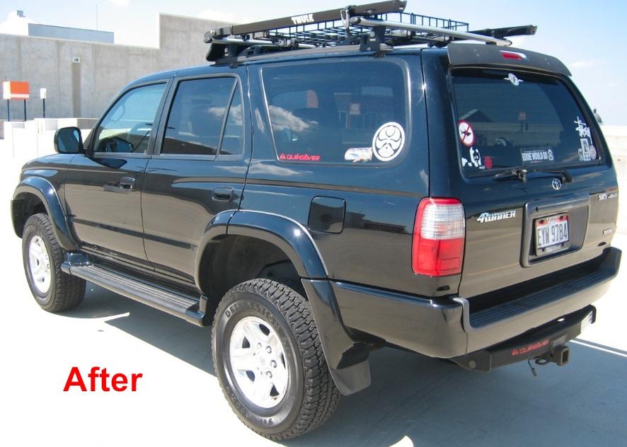

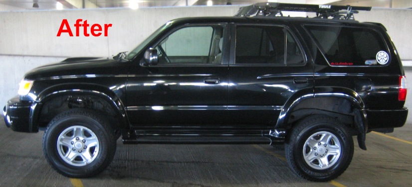

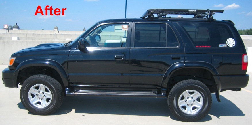

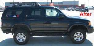

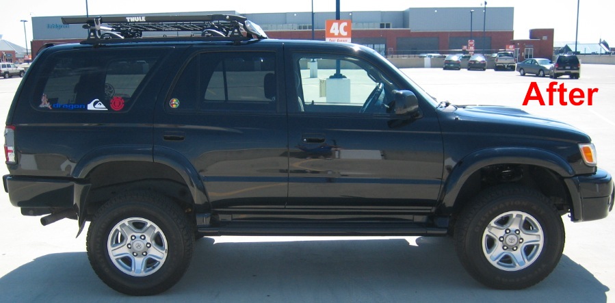

After pics!
Here's the "AFTER" pics. Should I put a new reply with the "Before" and "After" pics together on one reply post with side-by-side pics?
Thanks again to everyone here for all your help, especially Sam AKA Rockdawg84, Duhockey, cj80cruiser, 99yota4 and Mauzer for your expert and in-depth advise and communications.

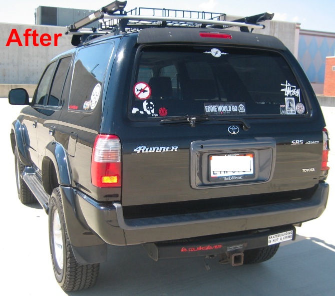

Your pics have swapped order. The second pic was labeled swaybar and it was the panhard that was the only one I was referring to....never said anything about the stabilizer. now it seems the pics are different but no matter. it was corrected and now you have good informative pics.
Yeah, after you brought up that good point I decided to research it a little further and decided to just change it up with the most correct info possible.
Please let me know if something else is missing or incorrect. I really want to try and make this as informative as possible. Thanks again cj80cruiser!

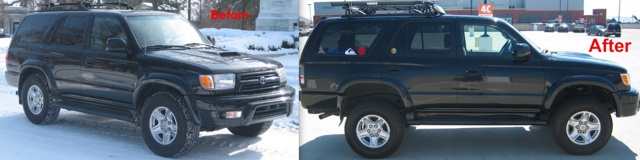

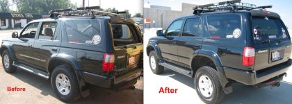

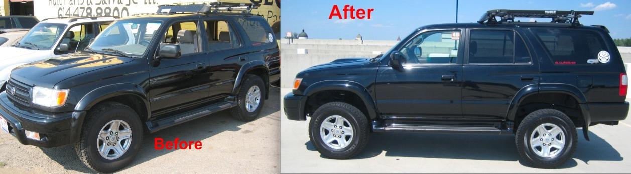

I'm not a fan of alot of rake but its not really noticeable even though you have a 2" front lift and a 4" rear lift. Is that what you ended up with lift wise? Looks really good to me. :hatsoff:

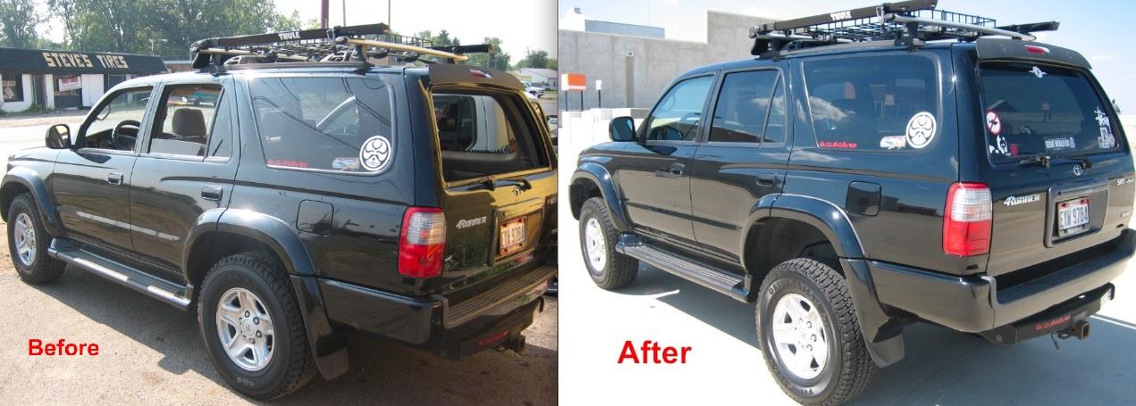

Yeah, I know but that's what I ended up with. I wanted the look of 99yota4's runner.
Like I mentioned before, my rear shock was busted and I was in a hurry. At least I got off my ass and got the lift done. Eventually I'll get longer front shocks/struts and maybe higher coils after that. And maybe some 33's might help a little as well.
I don't even know how to measure the lift. I guess I should've measured before and after as to make this post more informative. I feel like it's more like 2.5" up front maybe?
measure from center of wheel to edge of fender flare. We can compare that to known data...that's if you want to figure out how much lift you got.
