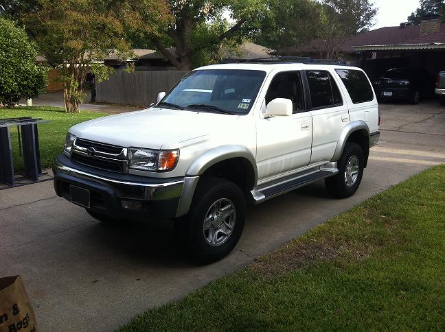

Before:

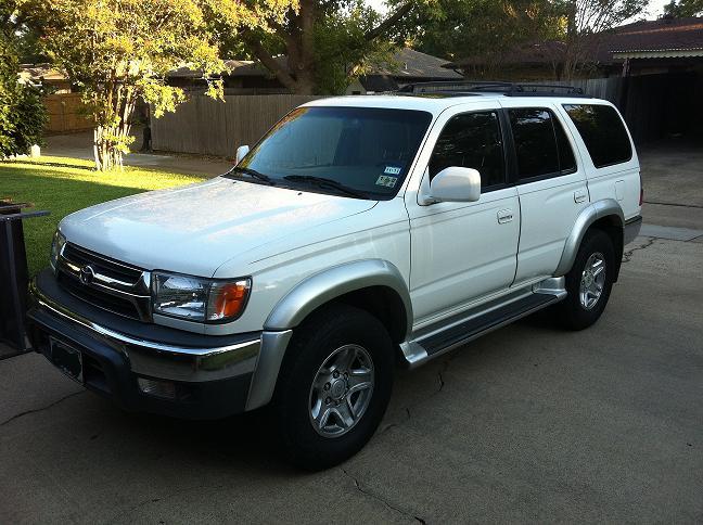

After:

Looks good! The tires are going to make a HUGE difference.
And what's the big deal for the gf? Mine is 5'2". I just made her hop up in there in the time between taking my running boards off and actually welding my sliders on. :thumb3:
I agree. Looks good. You should be happy with those tires in our area.

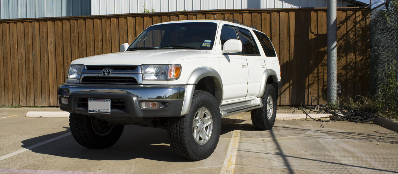

Also got my 285's installed today, pics to come.....:thumb3:
Dude my wife is 5"0" tall also, it is actually easier for her to hop in without the running boards than it was to crawl up and over them. Take the passenger side off and have her try it out. Only takes a few minutes to do?

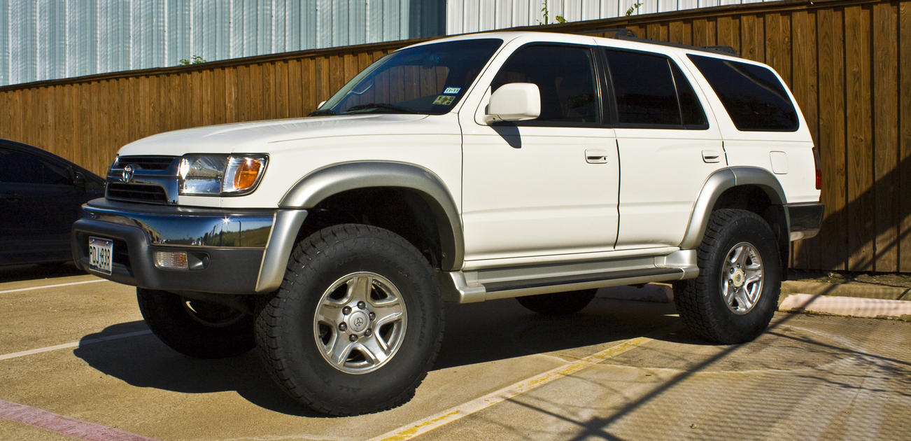

So here it is, not a fancy shot but just hanging in the parking lot at work......Little amazed how much it is higher it sits than what the pictures represent. Also I am happy to mention the tires are close to the UBJ, but have 1/2" of clearance, and i dont rub any of the fenders/flares.

So looking from the back end with the 890's having a height difference of 5/8", is it that noticeable?
Truck looks great nonetheless.
Thanks Man, Im loveing it, kind of like having a whole new rig....
Not at all, actually when i measured it up i had to double check, stand back, scratch my head, and measure it again. Really not sure what is causing that. I actually kept the "A" tag on the rear coil as to not confuse the location. Even double checked that.....it is beyond me why it sits lower. but to answer your question no it isn't noticeable.
