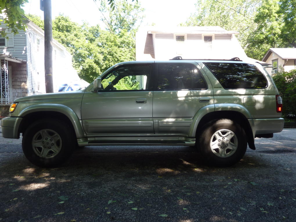

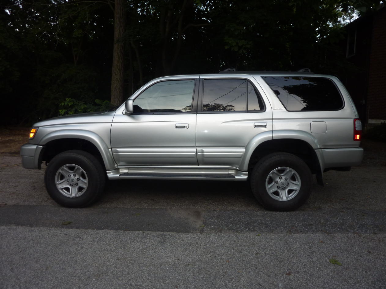

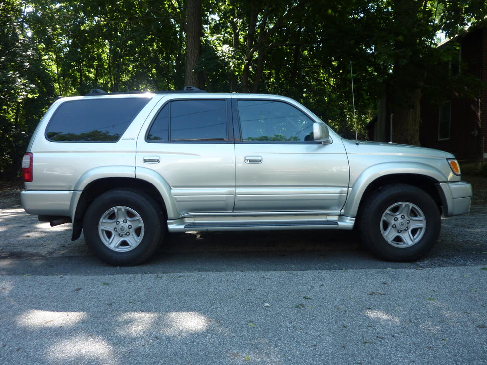

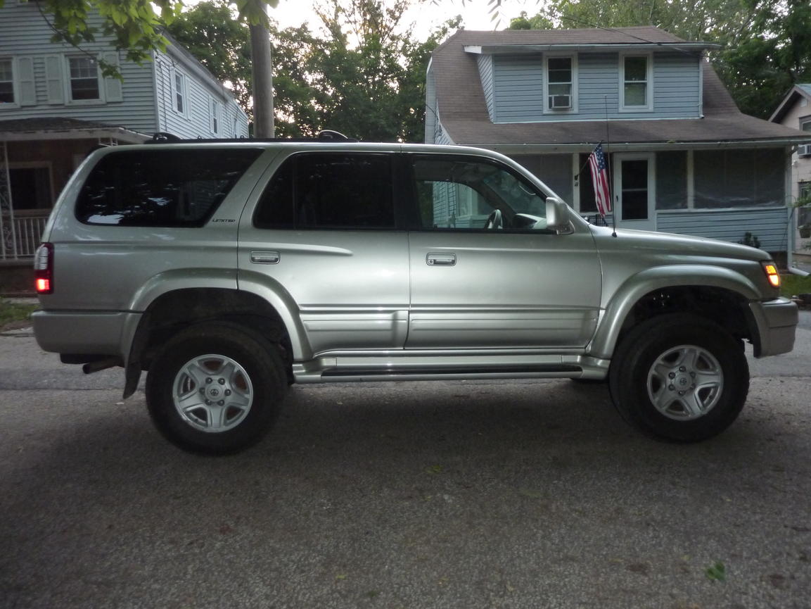

Took some before and after photos:
Before
After
I was at about 33.1/2" ground to flare and 20" hub to flare in the front both sides and about 34 1/8" RR, 34 1/2" LR ground to flare, 20" RR, 20 1/4"LR hub to flare before the lift.
After the lift, I was at 36 3/4" ground to flare and 22 1/2" hub to flare in the front both sides and 37 1/2" RR, 37 1/4 LR ground to flare, 23 1/4" RR, 23" LR hub to flare.
Comes out to about a 2.5" lift in the front and 3" lift in the rear. Pretty much what I was hoping for. Did a lot of research on this forum which helped tremendously.
