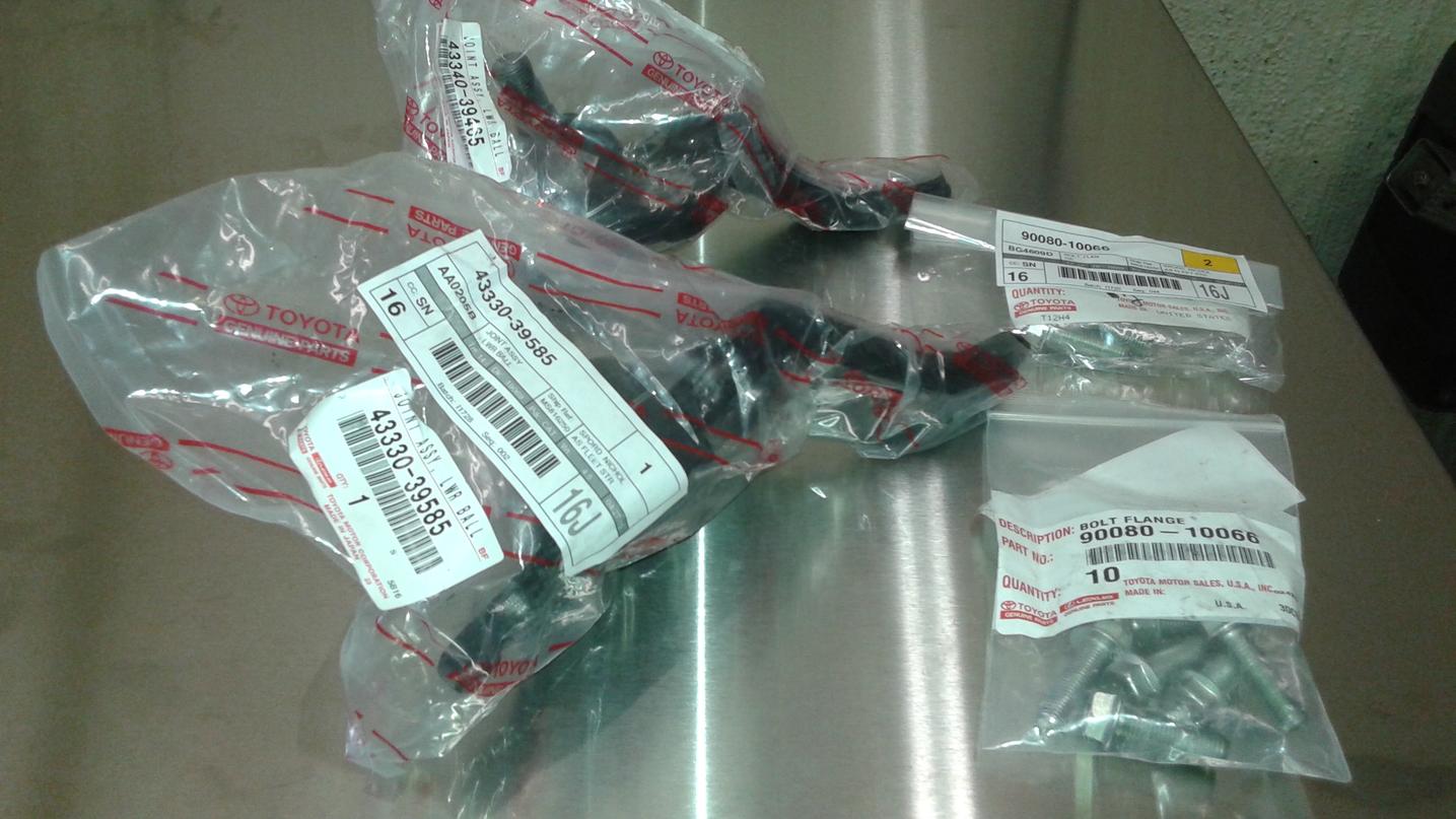

Bit the bullet and ordered new LBJs from camelback today. With their free shipping it came to $178 and change. I almost ordered the one Lowrange offroad sells but with their price plus shipping it was a $25 difference.
Quick question though....do the OEM lbjs come with new bolt or do I need to get them seperate? I didn't see them listed as a separate part on the parts diagram.
Guess I should have asked this before I ordered. :ybrick:
Also have ITRE and OTRE ordered. Ready for FedEx to come and get to turning some wrenchs. Lift is going on at the same time. :rockon:

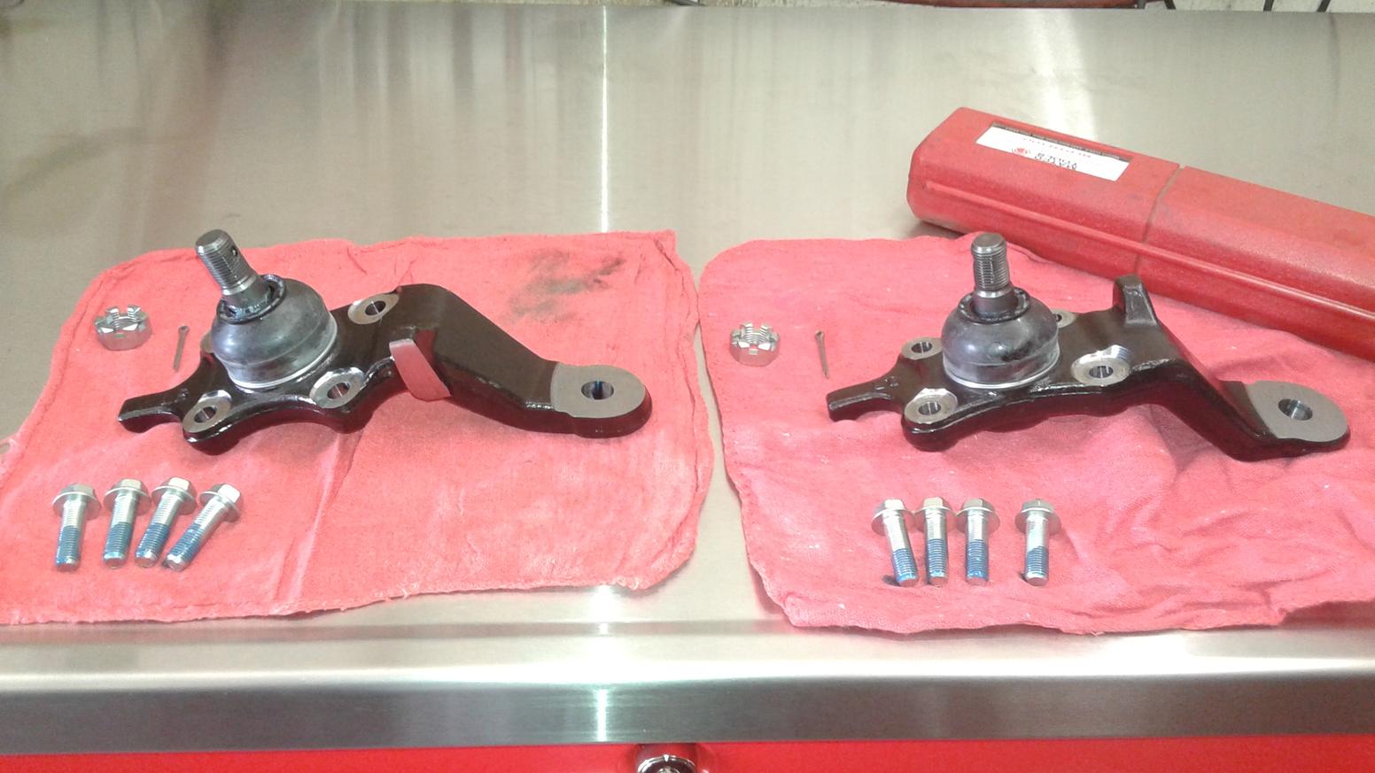

The 4 bolts for mounting the LBJ do not come with the replacement LBJs. You need to order separately, and it is recommended to use new ones (also at least use blue loc-tite on them).
as already clarified, the LBJ will come with the large nut and cotter pin to secure it to the spindle. The four bolts that are not included are used to secure it to the hub.
Just did mine today after work. As already mentioned, the mounting bolts have to be ordered separetly.
