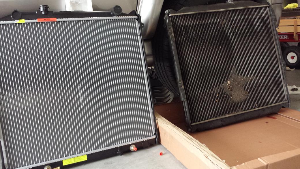

Tickets to the ticker tape parade when the Cubs win the World Series if you can guess which one is the old OEM rad? [emoji12]
Did the swap today. Coolant was super clean coming out, so didnt bother with a flush. Installed the Spectra rad, fit and finish was excellent. Thought it was odd that 2 qts of ATF came out. So kinda did a mini drain and fill there.
All in all, took about 2 hours. Hoses were a biztch to get off. Front grille took about 5 min to figure out solo.
Highly recommend this "mod". If only for peace of mind.

I'm not sure if you have Pep Boys Auto where you are, but around California they carry Spectra radiators. I am still planning to replace my radiator and have decided on Spectra brand, but will buy it from the local Pep Boys even though it's a bit more expensive. I figure if there are any quality or fitting issues — I can can just take it back and get another one.
Normally I have no issue with ordering parts online, but radiators seem to be quite susceptible to damage from crappy packaging and/or delivery guys who are in a hurry.
Also, Pep Boys often run good discounts on stuff. Right now you can order the radiator online and get 25% off the radiator with the code 25SEP50 this will make the cost around $115 and you can just pick it up in the store.
Autozone stocks this one, Spectra CU1998, in store for local pickup for $139.88 & 20% discount online which works out to about $112

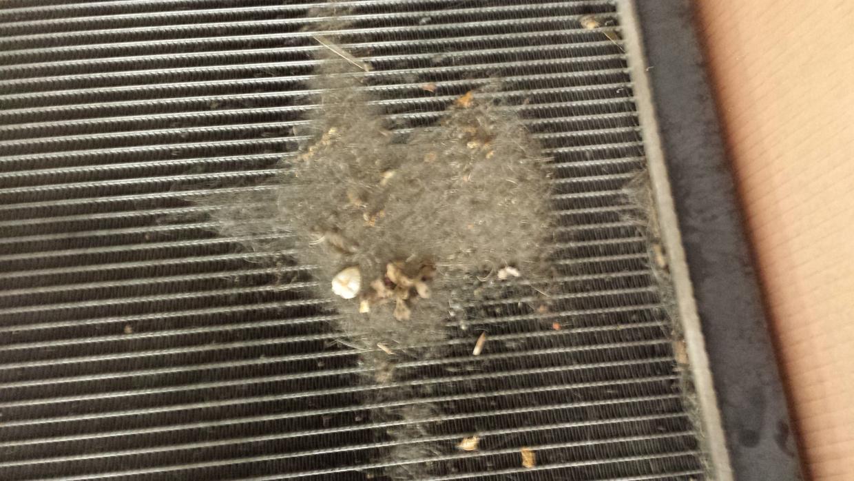

I think of it as a quasi mod. Hence the air quotes. Technically, its a modification to the vehicle. The OEM rad was perfectly working, albeit very dirty with insects from the last century.
Performance wise, I saw a negligible temp drop from pre swap, although it could be in combination with the blocked cooling fins.
It's more peace of mind than anything, and probably the best $200 I've spent on the rig yet. Next up, Viper alarm next week.
