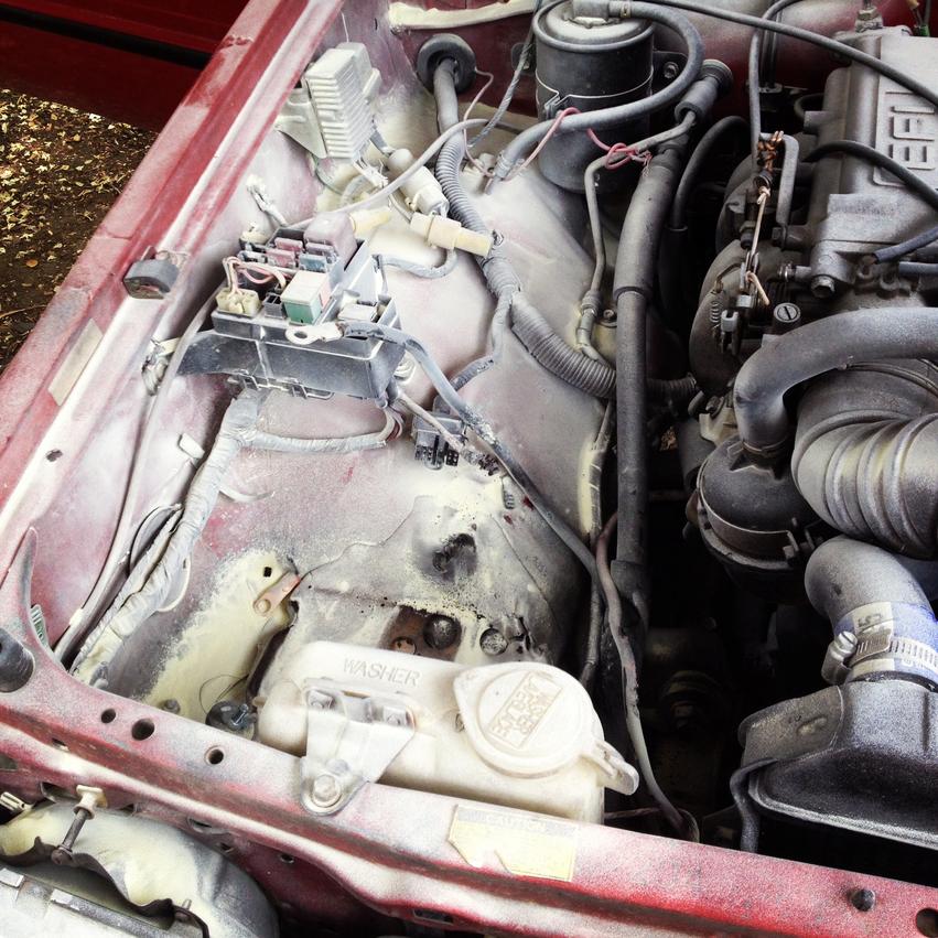

So yesterday I installed a generic battery mount braise when my mechanic installed my battery he forgot to mount it down. Some how upon installing my new mount I must have crosse a wire or something because 20 minutes down the road I experienced the strangest sensation. Well, my truck all the sudden shut off just before I pulled onto the freeway so I Directed her towards a nice place to pull off and assess the situation. While coastin towards the nice gated community I noticed the smell of spoke, plastic smoke! I quickly stopped the truck, peeled open the hood and located the problem. A good size flame was quickly burning through my new battery harness and along the wiring from th battery toward my block. I struggled and knocked down the flam using my favorite t shirt instead of the gallon of water I had on my passenger seat. Smooth move number one :) then I ran the security guad box of the gated community and retrieved his fire extinguisher!! Hit the truck the the extinguisher and disconnected the battery! Operation save my truck sucksess!!!

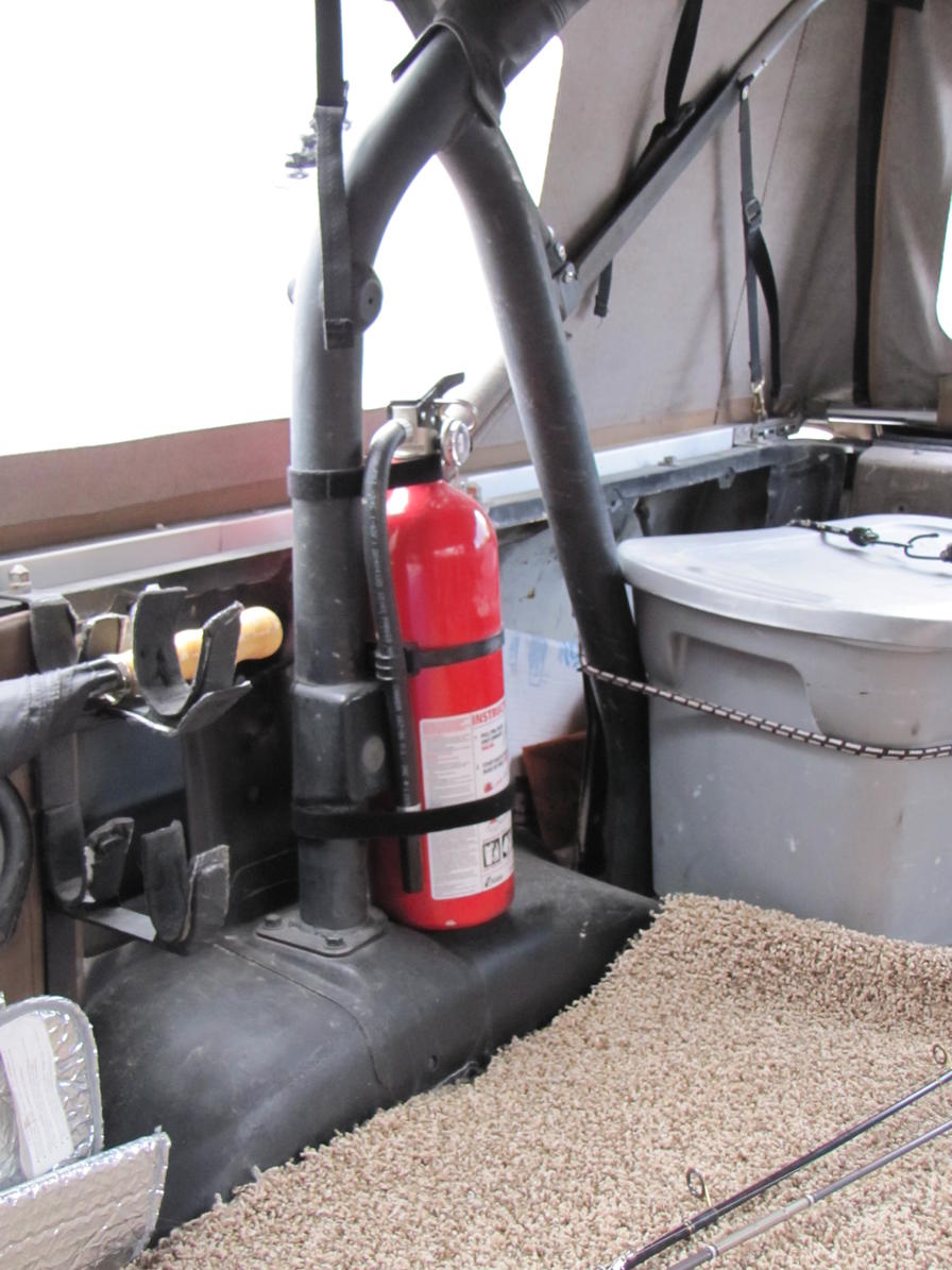

I keep 2 extinguishers in my rig. Velcro strapped to the roll bar, one on each side. Super easy access when my softopper is rolled up, as well.

My extinguisher is on my roll bar too. I need to find a better place for it, because with the hard top on there's no way to get to it quickly.

... A good size flame was quickly burning through my new battery harness and along the wiring from th battery toward my block...
By wiring from battery toward block, you mean this fusible link wire that's there so it will melt before anything starts to burn?
Was yours replaced with plain wire? Did you find out what parts shorted?
Sorry about the incident, but glad you and the truck are OK.
mostly all the wires coming from my battery were on fire but the positive heading towards my starter was the most severely burned. I would say no fuse was in place if I had to guess. Scary thing was the proximity to my fuel line!!!
UPDATE: Brought her back to the mechanic and informed him that he had not strapped the battery down. He quickly fixed it up. I will snap another photo of it as it is now fixed. I think the new wires to the battery are now upgraded :)
Yeah, I have no rear seats either, so access is real easy for me. My sides are rolled up 90% of the time once it gets above 50 degrees outside.
