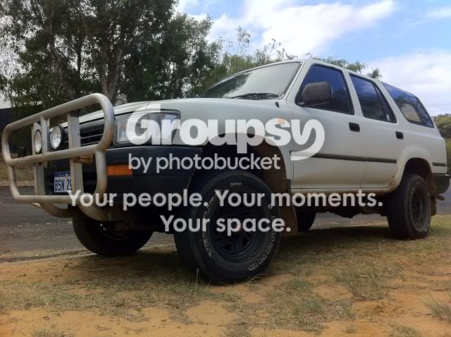

First of all should introduce myself as a newbie to the forum, and to Toyota or 4x4 ownership. I've been more involved in olf VW's up until yesterday when I purchased a 1993 4Runner 2.4L Manual 4WD. This is the car thats going to take me on my travels of Australia for the next 2 years!!!

Your speedo cable is mechanical, so not sure what the turn signals have to do with it. Crawl underneath, and you should see a cable going into the T-case housing from the passenger side. It may have worked loose, or someone had it off before and didn't reinstall it right. By the way, that's one heck of a 'roo bar! Best of luck, mate!
Cheers BucknutBob! Took it off road for the first time today, turns out they're pretty capable in the rough stuff and had a great time in it! Will check underneath tomorrow for the speedo cable. Is it a difficult job to replace do you know?
