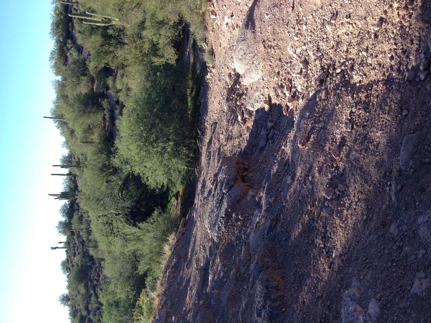

Pics from the trip. Sorry they are side ways taken and sent from my iPhone. This is that rock I barley made it back up. Taken from the top of the hill it does not look that bad. I should have taken one from the bottom as well.

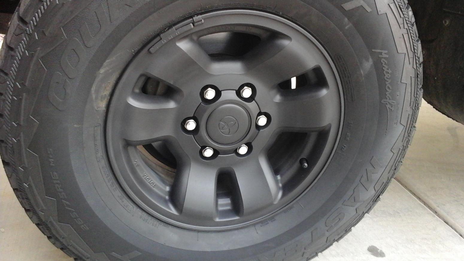

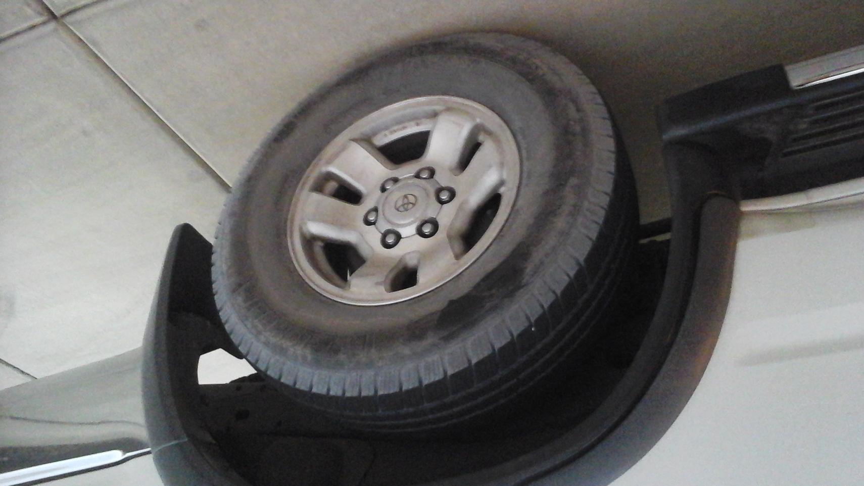

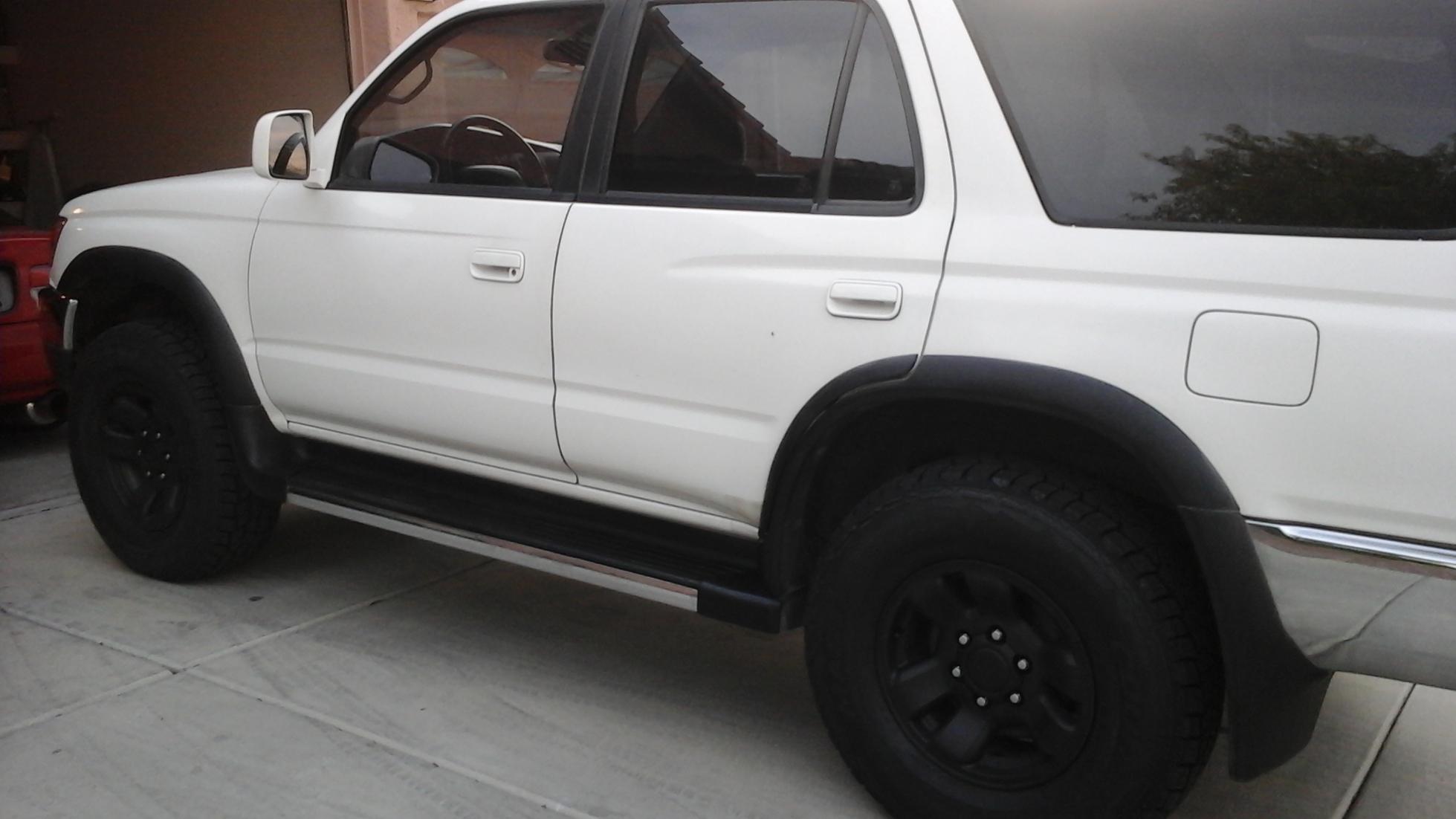

Today on the way to work my alternator and battery both decided to die on me :sobbing:. Luckly i made it to work and i work at a repair shop. So new ac delco battery and duralast alternator. I also got all 4 new mastercaft courser axt 265/75r17 nice tire and low cost $105 plus tax per tire. It was slow today so i figured while i had the tires off they coukd use a refresh. So i steam pressure washed the hit then with scotchbrite and did them in flat black plastidip. I love the rims in black i may need to make it permanent and paint them. :lmao

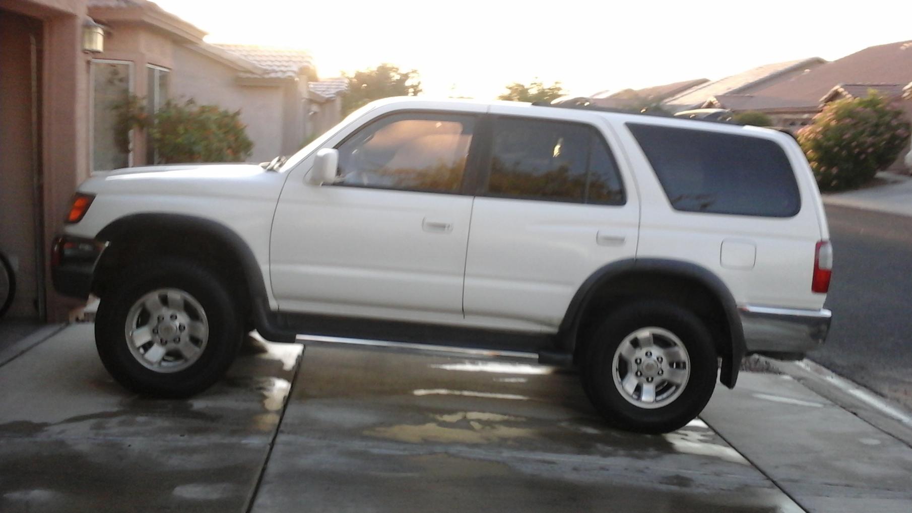

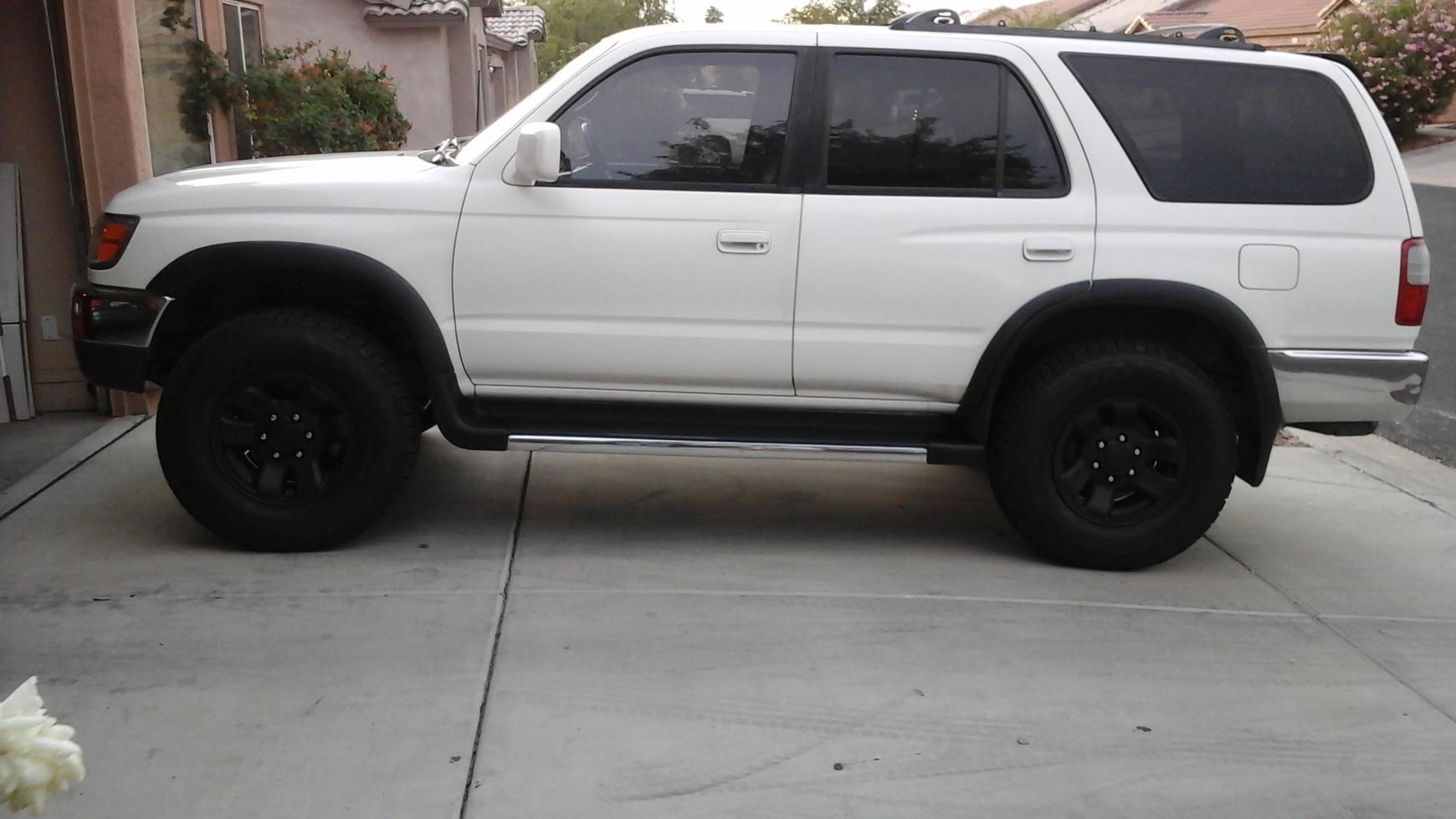

Now some pics cause we all love pics. Before and after
