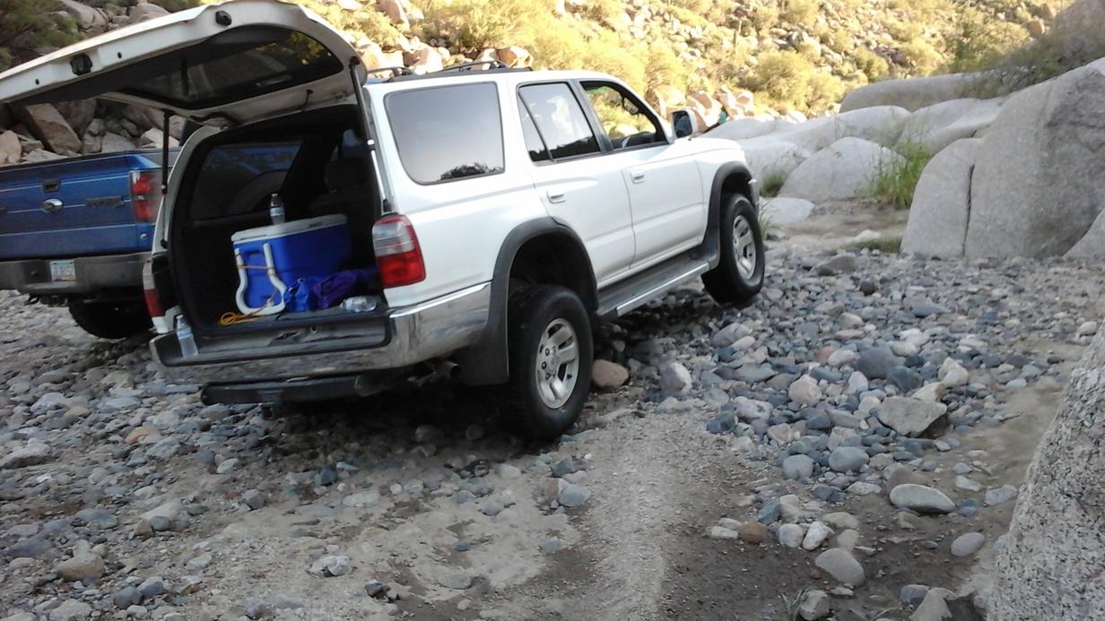

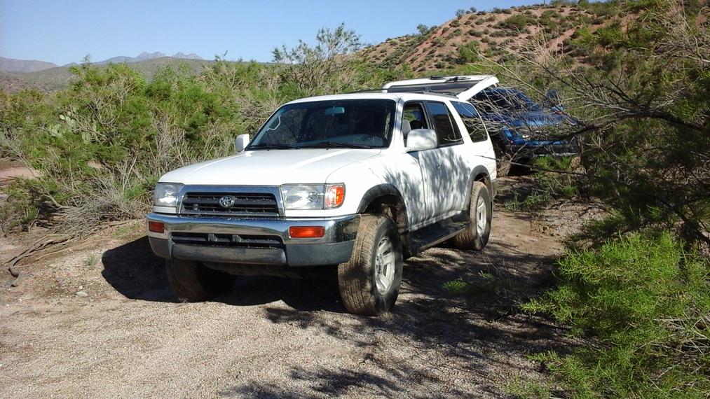

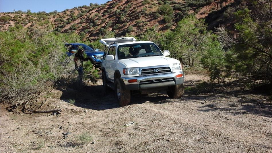

Went wheeling aways. Went down to scyamore creek a local wheeling and avt creek wash that is normally dry. However after the heavy rain yesterday the creek was flowing which was very nice. Got to play in some water and wet sand very soft wet sand. The 4runner did great only thing was a lound clunk or bang from the right rear went hitting a large po hole not or bump. I think it might be a bad shock bottoming out but i will check it out at work when i get a chance. Better tires would be very useful in the sand. Here are some pics from the trip hopefully they wont be upside down. I went with a buddy of mine, his wife and kids. Thats his F150 Raptor in the pics. My wife and daughter went with me so it was fun outing.

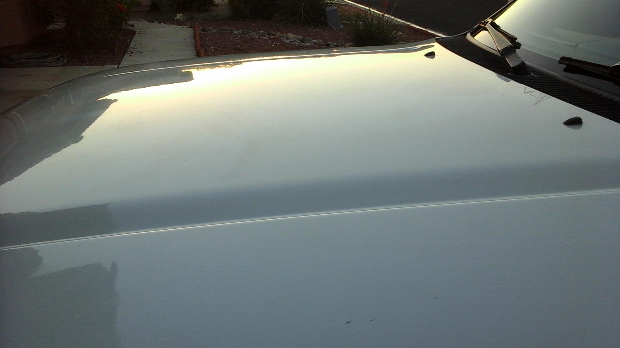

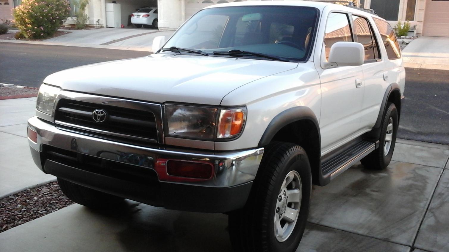

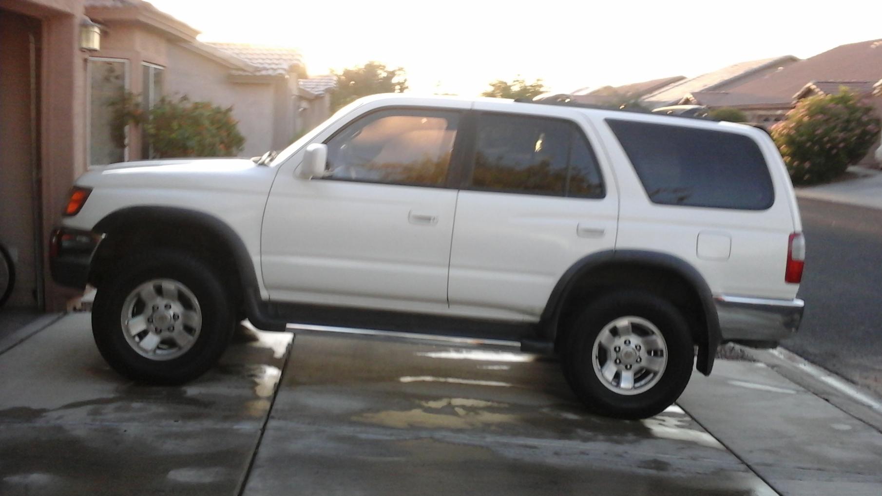

After the trip to sycamore creek the runner had a bunch of dirt sand and mud still under the running boards wheel wells ect. So i felt it was time for a good cleaning. After a trip to autozone for some needed cleaning supplies and 2 hours washing and detailing inside and out along with polishing and waxing the hood here are the results.

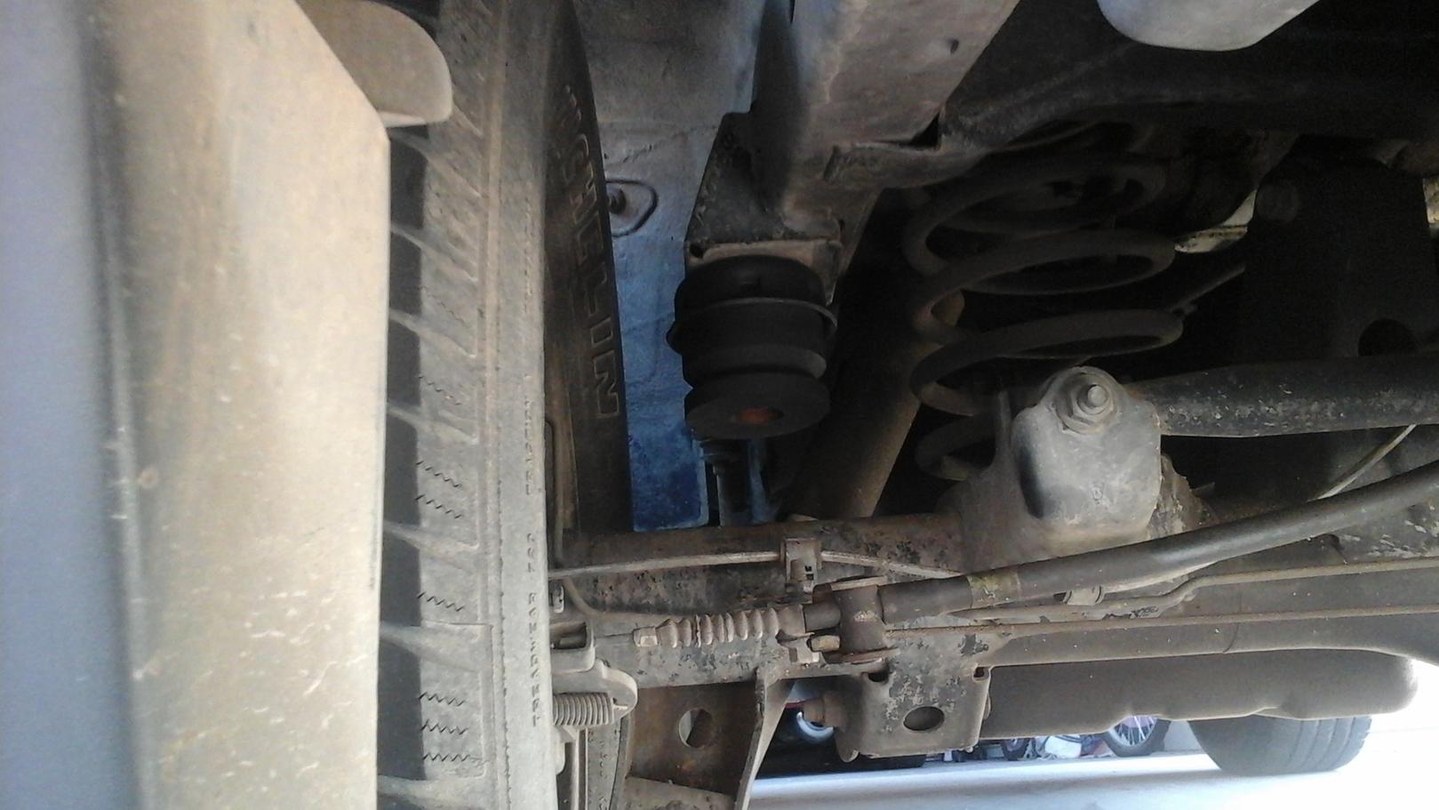

Went to the local pick a part yard today after work in search of so rear bump stops for my runner. I found an oldsmobile bravada but the bump stops were pretty rough. Walked down a little further and found a s10 blazer with some nice rear bump stops on it. New oem bump stops about $63 a piece wrecking yard blazer bump stops $17 with $3 yard entry fee. I wanted to look for an antenna that would work to delete the power unit but they were closing. I should be able to get the bump stops in tomorrow.
S10 blazer bump stops installed. They bolt right into the stock location. I did trim off the first section on each one. They were too long for the runner at dtock height.
