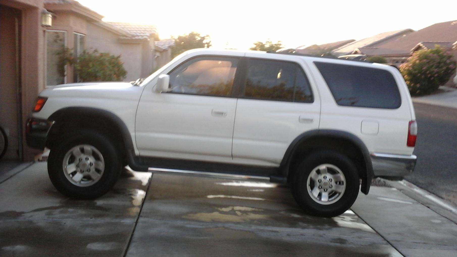

Hi everyone. New here and thought i would introduce myself and my new to me ride. Im Neal aka Az4Running im a mechanic and long time import sport compact lover and new to 4 wheeling. I also have a 1998 Civic Hx with a Ls Vtec swap and bolt ons ect. My new toy is a 1997 4Runner SR5 4wd 3.4L white with stock running boards totally stock 255xxx miles. Its super clean inside and out, does need a cleaning inside. I got all history on it back to 2007 and it was well maintained. Only had since friday so 2 days now. It runs and drives great. Took it an easy trail today that is close to my house, Butcher Jones if anyone is in Az. Did a good off roading test on it and tested the 4wd. All went well. It does need a new brake master. Pedal goes to floor under heavy braking. Thats was not so fun going down a steep rutted hill! 4 wheeling is pretty dam fun.

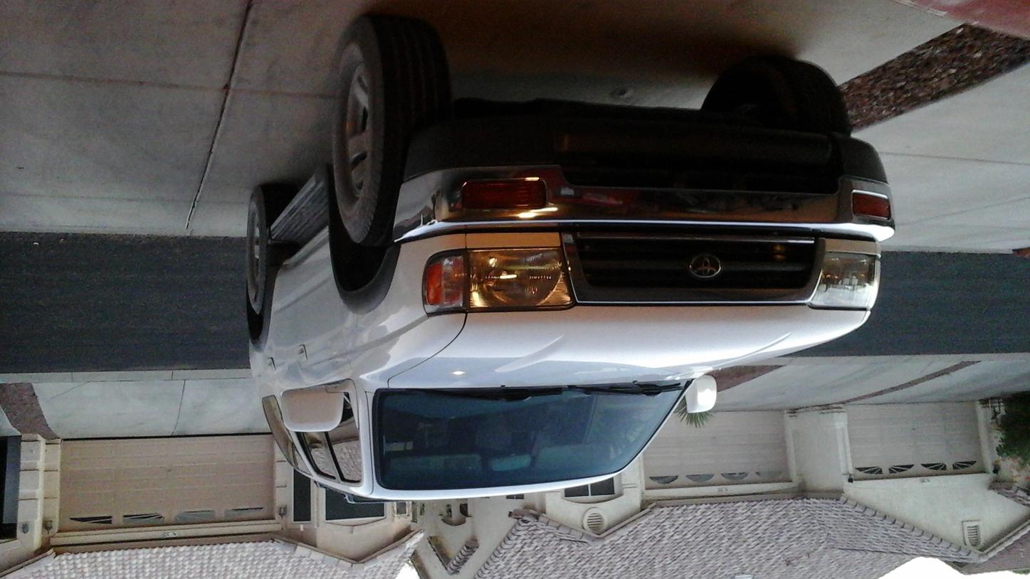

Pics posted. Fresh from my first mild off road adventure. Dirts and rock marks on tires. Yeah! Sorry dont know why the pics are upside down.
Did i mention i stole this at only $850.

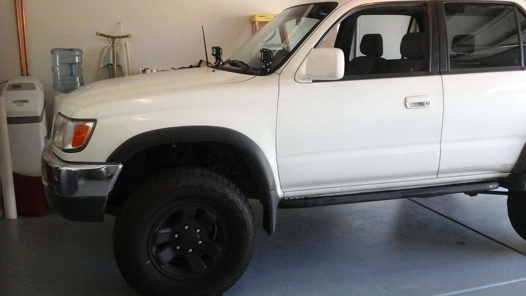

Updated. Pics on when i first got her and present
