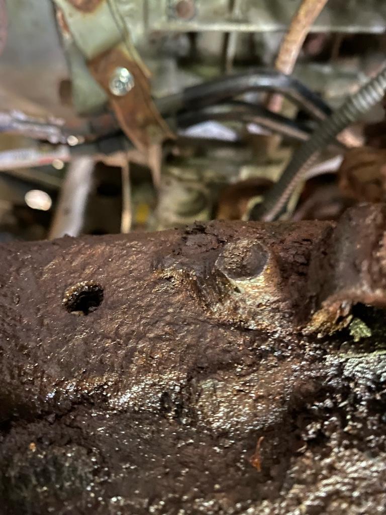

Ran into this little 12 mm bolt on the ABS bracket… any tips? I can’t even get a 12 mm socket on it.
Try and remove as much of the rust as you can from the head of the bolt using picks, screwdriver and wire brush, etc. then apply some heat with a propane torch to the bolt being careful of not overheating any brake lines, etc., then tap a 6 point socket onto the head with a hammer and then try to remove it, if it does turn a little bit then tighten it some and then try to loosen it some more then tightening it, rinse and repeat until it's removed and throughout this process spray it with a good penetrating oil, what you're trying to do by loosening and then tightening it is to break up some of the rust in the threads and flushing it out with the penetrating oil, you very well may end up breaking the bolt if the rust is as bad as it looks but the way I described above is the only way I can advise you to possibly get it removed.
It's important that you use a 6 point socket on bolts and nuts that are as rusty as that one because they have more surface contact with the hex head of fastener, a 12 point socket will usually round the head of the bolt/nut when they're that rusty.
If the socket slips and rounds off the head then the only thing you can use then would be most likely a pair of Vise-grips.
Edit: Anytime when using a propane torch working vehicles be sure to have a fire extinguisher handy in case something that catches on fire and gets out of control you can put the fire out before it does a lot of damage.

How long do you wanna heat it? I did about 30 seconds. Can’t get a socket to stay on. Vice grips don’t want to work either. I am thinking about drilling or using a nut splitter. Stinks that one little bolt has got this project at a standstill. I can’t get to the UCA bolt without removing this abs bracket.
You can heat it until it's glowing red IF there's not anything else that's going to be an issue when getting it that hot, usually the hotter you can get it the better to help loosen the rust, just an FYI the area you want to heat is the area with the hole, not the bolt itself, what you're trying to do is expand the hole to loosen it's grip on the bolt.
If heat doesn't help then I would go with removing the head of the bolt however you can, drill it, grind it, cutting torch, etc., a "nut splitter" will only work on a nut, it won't do anything on removing a bolt head but deform it.

I was trying to heat the bolt itself and not so much the hole. I’ll try that again tomorrow. But should I even bother since I am struggling to get a tool on the bolt head?
I couldn’t tell if there was a nut on there or not, it’s so mangled lol.
Any preference when it comes to drilling, grinding, or cutting torch?

From your photo it does look to be a bolt, but not seeing in person I could be wrong but I don't think so.
If you can get at it with a drill that would be the fastest, drill in the center of the head with a bit that's as big or bigger than the diameter of the threaded portion of the bolt, once you drill through the depth of the head of the bolt it should pop off if not hit it with a hammer and chisel to pop it off, later you will need to drill out the rest of the threaded part and then run a tap to re-thread/clean out the hole, use a bit slightly smaller then the threaded part.
So the biggest problem is that you can’t get a socket to stay on?
You may want to try like a stripped head bolt remover - they have sets you can get for $10 or so
Otherwise could try seeing you can hammer on a 7/16 socket or 11 mm socket
Once you get the socket on again go gently tighten loosen etc otherwise you may break the head off and you’ll have to drill anyhow
You can also see if you can jiggle the bracket under the bolt back and forth to see if it’ll loosen anything

Yea can’t get any socket to stay on, even the Irwin bolt grip won’t. There’s not enough bolt head left. I will try moving the bracket and see if anything move. Thanks for the tip about the FB group!
Decided to bypass the AbS bracket for now and use a 19mm wrench to get in there. It was a bit rough, but got the UCA nut off. Now I am trying to figure out how to pull the long bolt out on the passenger side. You can pull it almost out but then it hits a metal line going to the radiator. Tried bending the line slightly but still wouldn’t fit. Don’t wanna bend that line anymore than I have to.
