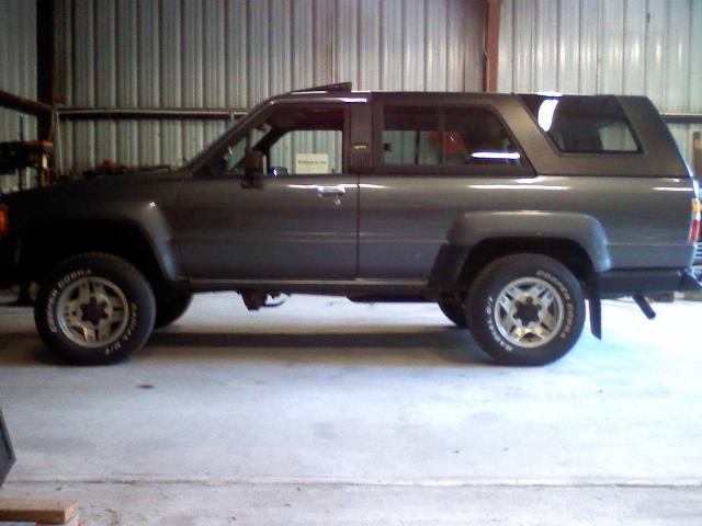

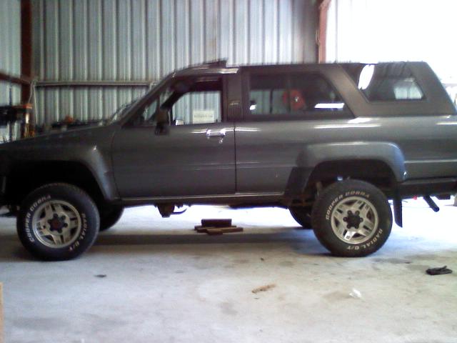

Spend some money. get your factory springs re arched (tell the guy how much taller you want to ride) and have them add a few leafs. buy some quality shocks.
This will cure your sag, improve your ride, in crease load capacity, and add suspension travel. I used Rancho RS 5000 shocks. I think I'm in $250 but it has added capability beyond just looks.
here is before and after pics.

Search for the ZUK mod. I did this a few months ago and am very pleased with it. I want to say I'm into the mod for ~$80 and a few hours of labor.
I'm not so happy with mine. I used 125 pound 14 inch springs, and they set my back end way too high, without actually increasing my load cap at all, I still sag when I'm loaded for camping. Very soggy things, too.
When I have the money to do it right, I'll re-arch with an extra leaf, or buy OME.
