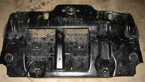

P.S. They sure did equip your 4runner with a nicer skidplate than they did mine.:D
