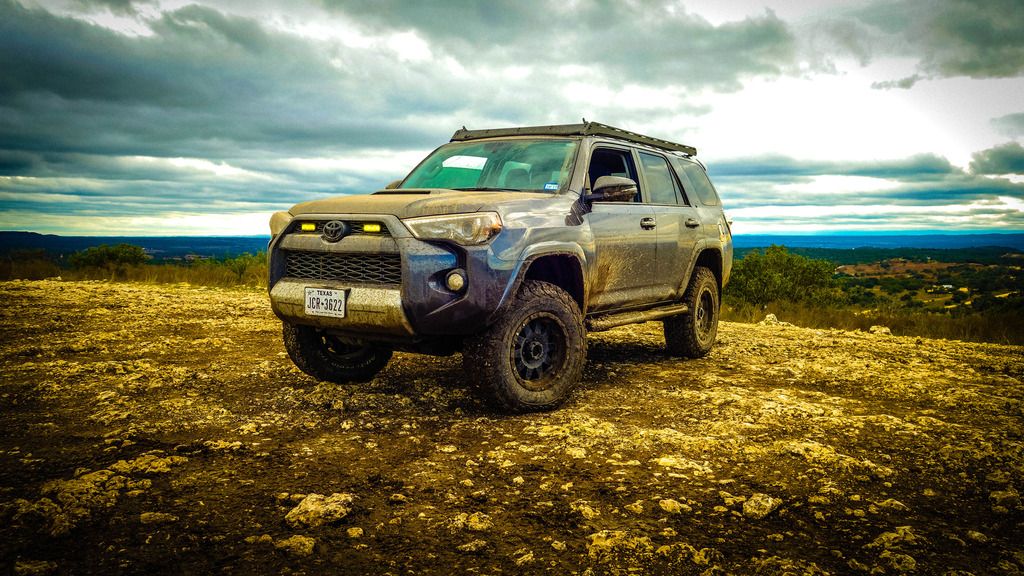

Hello all. I am new here but I have been around forums and modding cars (mostly BMWs) for quite a while.
I thought I would reach out to the community for some advice after conducting a lot of research and search function use (and waiting for it, 15s, c'mon!)
I have a '15 TEP. I plan to get the new ARB (heavy AF) bumper and winch set up early next year and I an pretty sure my OEM suspension with spacer lift isn't going to cut it. It rides fine now but thats about 200lb on the front of the rig. My truck looks good now but I think the front could even come up a tad as is. That bumper is going to make it sag and handle like crap. I also want to get the CBI rear bumper which is also pretty darn heavy, with drawers back there too. This will happen over the course of next year.
My rig is a DD/weekend overlander with say, a trip a month, lots of hwy and some offroading, possibly pretty challenging trails. I want to be pretty capable offroad if needed. It will see some moderate loads for longer trips. I have the Prinsu roofrack and may end up with an RTT soon.
I have my eye on the 6112/5160 kit from Bilstein lifts but I have a few questions:
https://bilsteinlifts.com/shop/toyo...lift-kit-2010-2015-toyota-4runner-fj-cruiser/
Is there a better option at this price point? I like the big shocks up front and remotes out back, thats more robust that toytec adjustables. I hear Icons are about on the same plane as these and many reports of issues, though many glowing reviews too. I could probably afford kings and TC UCAs but thats a big purchase. Not sure if its worth x2 the cost, unless they last twice as long?? Input there would be great.
Also, Bilstein says the lift is a 2.5" lift. I would like to net more like 3" after the ARB bumper is installed. Is it possible to run the same spacer I have now (revtech 1.5 i think) and set the Bilsteins acordingly to net me 3? (not sure if that's ridiculous or not.) I have no issue getting UCAs, my research tells me that is required for a decent alignment which I wont compromise on!
Thanks in advance fellas! I look forward to your input! :reddance:

Could you give me a little more info of what you're currently running. I can see the spacer lift, but what shocks/springs? All stock, aside from the spacer?
If you've updated the front shocks and springs already, all you may need is a heavier spring up front. I wouldn't do anything to the rear until you've ordered your rear bumper or rtt. But even then, all you need is heavier springs if you've upgraded the shock already.
If you're dead set on the 6112/5160 lift, be aware that the 5160's are on back-order until late march. Doesn't matter who you order from because, Bilstein ships their shocks direct from their distribution center.
My current set up (installing today and tomorrow) is the 6112's up front, and ICON 2.0 rears. I don't have any weight up front, so I went with the springs that came with the 6112s. For the rear I have Wheelers T12s (should net around 2" in the rear) which are 10% stiffer. I've added Metal Tech's 2" rear bumpstop extentions due to the added height. I don't carry much weight, so a 10% increase should serve me well when I'm towing or carrying my biking gear.
I'll let someone else chime in on more specifics, but for simplicity's sake, I think Icon's stage 2 with their overland dual stage rear spring would probably fit your needs and not break the bank, but you get what you pay for. Kings are sweeeeeeeeet.

Its all stock except the spacer, im pretty sure the dealership pops them on the TEs for "marketing reasons"
Didnt know that about the backorder, supposedly guys are having issues with them anyway.
Icon looks very sweet, might be the way, or just an OME medium setup at the time of bumper install.

First off. you need to find me and some of the other local guys and check out our setups in action on difficult terrain. Your picture made me realize you were at place that I frequent. I think I have done every trail there (even the crazy ones).
I highly recommend getting real life experience with different setups and see what they do side by side. This will really open your eyes compared to listening to us wind bags here.... You will quickly learn what works best by simply observing.
I will say don't skimp on the suspension. It's something you will use everytime you get in the truck and saving $500 is just not worth it, especially when you are buying 4k worth of bumpers... skimping on the suspension is just not smart.
It's tough when you are installing all that weight. You have to put on springs that simply ride like crap until you get it all on there. I would recommend 700s up front and an overland /heavy set of spring in the rear. Dual rate are nice... UCAs are mandatory in my book. I've seen so many people waste their time and money trying to skimp on this stuff. They all seem to end up with the right stuff in the end, so why waste your time and money.
Also ask yourself a thousand times if you really need the weight of those bumpers. It brings along many downsides...
