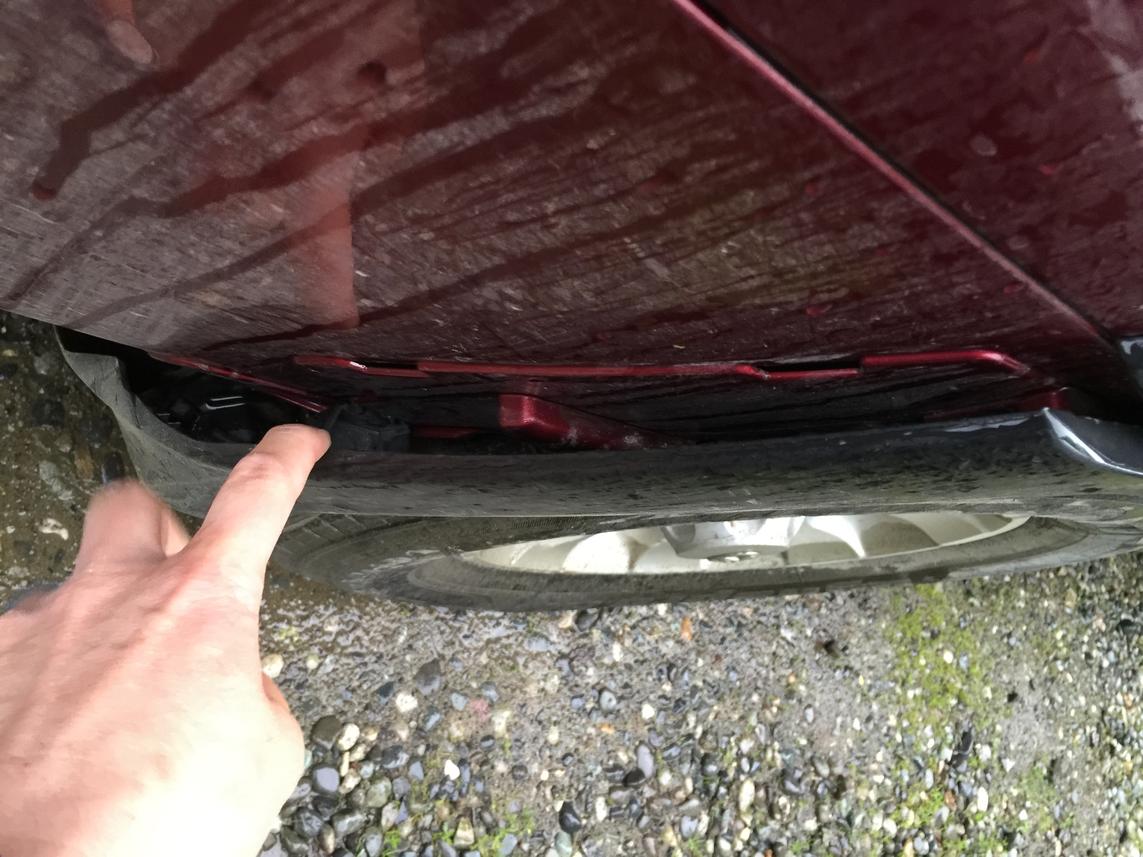

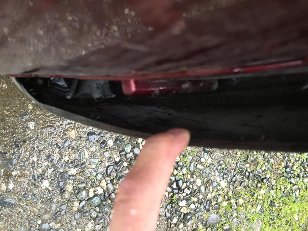

I couldn't wait to get my lift, wheels, and tires. Went for a little excursion today. Ended up smashing my fender flare somehow. All the clips broke and the plastic clip that is fused to the fender cracked off too. Dang nab it! I should've known better than to wheel too soon.

I'd pull the fender flare off, inspect the damage (might need a new one if the supports on the flare are damaged) and get a handful of new one-use clips and reinstall it.

Ended up FINALLY finding the time to fix these tonight. Had to melt the plastic tabs back together onto the flare and add new lock clips to the front. I took this time to remove my rear fenders as well.
I'm happy with the turn out.
