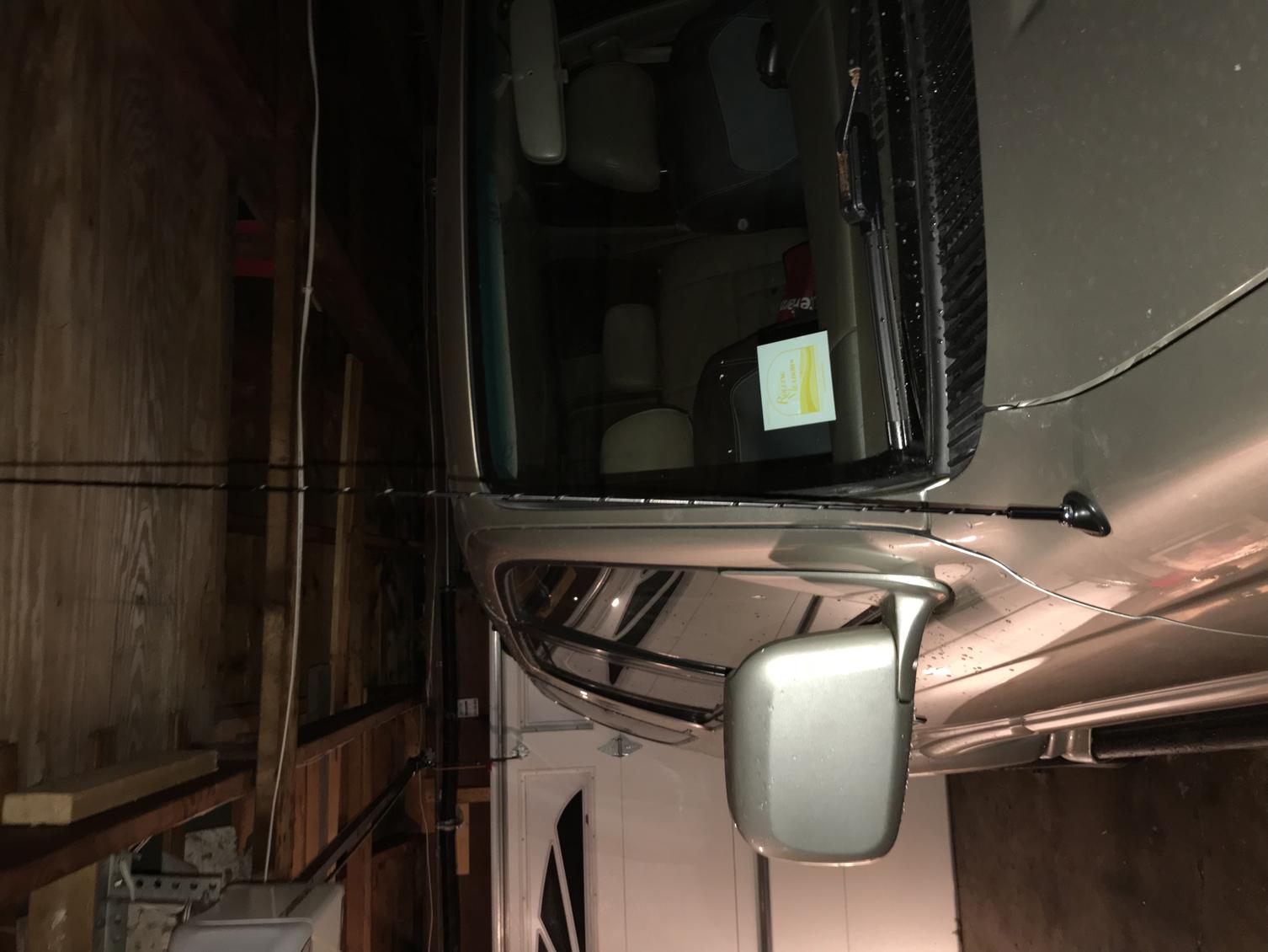

Holy Mother what a pia!! It took me about 4 hours but I got it done and reception is decent.
I don’t have to hear that stupid motor any longer now.
It was difficult because of the fender flares and the black protector stuff. I only need to get 2 of the fasteners. It’s a little wonky but once fasteners are in it should settle back into place.
Thanks for all the help.
