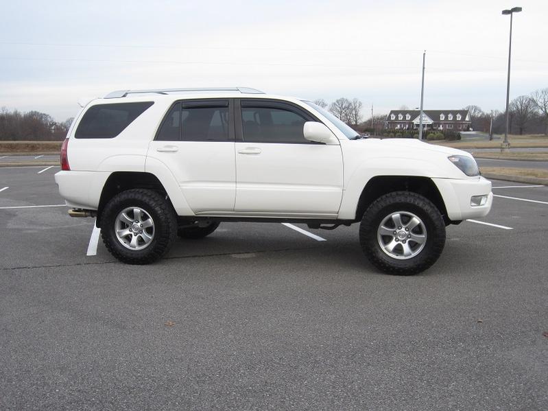

This much.. I'd say about 2.5 inches..
IMAG0032_2.jpg~original
IMAG0030_1.jpg~original
So even with the fj coils and the 5100's at max setting it wont be any higher than the oem suspension with the 2.5 daystar spacer?
I believe using the bilsteins with stock springs will net you 2.5 inches, so if the FJ coils are taller than oem you should be able to ad that plus the 2.5 to give you your approximate lift height.

  • They do not offer 2.5" of lift. Here's why: most of the lift in any lift setup is from coil strength and while the FJ coils are stiffer than the stock 4R coils, they are still soft. Which means, they will not provide the full lift. It would depend on each vehicle and what weight you are carrying, but in my setup, I got at the most 1" out of them (I do have a lot of extra weight).
  • The photo posted above does not look like a full 2.5" lift to me. 255x75x17 is a 32.5 inch tire, and with a 32.5 inch tire and 2.5 inch lift, you should see more wheel well gap than that. Unless folks can show actual measurements of before and after, I highly doubt the FJ coils provide that much lift.

This is stock height so you may be right. I know I measured but can't remember the results. But I do think it's close to 2.5 inches.. This is with no spacers.. just FJ coils and Billies..
Then... stock on factory size tires..
2013-01-26_13-20-41_205.jpg~original
Now... With the 255s
IMAG0026_1.jpg~original

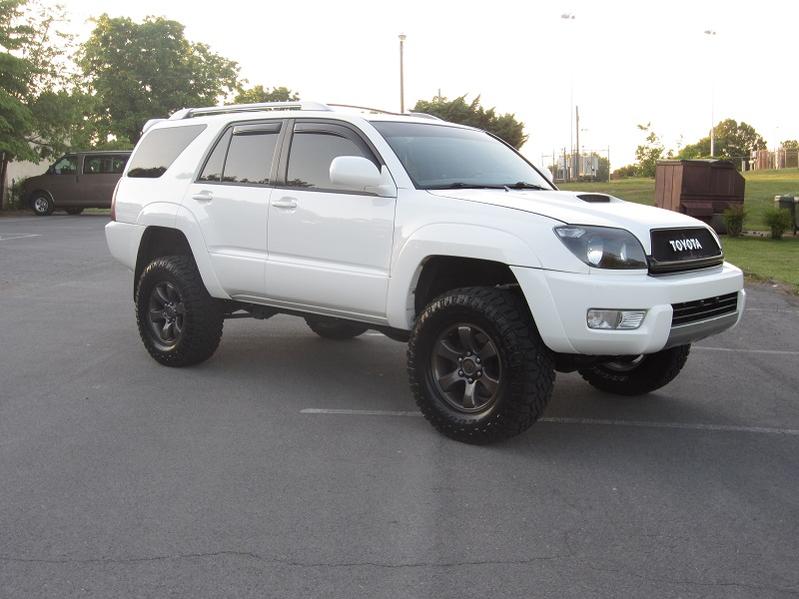

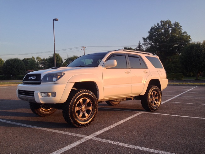

So I have Billies at 1.75 in front. With a Daystar budget boost on top (2") and FJ springs. Toytec Superflexes in rear with a 1" spacer on top. Its Frankensteined!

I'm in for pics too! How does it ride with the spacers on that high of a setting?
I have pics everywhere, but of course not in one place.
Rides great to me!
