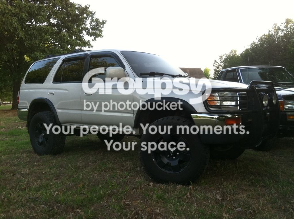

Did you do a body lift?

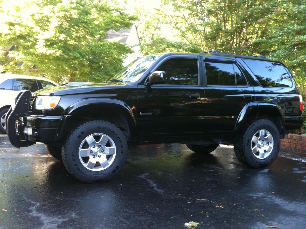

And thats what my 4runner would look like with those rims, except i run 265's at the moment.
Did you have to trim the wheel wells and is there any rubbing with 285's? I would prefer to not lift my vehicle since i only go on dirt and gravel roads here in alabama, so if i can use these rims with 275/70 id be a happy camper. Im trying to keep the look as stock as possible, with a few changes/mods.
Did you have to trim the wheel wells and is there any rubbing with 285's? I would prefer to not lift my vehicle since i only go on dirt and gravel roads here in alabama, so if i can. use these rims with 275/70 id be a happy camper. Im trying to keep the look as stock as possible, with a few changes/mods.

I don't have a body lift on mine. Just 2.5" suspension lift. No rubbing on mine with the 285's. Haven't trimmed anything. Hope this helps
