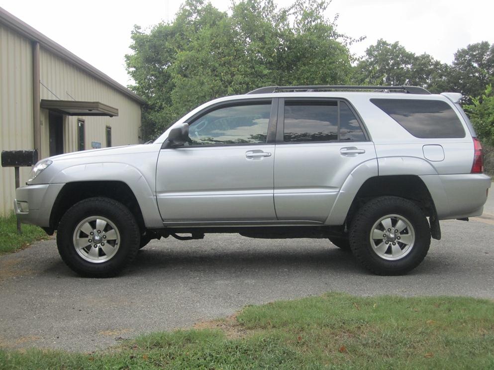

That is the exact upgrade path I took. I bought the Daystar front and rear kit and picked up a set of FJ shocks and coils (off road package Bilstiens), and did a mass swap. It improved the handling, raised it just the right amount, and in my opinion gave it a better ride. One of these days I'll post up some pics.
Just wondering, I am planning on doing the suspension swap to FJ as well, but how hard is it to DIY?
