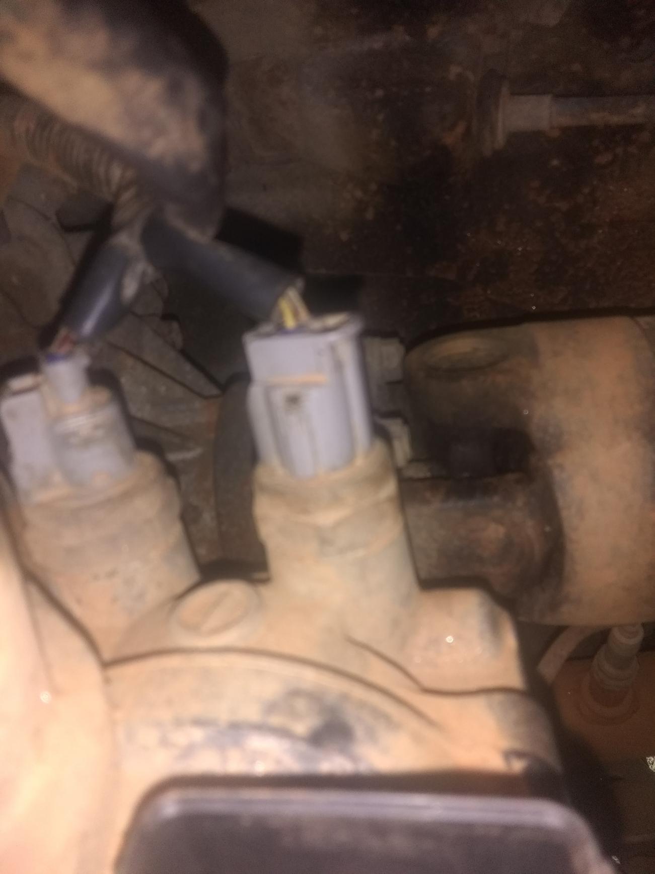

So I am having the blinking light issue on my 2001 4 Runner, after reading this thread as well 99SC's thread over at YotoTech, I was excited to pull the switches off the actuator and test those fully expecting to find my problem there, only issue is after a hour of trying to manipulate the wiring harness off I cannot seem to get it to budge, I have inspected, pulled, pushed, and squeezed everyway possible I can think of, anyone familiar with these and how they come off before I turn a 5 minute inspection into a half day wiring nightmare?

There should be a squeeze tab on the connector. They get pretty gunked up so try spraying some brake cleaner in there and working the tab while pushing/pulling on the connector.

Yeah that is what I thought, will try the brake cleaner, I have went all around this thing, squeezing anything that resembles something protruding, sticking a small screwdriver inside the holes, nothing, they may just be aggravatingly stuck and the brake cleaner may loosen, I cannot imagine them being this complicated with the success of so many people testing these without issue on their end, I am cursed whenever it comes to me and maintenance, lol.
Thanks for the suggestion.
Gotta find the tab, press the back side of it and do LOTS of wiggling, rocking, pulling and pushing. There is probably a lot of built-up grime in the connectors.
I have spent longer than I'd like to admit on those connectors myself...
