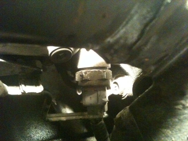

Here is a picture of the sensor location:
"The sensor on the front differential is close to the ADD can on the differential. It is just to the passenger side of the top center of the diff. There should be a small wire harness going down to it with the plugin."

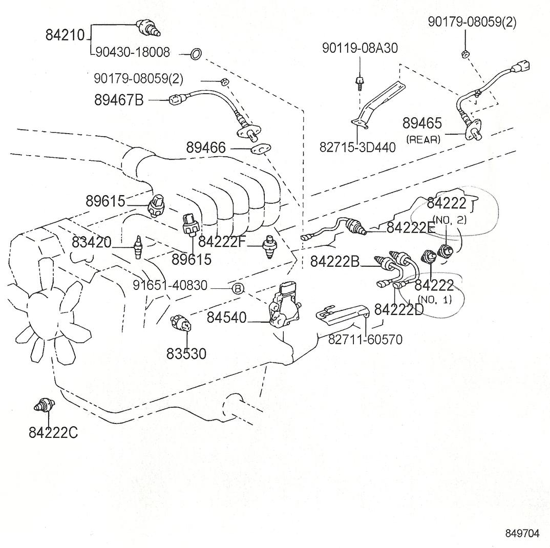

So I followed the thread that Doug posted over on yotatech and ran into a problem. The front diff sensor he replaced (part #84222-35070) fits 4runners manufactured up until 8/2000. Mine was made in 11/2000 so that sensor doesn't work for me. I went to the local dealership and that's what they told me. Apparently there are two sensors on the '01 plus models that do the same job. I was able to get the part numbers and a diagram of where they go. It isn't very help full and I was hoping someone on here knows more info than I do and can help me.
Sensor #1 is part #84222-12010
#2 is part #84222-35121

Look at Josh's picture up above even though it is upside down. You just need to remove the front skid plate and then look over the front axle by laying under the 4Runner behind the front axle on the driver's side.

Have you read through the whole thread yet? I'm working on solving this problem on my '01. The thread on yotatech that it linked a couple of posts up is really helpful. If you see the diagram I put up, I'm replacing the second sensor today (marked no. 2 on the diagram). I already replaced the no.1 sensor and I believe they both affect the indicator lights.

Your best bet is the nearest toyota dealership. The part numbers are in an earlier post. Should be about $150 for both sensors.
Update: Got both senors changed and the lights are still flashing. I can shift into 4hi and 4lo, everything feels fine, but the lights still blink...
