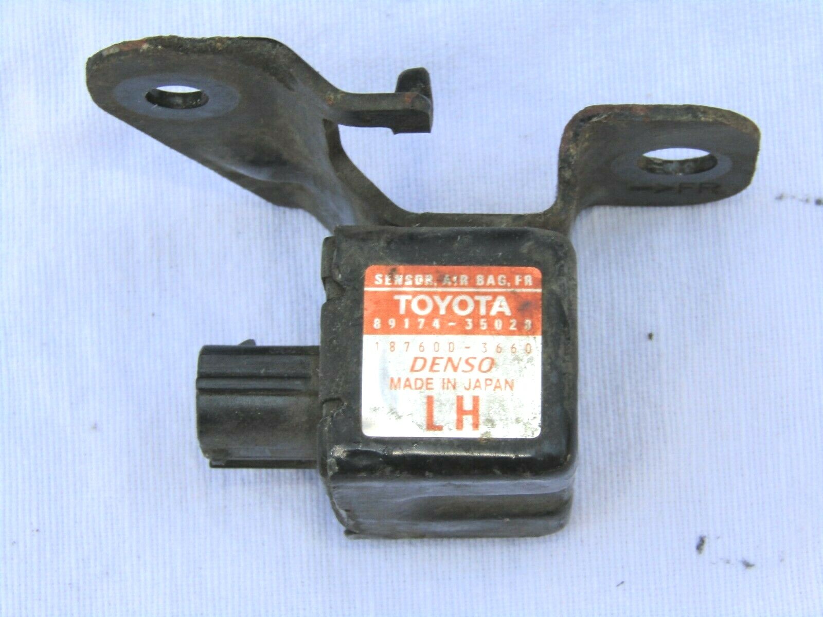

In the engine bay, you'll find an Air Bag Sensor that looks something like this:
There are two bolted to the frame above the wheels. One is hidden below the air box, the other just below the battery tray. Make sure those are also clean & connected.

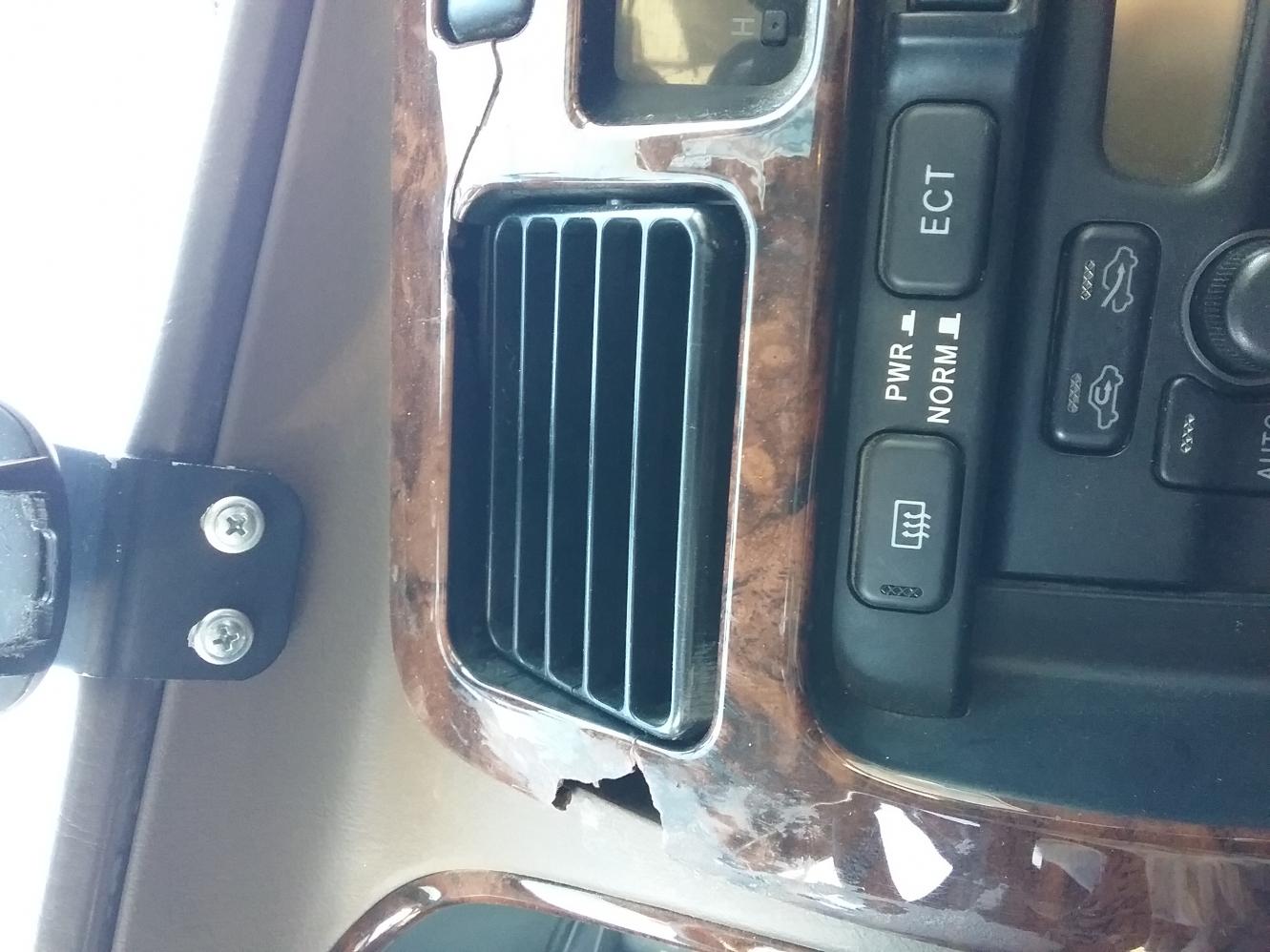

I removed and replaced 2 screws I use to keep my phone mount from bouncing. I'm wondering if I was lucky the first time I mounted but not so lucky when I adjusted the mounts screws yesterday. That is the only thing I can think of... see photo.i can't imagine wires run here...
No, they don't run there. From the passenger airbag, there's the connection I mentioned above and then they run down from there to the base of the center dash. If you remove the center dash bezel (not as hard as it looks but yours will probably disintegrate if you try) and remove the shifter trim bezel, you'll find the ABS Assembly module bolted on the bottom on the body, covered by a piece of clear but probably very dirty plastic. All air bags and sensors connect to this module:
