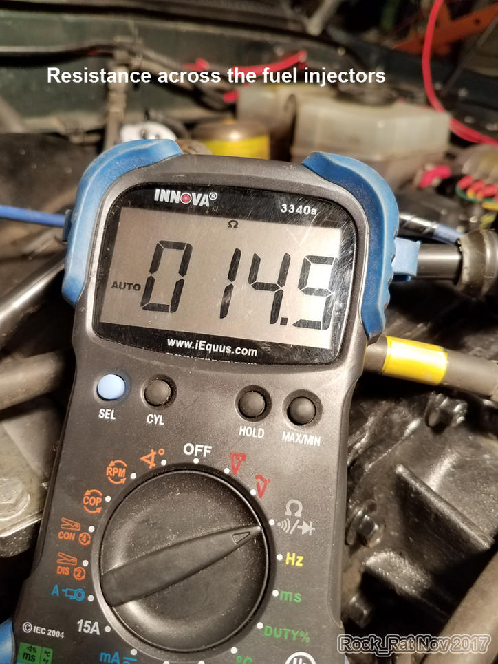

  • Time to check resistance on the injectors - all around 14 ohms

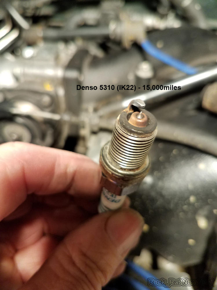

IK22 Plugs after 15,000 miles. I believe I gapped them to Toyota spec but I believe I should have left them at .032 right out of the box.

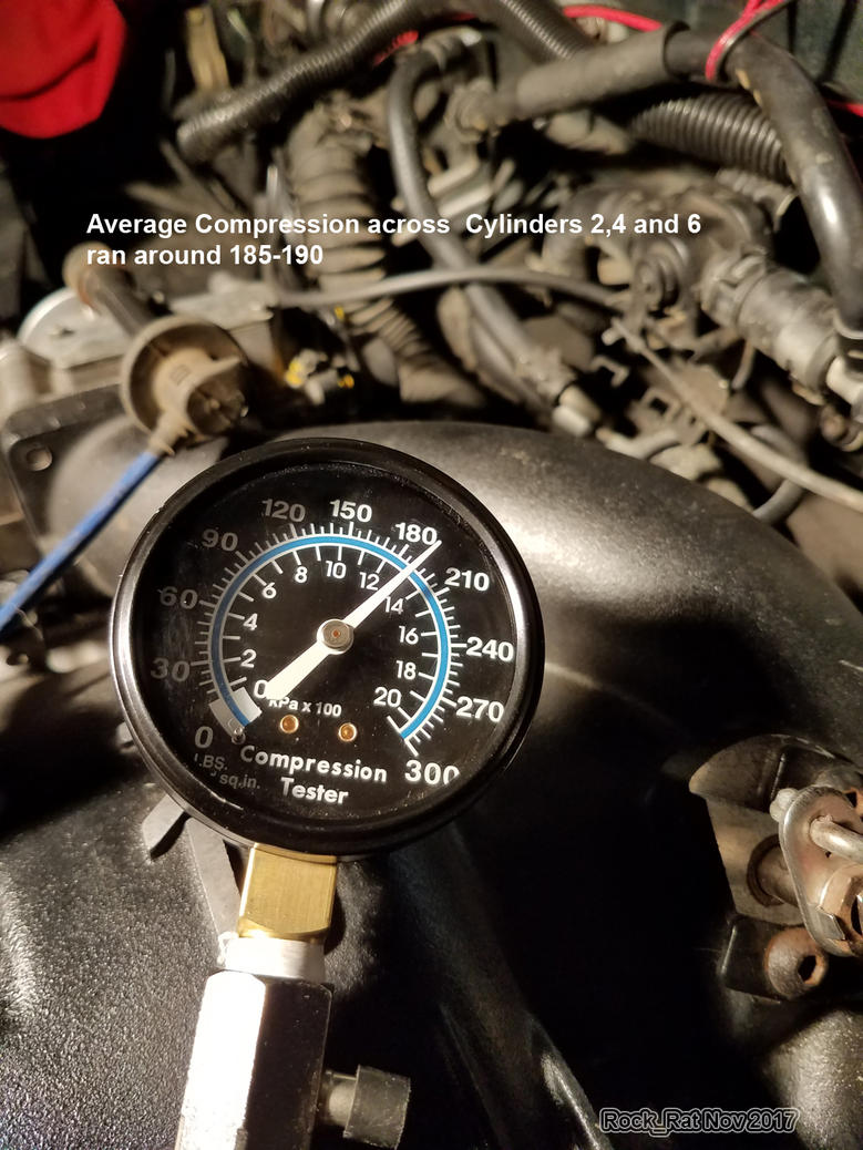

The drivers side numbers were pretty high at around 190 after eight cranks.

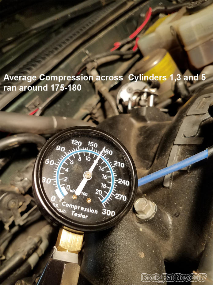

The passenger side, however were a little lower at around 175-185 after eight cranks.

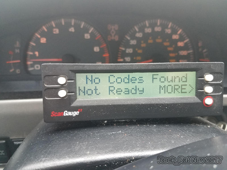

These injectors are from LCE and are flow tested equalized and only a few years old. The resistance was right where I expected.

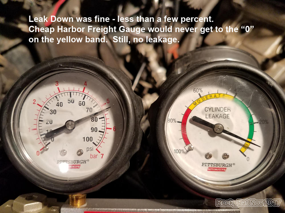

The final test I did was the leak-down test. I'm using a Harbor Freight gauge and the I couldn't get the indicator to go to "0" on the yellow band. Nonetheless, It never did leak or if it did it was an extremely small percentage. I was at TDC.

That is one healthy engine for that many miles. All engines leak a little, never seen one read 0%, but if your compression numbers are that healthy, I wouldn't worry too much about the internals.

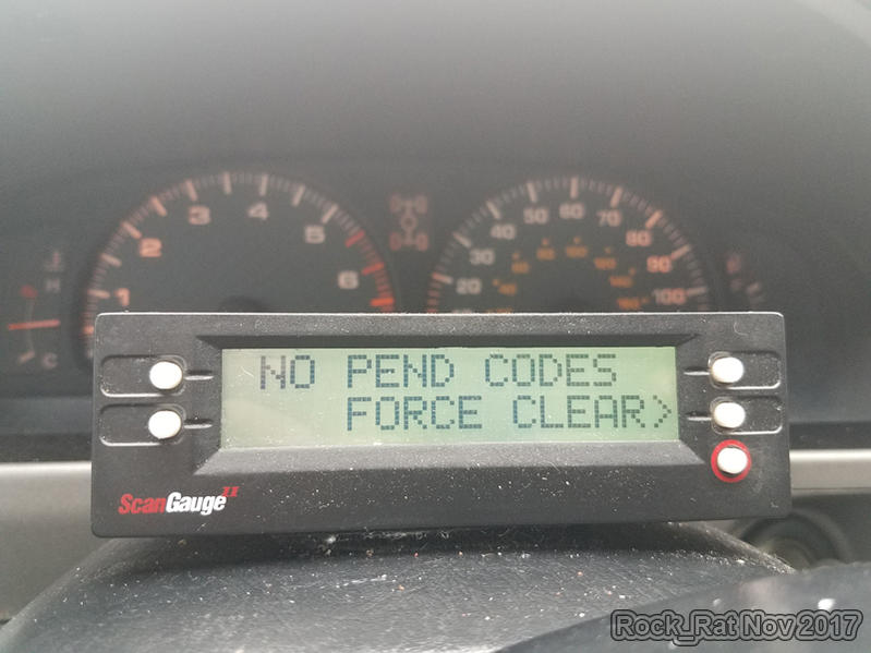

This morning I replaced all of the plugs and took it for a drive to run the temp up and put a load on it at various RPM's and no CEL or codes.
I shut it down and started it again and took it for another drive. No CEL light or codes.

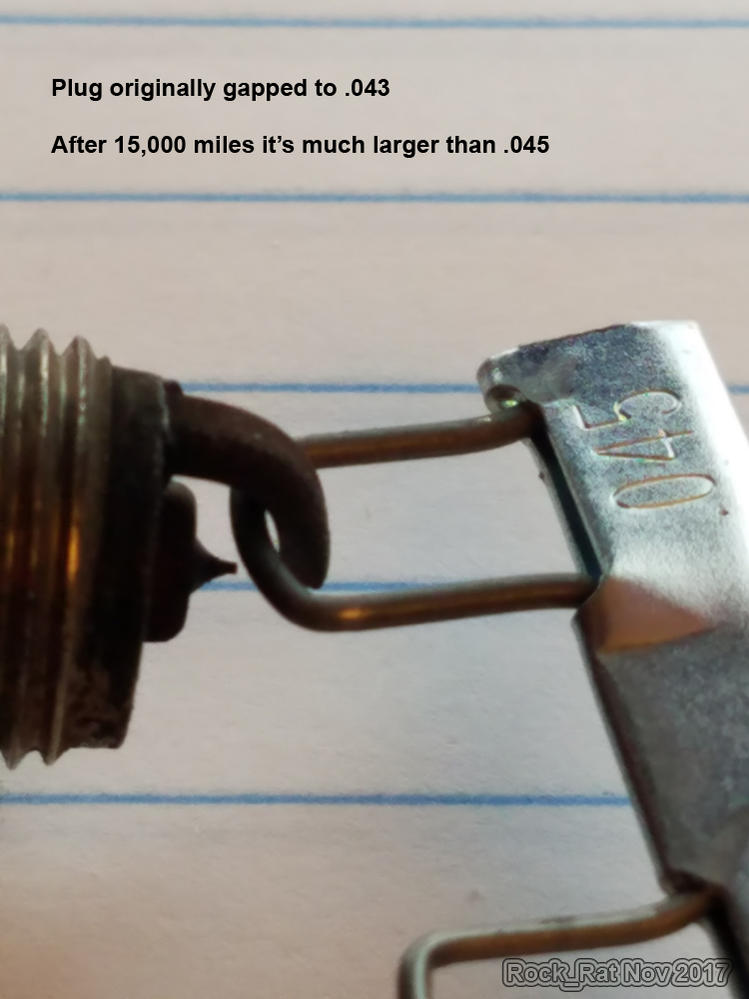

I decided to check the gap in the old plugs after 15,000 miles and much to my surprise, they were larger than .043 by a lot! My guess is they were close to .050. If I had any spark at all, it was insignificant. I decided to install the IK22's straight from the box at .032. I hope to get a nice clean combustion and little more life out of these plugs.

Look at the size of that gap after 15,000 miles. That's a .045 gauge in there with plenty of room leftover.

Nice to see, but it was only after 10 miles...
Even better after 30 miles
