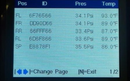

I need to check sensor data on wheels not installed on any vehicle, every so often. :suspicious:
This is my Autel display, from scanning my T4R 315 mhz sensors.
